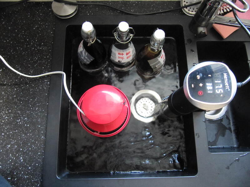

The point is that I am used to Paterson Super System 4 because they are easy to adapt for constant agitation. For BW and C41 I use the same setting, totally reproducible, like this:

well I was considering an old Ilford/Cibachrome roller (or make my own roller) but for C41, temperature is important. Easy when the tank stays all the time in a sink regulated by a sous-vide circulator, which is my setting. The Paterson Super System is good for that:
