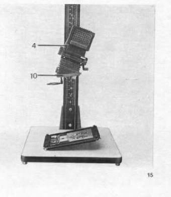

This enlarger configuration projects an image that is perfectly sharp on all 4 corners.
