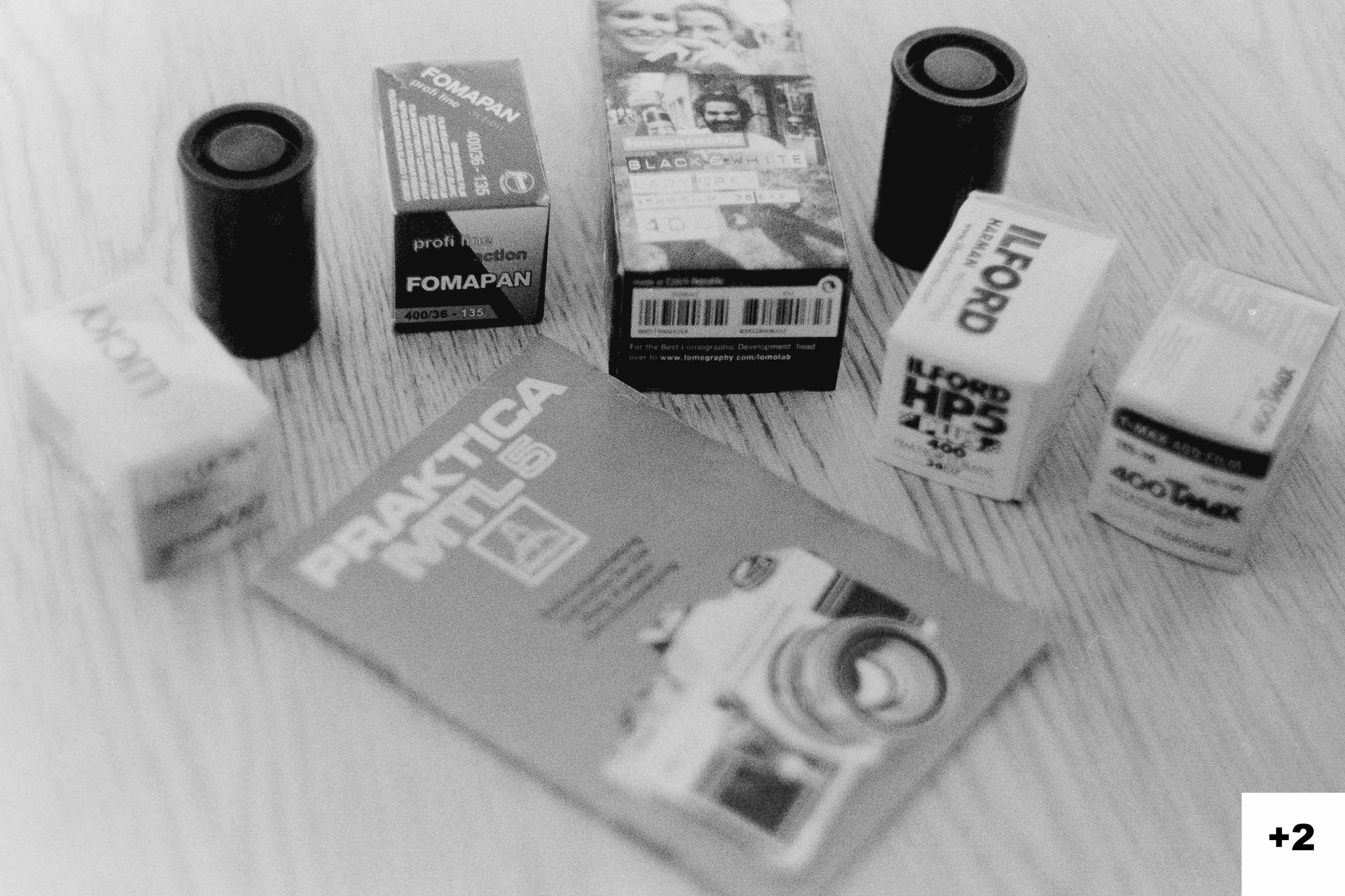

Here are a few shots using Foma 400, see what you think, at box speed, then -2 stops, + 2 stops (see bottom right corner of each photo).
Processing was Ilfosol 3, 1+14 for 12 mins @ 20C. Negs were photographed digitally and no corrections applied.
Why +2 has so deep shadows?
The problem with this test is that your scene dynamic range is probably 2-3 stops which is no problem to any film. Your highlights are fine in +2 because of this. Also "no corrections applied"; your camera is probably doing all kind of corrections ..
That 3rd image makes no sense. Lock off the exposure and rescan.
Something has been applied afterwards. Same for the 2nd.
