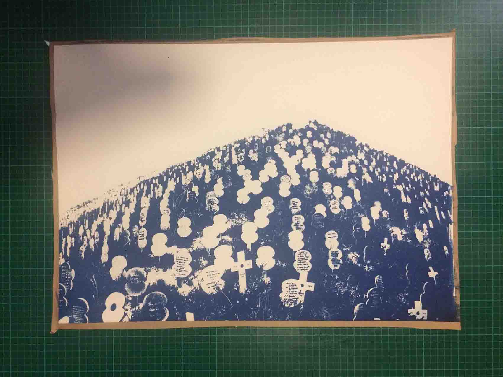

Unfortunately I don't have them with me at the moment. I do have a pictue of this one I made last week that was fine - this the same image I have been trying to duplicate this week . Try to Imagine the highlights of the background /sky stained yellow. Oddly, the highlights in the detail of the foreground don't stain as much as the sky / wash out much easier.

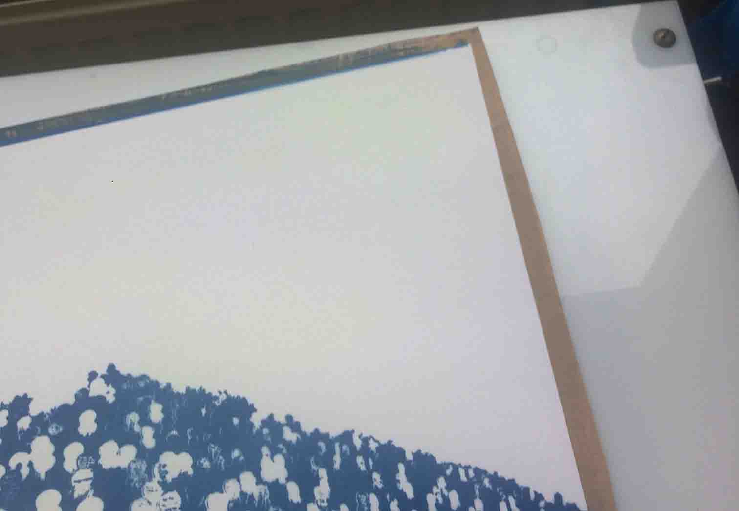

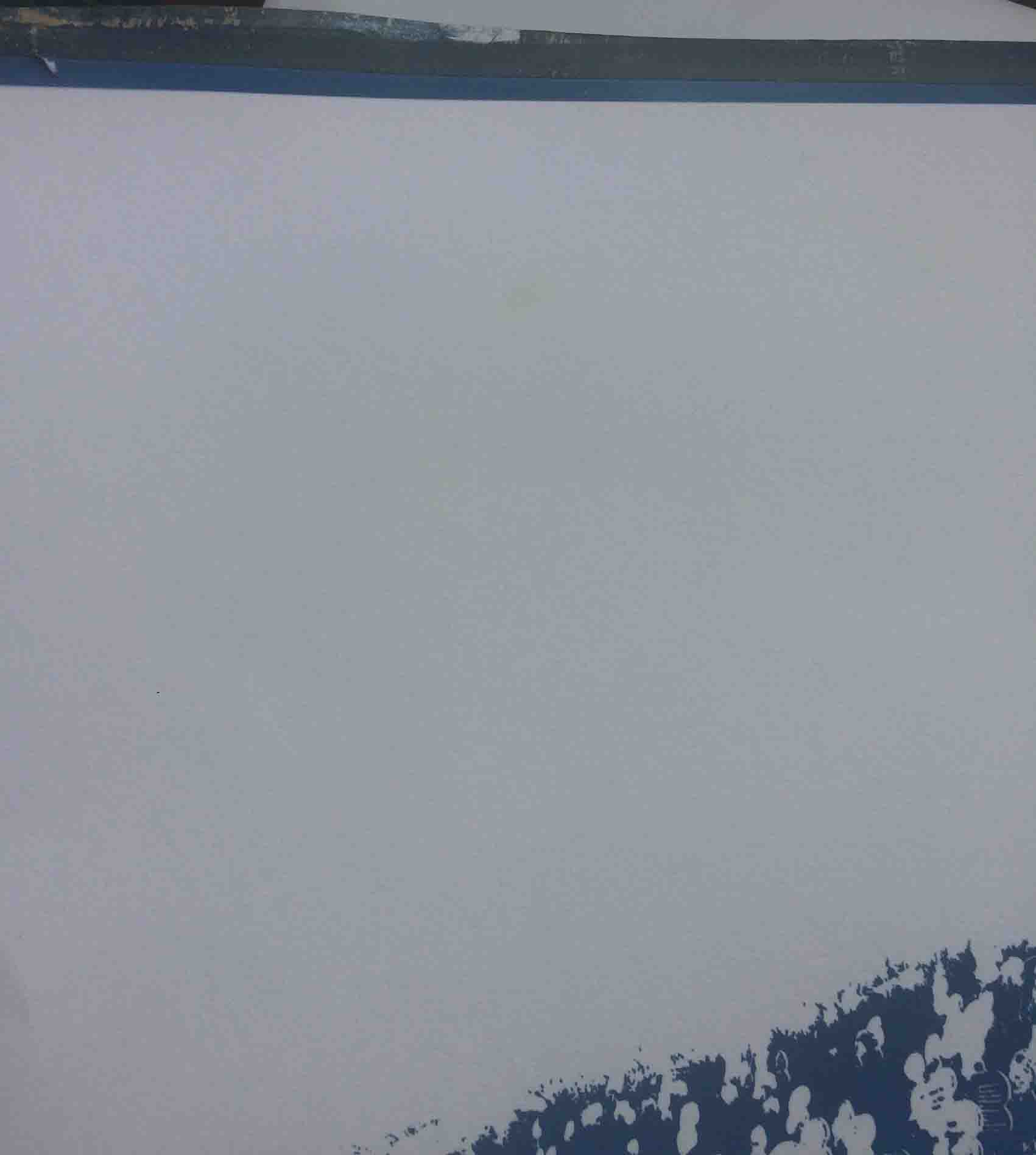

Here are a couple of images of the issue. Sorry for low quality, I can't upload high mb images.
