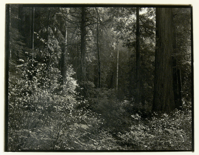

I only put a filter on if I need it...which is not all the time.
Edited to add -- actually this time a year I use the yellow filter the most -- popping out the yellow leaves under the rewoods. Such as in the image below.
