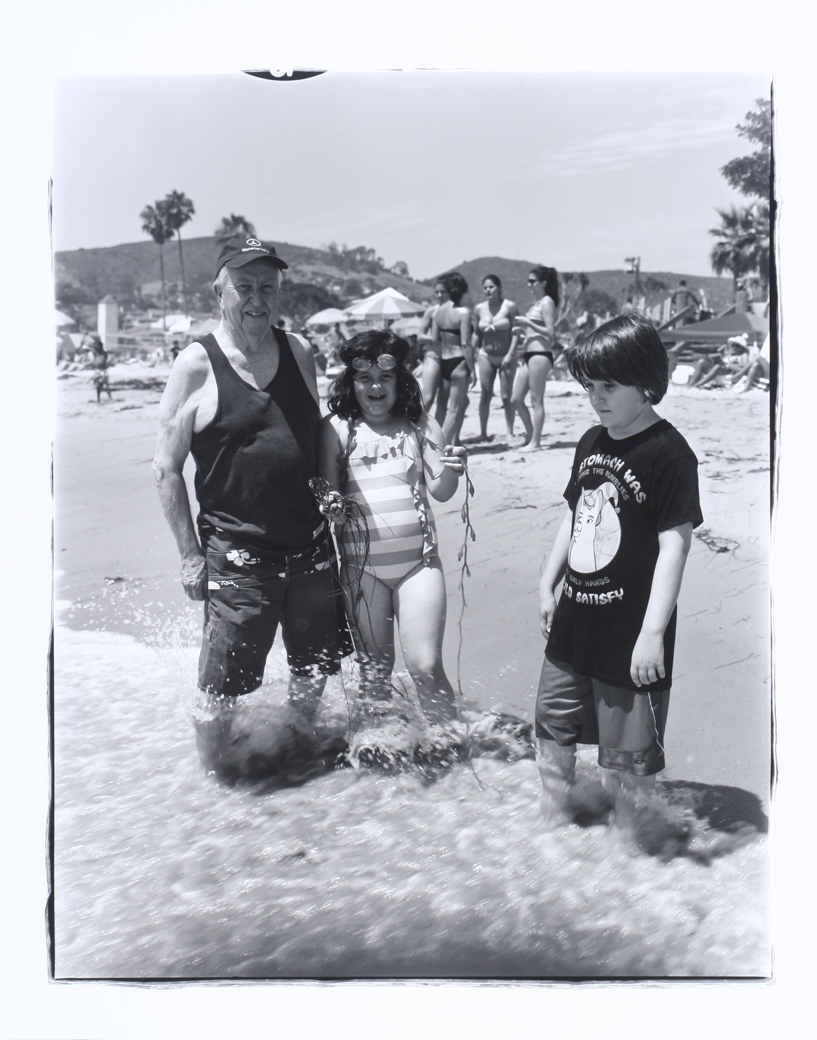

I have often made the claim that I don't "need" a yellow filter with TMY-2. Yes it is slight. If clouds are important, you would still want to use filters. But you can get away without it.
Here is an example photograph that led me to that conclusion. No filter. 1/300 f/16 The day I took the picture, I didn't even notice clouds in the sky. I expected blank white, and made no adjustments when printing. Galerie 2.
Dad and the twins, Laguna

Good example, Bill. I still recommend to shoot a roll of Tri-X with and without the filter, and a roll of TMY-2 with and without the filter, in rapid sequence in the same conditions. That will tell the OP more than anything we can tell 'horacekenneth' here.

And thanks Bill, that photo is helpful to put things in perspective.
