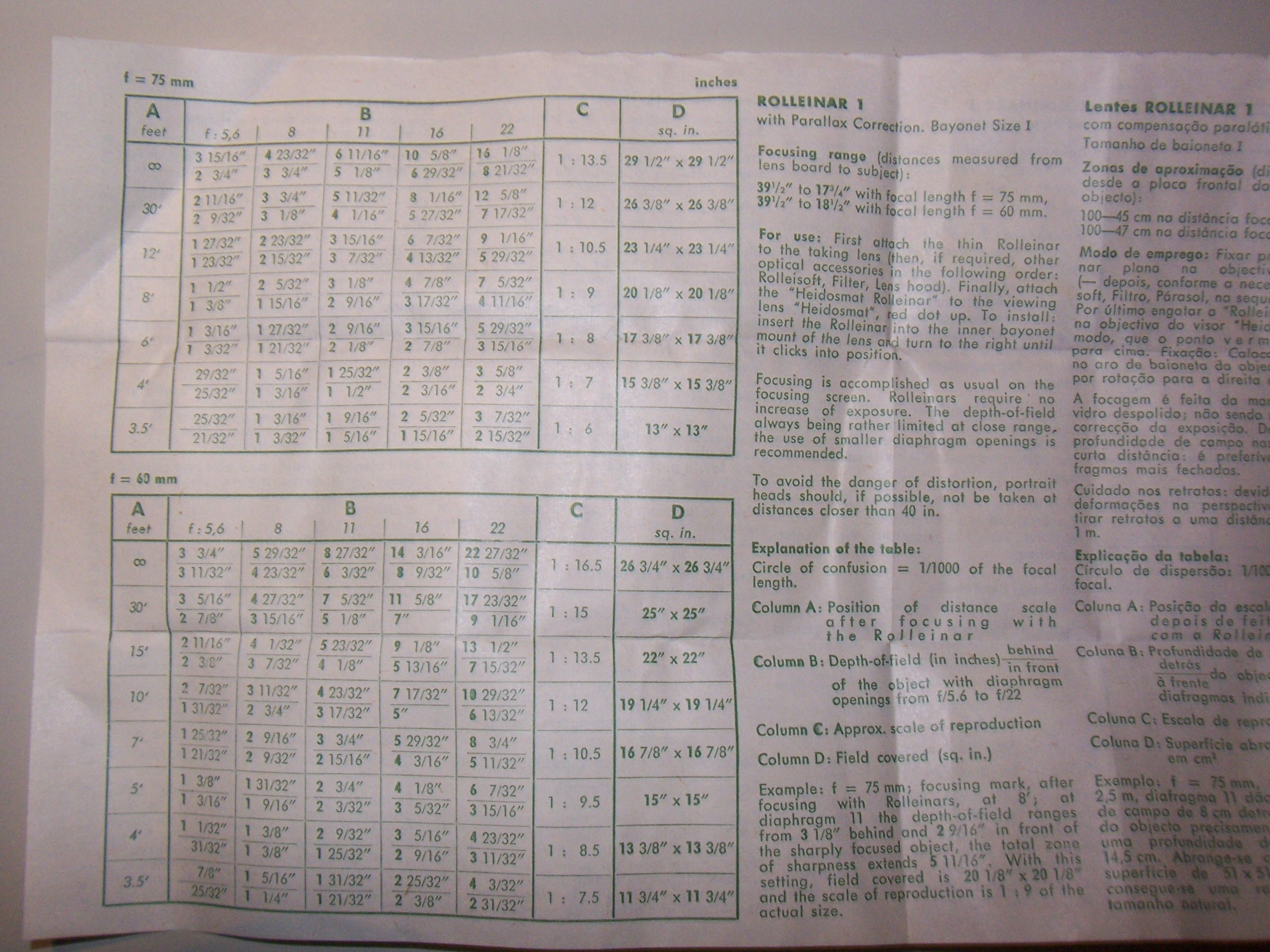

here's the directions....
and voila
oh...the older rolleinars are in 3 peices...2 identical closeup lenses and a parallax correcting prism...the newer ones have the prism incorporated in the viewing closeup lens...the parallax corrector cannot go on first as there's no bayonet on the end of it

That's fantastic and thank you so much for the instructions. I don't mind experimenting but having the information to hand "up front" saves a lot of wated time, effort and film.
