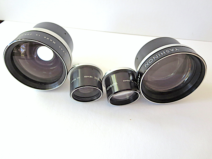

The Yashinon WA adapter is pretty nice. Certainly it is not a 50mm Distagon, but there is really no alternative. Unlike the Telephoto accessory which duplicates a simple crop in the darkroom, there is no alternative to a wide lens. You can't just "step back a few feet" because any change in subject distance changes perspective.
Of course the vignette on the corners is part of the aesthetic.
