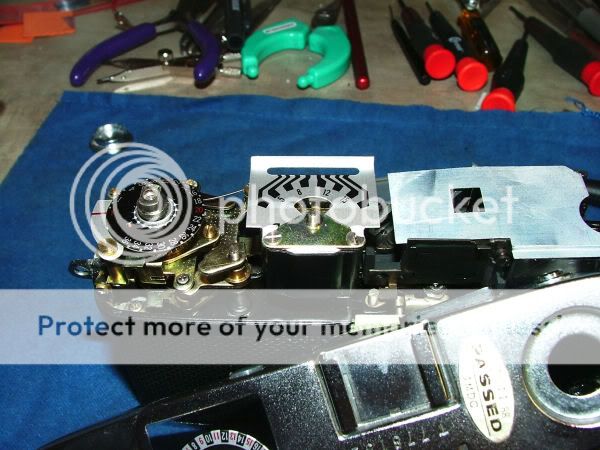

Yashica Minister D Shutter
My shutter is stuck closed on my 99 cent Yashica Minister D. Must I take lenses off to get at the shutter?
Yes you must. If you take the front lens element out, you can apply a small amount of ronsonol (lighter fluid) to the now exposed blades of the shutter. In a large number of cases this will immediately free up the shutter. Keep winding and firing the shutter as the fluid evaporates. It works best when you have a can of air, which you can use to help dry things out. Once there is no visible wetness, set the shutter to B to hold it open and gently clean the now exposed front of the rear lens element (opening the aperture fully) with a cotton bud (Q-tip) as there will probably be a film on it from the shutter cleaning. I usually just breathe on the lens and gently wipe. Set the camera on its film door and let the lighter fluid evaporate for a day or two WITHOUT the front lens element installed. This works for me in almost every case, although it's possible that you may need to do this a couple of times before the effect is permanent. I have had no adverse effects using this method, which I have used on rangefinders, TLR's, folders. etc.
If this method has no effect, then there is probably a more serious mechanical problem which would require more in depth surgery.
Hope this helps...
