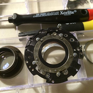

Usually it's this white metal ring collected grime and does not rotate freely.

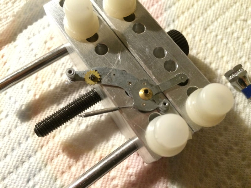

The picture below shows disassembled self timer with patina traces on the base and on the main timer spring.
(I swear I have never seen that darn dog's hair before! Yuck!)

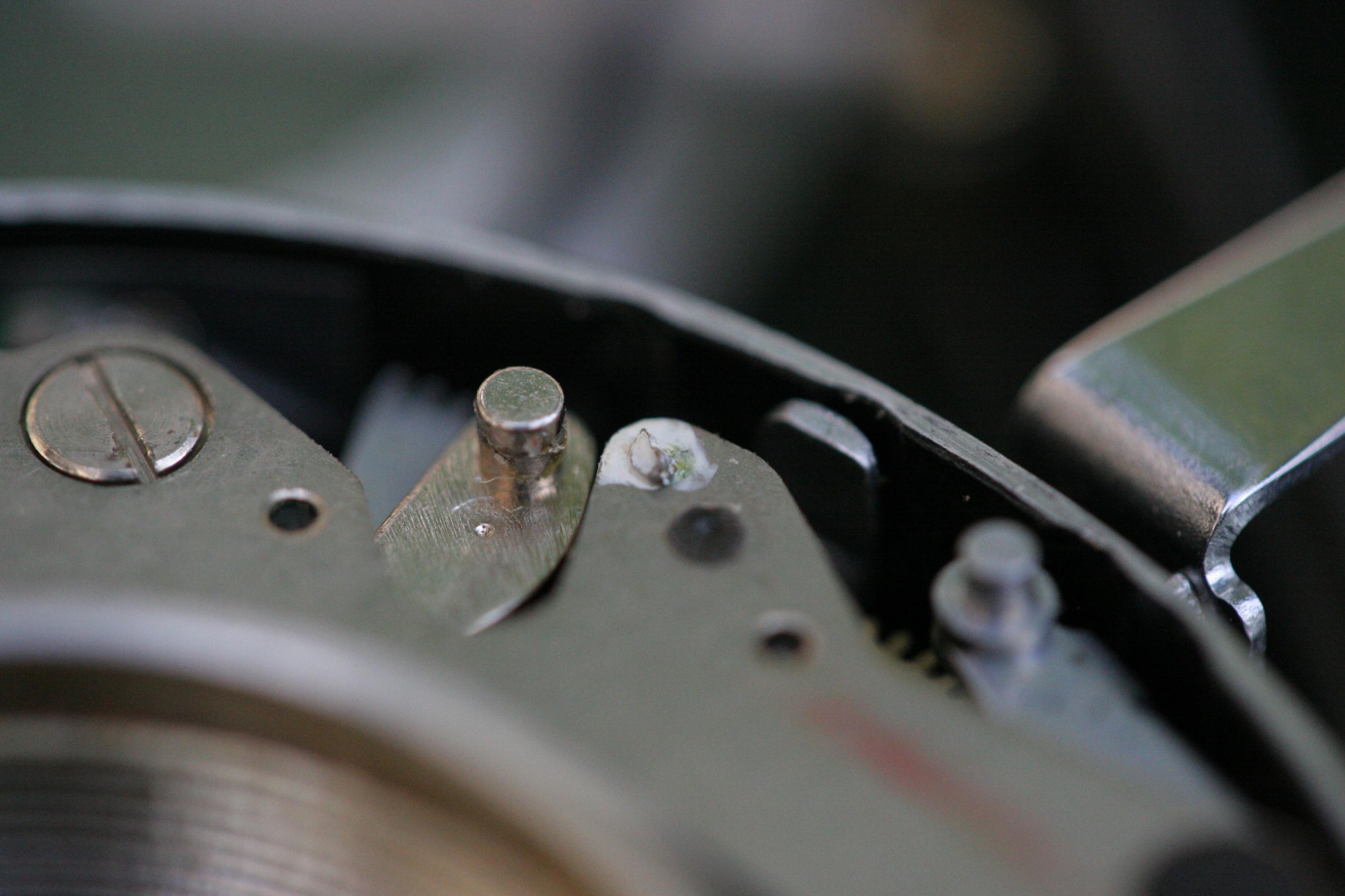

Interesting you mention "powder white". I had noticed a screw area of the shutter had white on it, while another compor mvx I have doesnt, but I wrote it off thinking thats probably the way it is. But now that you said magnesium develops a white powder Im thinking maybe thats it??!
Here is a close of photo....what do you think?? If so how should I procede, do I need to dismantle the whole shutter or at least this part of it?

shutterfinger
Feb 25, 2013
5,020
San Jose, Ca.
The only way to clean a shutter is to disassemble it. If the part is magnesium or a magnesium alloy then brushing it clean with a brass bristle brush or similar is in order.
Many screws in shutters are secured with glyptal. To dissolve it apply some acetone (nail polish remover) with a cotton swab and allow to sit for a few minutes.
Yes, a partial to full disassembly is in order.
