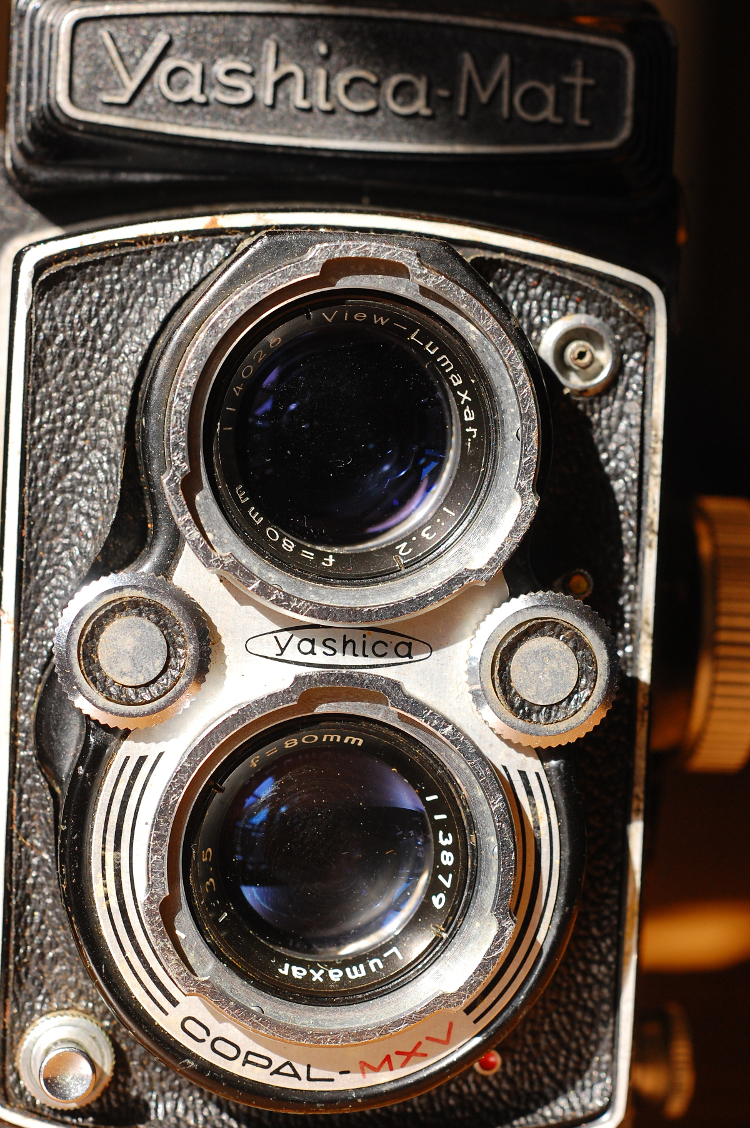

I got it for free so I cant complain. I have been to yashicatlr.com but Im still having trouble. That site is quite extensive. Can someone tell me exactly what I have here?
Copal MXV 5 blade with self timer, B,1,2,5,10,25,50,100,250,500
taking lens Lumaxar 3.2 80mm
viewing lens Lumaxar 3.5 80mm
Focus scale in feet only
film counter with no red window.
Bayonet 1 filter mount

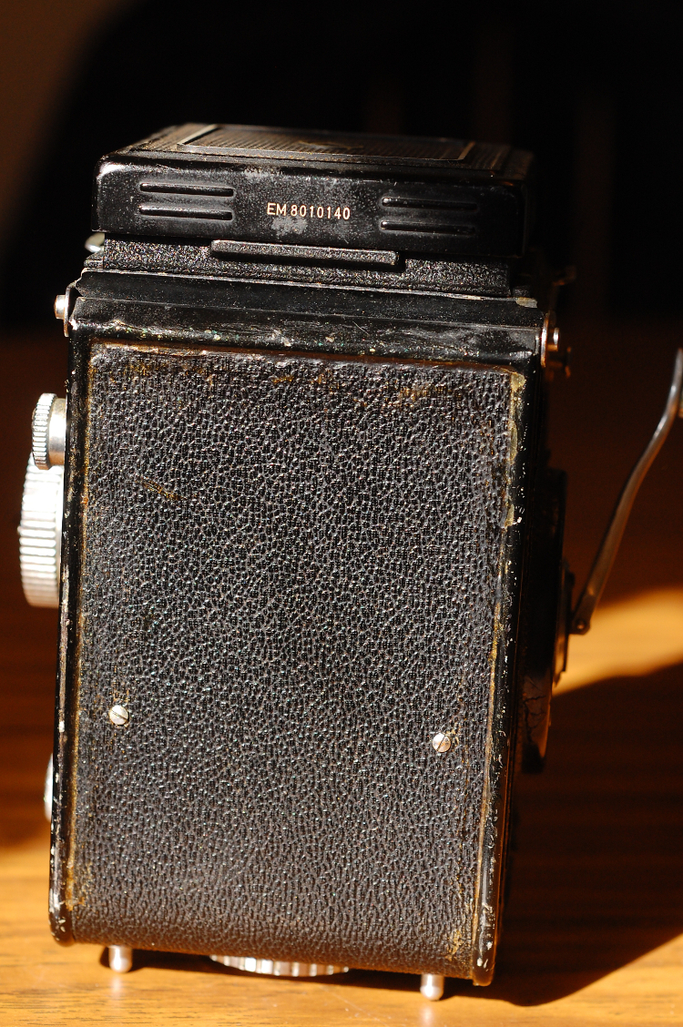

The serial number starts with EM but it is not an EM. Thats the part I dont get. The number decodes to Jan 1968 from what I learned on yashicatlr but that cant be right because it has the early Lumaxar lenses.

thanks Kino what is the difference between the Yashica-Mat M and a Yashica-Mat. No place on the camera does it say Yashica-Mat M. I see the box but I do not see any listing or reference to it on yashicatlr.com and in th butkus book it shows a different logo on the top viewfinder thingamabob. and if you look on the serial number i starts with an EM. But it cant be an EM becaus on the EM it says in big giant letters on the front of te camera EM. So Im still not sure what model this is. The shutter works on the the fast speeds but not on the slow ones. I tried to run some tst roll 120 through it but it doesnt want to go. winds and firres fine without spools in it though.

Hi 68Degrees,
You actually do have a YashicaMat. There never was a Yashica Mat M - that was a perfectly understandable transliteration error on Mr. Butkus' part with the manuals. If you look at the cover of the "How To Use..." uploaded to the Butkus site, you'll see how the confusion kicked in:
The YashicaMat:
The Yashica D:
At no time is the camera ever referred to as a YashicaMat M in that manual or another one I have labelled as the YashicaMat 66.
Regarding the serial numbers, you're actually looking at the wrong one. Your waist level finder has been replaced by one belonging to an EM and that serial number you referenced came from there. The YashicaMat's serial number is on the body of the camera the front directly above the faceplate. See highlighted image below. Red for the correct serial number, blue for the flip up waist level finder which is a replacement part from a different camera.
I can't quite make out if it's 73 or 75 as the start of your numbers, but mine is in the 76XXXX bracket which puts it around 1958. My lenses are Lumaxars as well, but the serial numbers make mine a bit younger: 82XXX rather than the 111,XXX lenses you have.

Having opened up too many YashicaMats, what I see more than anything is all the leatherette peeling up along the edges!! Wonderful!! Later, Yashica used a material that turned into a hard concrete as it aged, making removal for getting inside the camera the hardest and longest part of any repair. You are very lucky. Most of that material will pop off easily. Throw it out and buy new coverings.
Molli has it right- the focus hood was swapped. That's why you have two body serial numbers. It also has two different coverings- pebbled on most of the body, crosshatched on the top. No problems- same basic part.
As to what is wrong and what can be done- well, depending on the condition of the lens, it might be worth opening up. If you can run a roll thorugh, go for it and see what happenes to evaluate the potential.

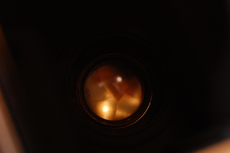

so far what I can see is that the shutter is slow and slow speeds just dont go at all. seems to focus fine and smooth, viewfinder is clear enough. The crank is quiet whithout a spool, but with a spool it sounds quite noisy like a pepper grinder. After that I read that you shouldnt wind it with just a top spool. then I tried putting film in it and it did not seem to crank but I didnt follow any film loading instructions just went by feeel. So there may not be anything wrong with the film transport . It was noisy though. I dont know if thats normal for this camera. Last time it was services was in Jan of 1970. So its due.

Pull the lens shroud only Remove the front lens group. Open shutter, do some naphtha cleaning. Close it back up and give it a run.
The grinding noise is the plastic reel with notches running over the thin silver gear in the top film chamber, left side. Put a few wraps of masking tape around the spool where the gear runs and it will quiet down.
All in all if you don't need to go into the side or deal with focusing, for the best. get the shutter working and run a test roll before you do more.
