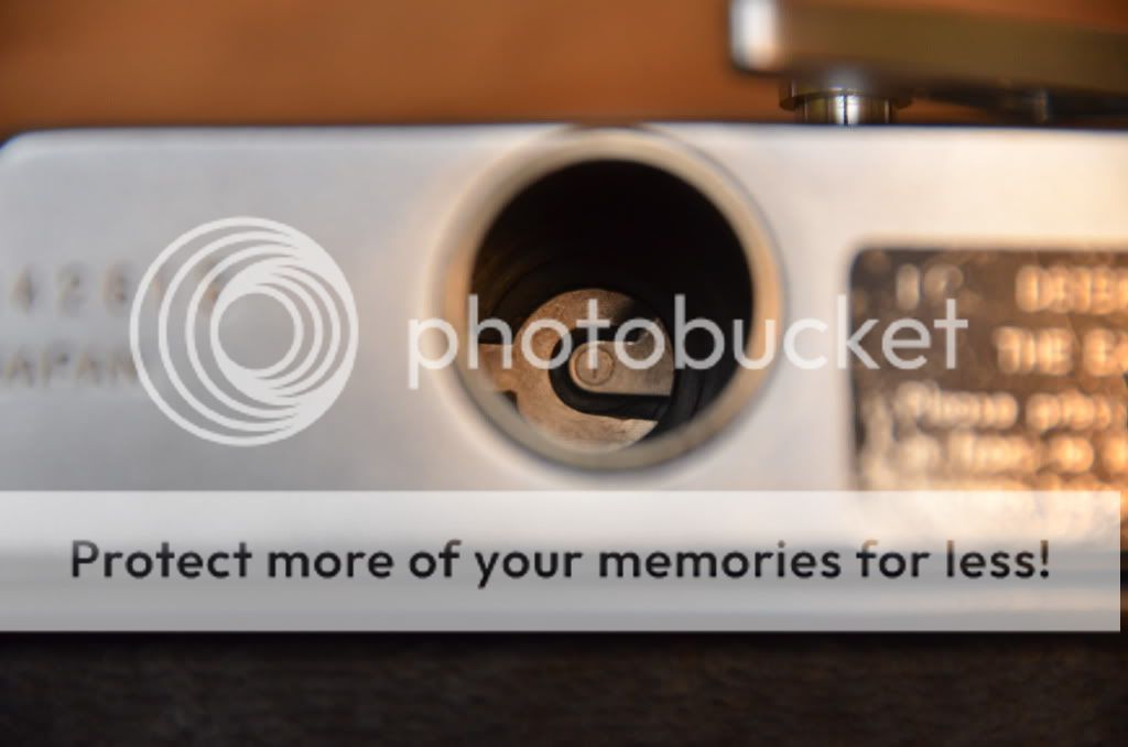

While I was cleaning my office/camera room/computer central room, I found a wonderful Lynx 14e that I remember getting around a year or so ago. It is in very, very good condition except no battery cover.
I realize this is a much different cover than the other Lynx models except for the 5000e, so can somebody take good pictures of a battery cap for one of these cameras? I can't seem to find any of the caps anywhere. I figure I will have to make one or figure something out........

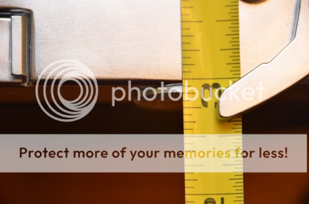

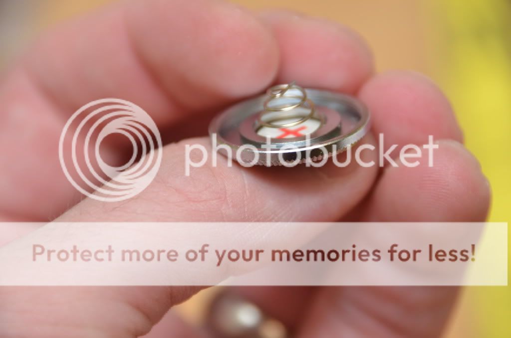

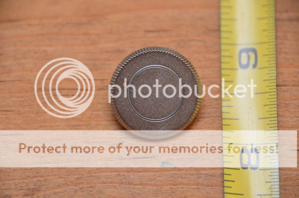

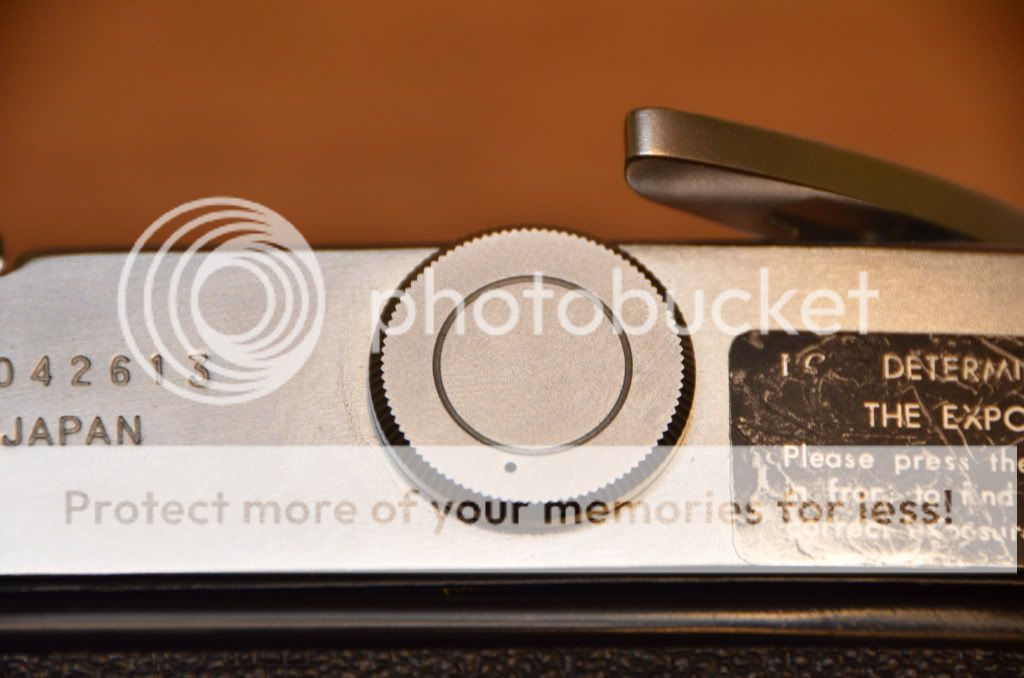

zsas
May 12, 2011
1,955
Chicago, IL
Bob - I hope this helps???

It does help except I need to ask you a question first. According to my communications with Mark Hama, when you have the sticker in the battery compartment that shows the + side goes to the outside, I need a black battery cap. I would have said since you have the chrome cap that you have the opposite, but I noticed the bottom of your battery compartment has a minus sign so I assume and I just checked mine....minus in the bottom, positive battery out. Please confirm you have minus battery inside, and positive battery out.
I also got the high powered flashlight out and saw the super fine threads that you screw the cap into on the camera.......no wonder they get stuck....

Yes Bob, tis true, the positive side of the battery faces us when the cap is removed. The negative part of the battery faces towards the lens side of the camera. I will PM you re what camera/lens I used, as I used digital and I want to keep Apug free of those matters. Best, Andy
