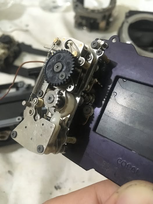

I'm trying to adjust the shutter speeds of this FX-3 but I can't get the shutter to fire at the correct speeds. I managed to get it right using the adjustment spring for low speeds right below the black gear but the shutter doesn't work with speeds of 1/1, 1/2 and 1/4 s because the spring tension is too low. Putting more tension in the spring leads to a constant underexposing of 1 stop in all speeds.
The shutter has been cleaned with a solvent wash. Lubrification of the mechanism doesn't seemed to solve the problem
Does anyone have experience working with this shutter? It's practically the same shutter used in the Nikon FM2

How are you measuring the shutter speed? Are your curtain travel times OK. Should be about 5ms.
If everything else all checks out then, indeed, "...such defect as a second being over and 1/125 being under cannot be repaired. FX-3 Service manual"

I'm using my phone camera that can record a video of 240 fps. Then I go frame by frame to measure the exposure time. It's fine for speeds up to 1/250s.
Last time I checked the curtain time travel was about 3 ms. But I couldn't find any information about a specific value in the repair manual.
Anyway, I noticed that the I forgot to oil the pivot point of the slow escapement gears. After that speeds seemed to have lowered. 1/30 now reads 1/40 instead of 1/60. Going to do a few more tests.

I've worked on a lot of those but I've never seen what you're describing. They're normally pretty solid. I would question what's caused it to be wrong. Has it (or the camera) been exposed to excessive wet or been stored badly? I've never known the slow speeds to not work. The shutters don't usually need lubricating. This might help https://contax139.blogspot.com/2025/01/contax-s2-shutter-adjustment.html

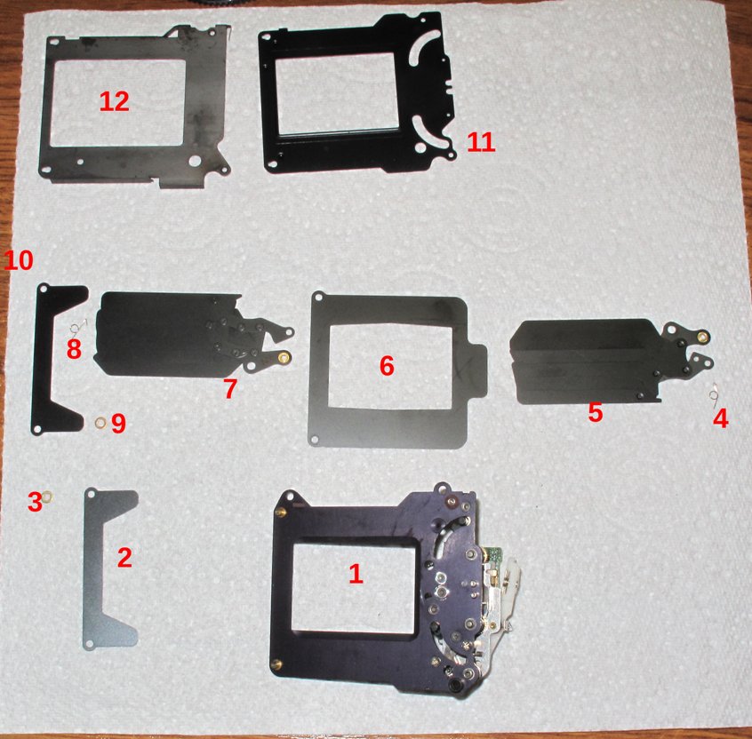

Why did you dismantle the blades? What was wrong with the shutter in the beginning? Are you sure you got the spacers between the blades back in the correct places also the washers between the front and back frame? The positioning is critical. Picture attached of the order everything has to go back.
There was nothing wrong with the shutter, but since it's a 40 years old camera, I figured it wouldn't hurt to get a complete CLA.
Hm, I think I got the brass washers in the wrong position. I took photos of everything but since the washers fell off when I started disassembling the curtains I couldn't figured it out where they go. It's curious that my shutter only has 2 washers, and the other shutter from another FX3 I got in my hands has 4.

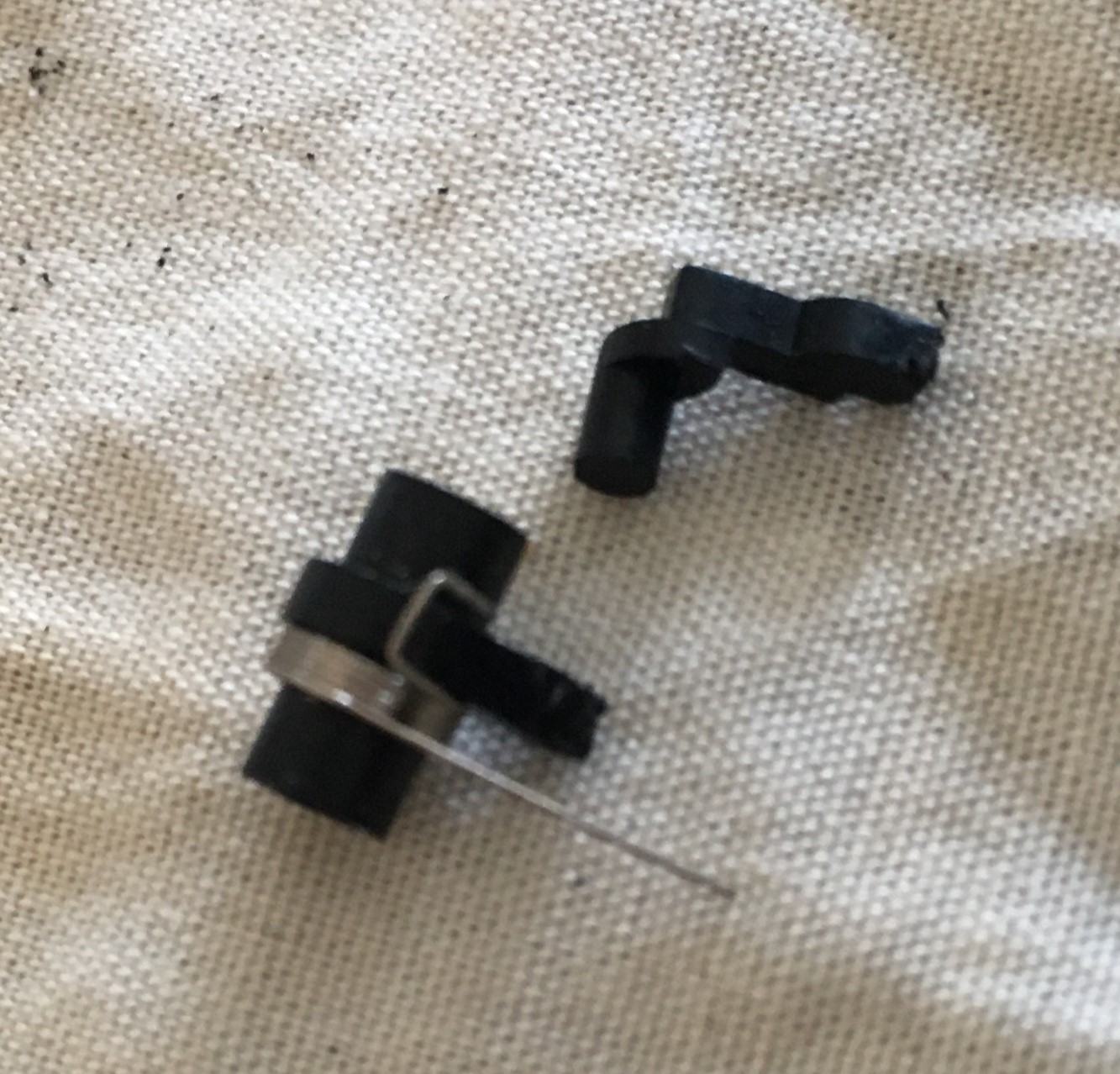

The weakest part of the camera is a plastic lever on the bottom of the mirror box. My first FX-3 came with it this way. Now I always try to reinforce it with some epoxy putty whatever I get one in my hands.

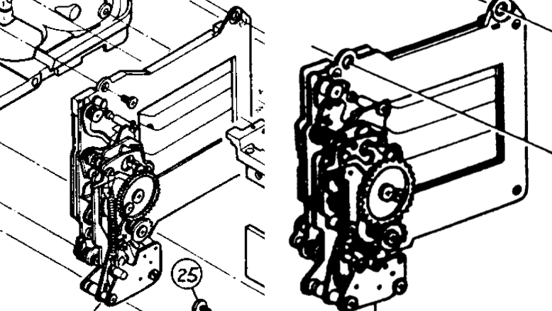

Yes, I forgot, I think it was Kenko, not Cosina, that made the fx-3.
Anyway, I think the shutters are very similar (FM-10 vs FX-3). But I can gladly say I only have these images and have never needed to take the shutter out of any of them.
(FX-3 and FM-10 diagrams from respective assembly manuals).

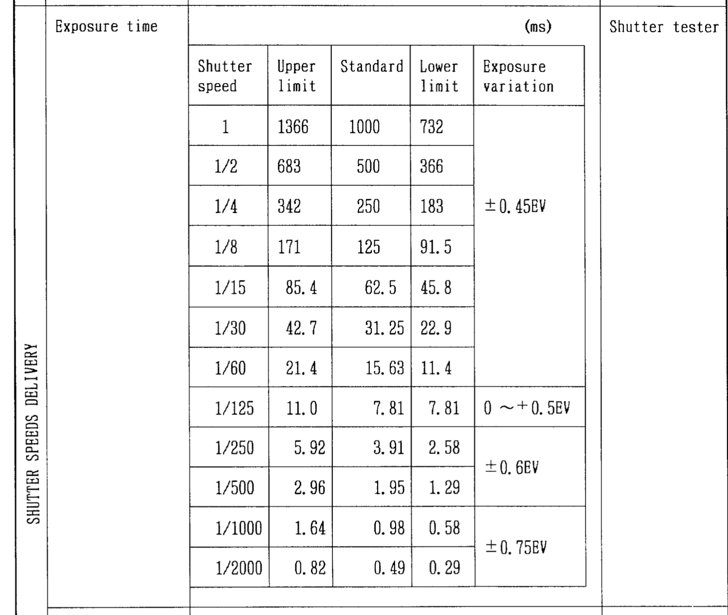

Anyway, back on topic, since the shutters may be simlar, this chart is for the FM-10 and may also apply to the FX-3:

Also, if the OP does not know, the shutter travel times I found here, but since it is a common shutter, there may be more info out there (that I have not discovered yet).
