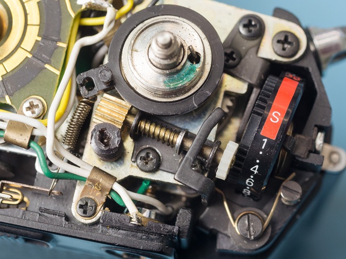

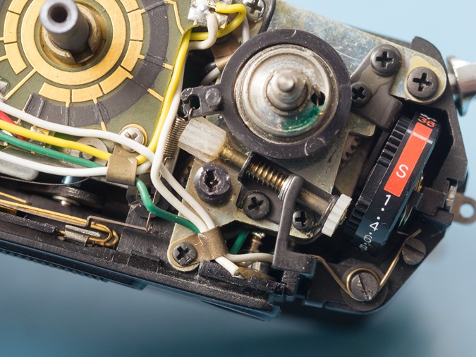

All the FR series have the same problem. I have an FR, FR I and FR II and the frame counter is broken on all of them. :smile:

And what is the fault in detail? (I have not yet opened my sample. But I might consider exchanging a part in advance.)

There's a plastic worm gear that splits and wont turn the spindle it should be tightly fixed to.

A wormgear, that does not seem an easy replacement/fix.
Ronnie
That makes sense because the counter does turn, but not consistently. A 36 exp film will finish on frame 18-24, so something's not catching properly.
