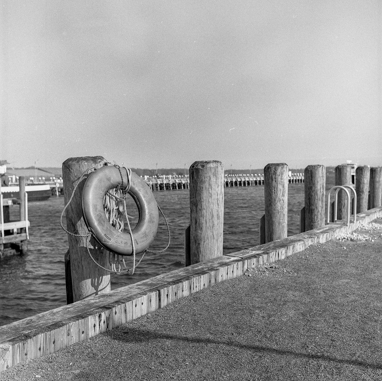

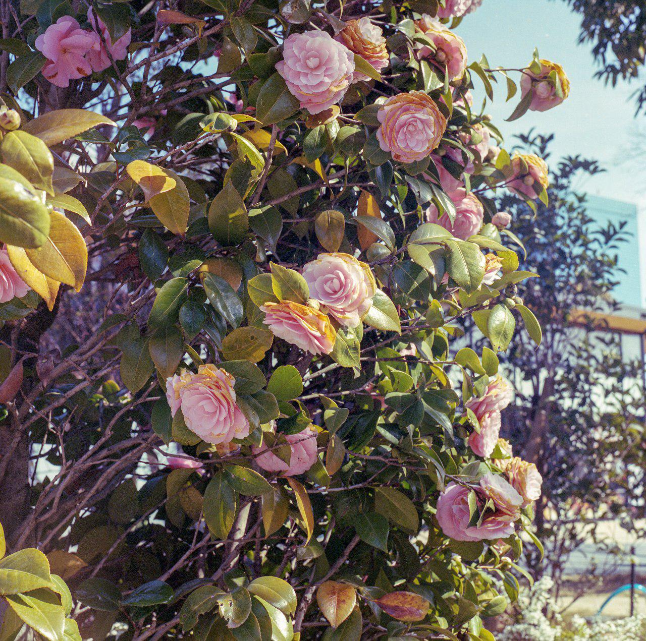

My friend started scanning some photos from a Yashica EM and they look a bit off. The density at the left and right of the images kind of looks like some internal reflections. I know that Yashica TLRs are known to have this issue, but I was thinking it might be a good idea to get some more opinions before we try to mess around with flocking.
It is a bit hard to say, because I made a tiiiiiiny mistake while processing the B/W photos (Accidentally poured in D76 stock instead of fixer... Thankfully noticed it and dumped it before too long). Though I'm also seeing something similar on C-41 negatives as well, so I'm inclined to blame the camera instead of processing. I realize though that there are quite a few variables going on.
In case anyone is interested, the color photo was Portra 400 (slightly expired) and the B/W are FP4+.

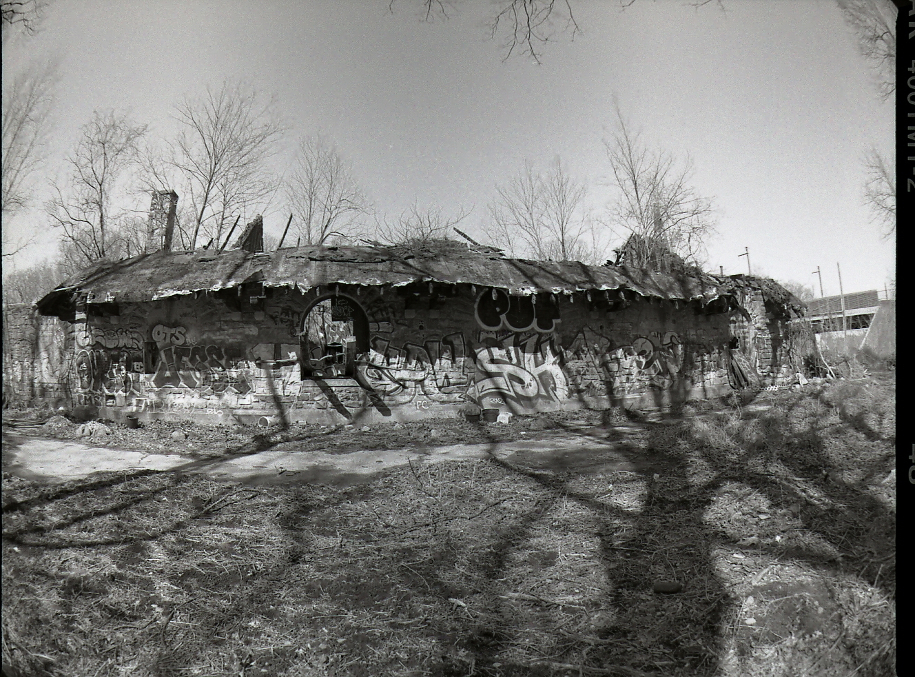

The B&W edge issue is standard agitation problem on 120 film. You are not getting enough fresh developer over the center of the film. That's a whole other topic, how people agitate film, but that's your problem. (You also have a scratch running the right side of the B&W- run a cotton swab around your film path to see if there's a paint edge or such.)
The color image appears to be some side lighting? Open shade allows for all sorts of light effects. Even your shirt color would be affecting things in such an image. Do you have a lens hood?
Yes, the YashicaMats have internal reflection issues. I've used telescope flocking to cut it down effectively. But from the shots above your problems lie mainly elsewhere.

the light bars on tge sides may be the scanners light source. i get this when scaning on my epson... the tube is a U shape.

Because of the little mistake with D76 I can't really say whether the B/W issue is processing or not because it certainly did not receive 'normal' processing. The line actually seems to be a scanner calibration issue, as it shows up on other formats in the same way. Probably some dust in the calibration area.
We always use lens hoods. I've been trying to convince him to try the flocking...

It looks like an agitation issue. Is this a standard hand-held tank inverted for agitation?
Metal handheld Kindermann tank. I don't think it's agitation because this is another shot off the same roll, with none of the inconsistencies above. I'm inclined to say it was either the atmosphere or reflections at this point.
When I'm processing normally, I'll do 2 inversions a minute for Rodinal 1+50 at 20C. I've found that stuff to be very sensitive to overagitation, but I might try doing a bit more the next time around...
