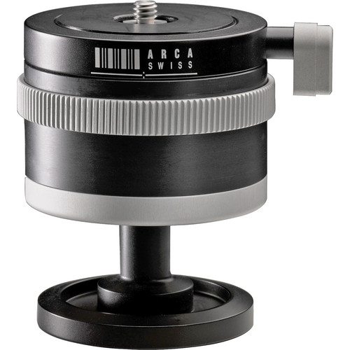

Hi,
What's a good head for the Yashica D with it's tripod mount and door knob combination.
How about the Arca Swiss P0 without a plate?

Yes, I think, if it is anything like the124g, it would be prudent to not clamp the 4 feet on the camera bottom against the tripod head.
Jul 24, 2004
109
Red Deer, AB
I have mounted my 124G and Yashica 12 onto heads using Arca Swiss style plates, but as ic-racer mentioned be careful of damaging the base(back) as the four feet are on a different level than the tripod thread. I use washers as spacers to match the height. It's bit of a pain, but works.

Yes, that's the pain I don't want. It's either get a C220 or the Arca Swiss p0.

I don't have a Yashica D but it's the same as most Yashica TLRs and many TLRs. The feet stick down a little. Either use a tripod with a small head, or use a tripod with a larger head and a soft surface like a rubber pad and tighten down the tripod screw just enough to hold the camera. Don't tighten it with a strongman's torque or you might distort the bottom plate. Abusing them is probably the origin of the idea that TLRs are subject to damage there.
Even a Bogen/Manfrotto hex quick release plate will fit in between the feet, so there is no need to buy a special expensive tripod head for an inexpensive TLR, but do that if it makes you happy or reassured.
