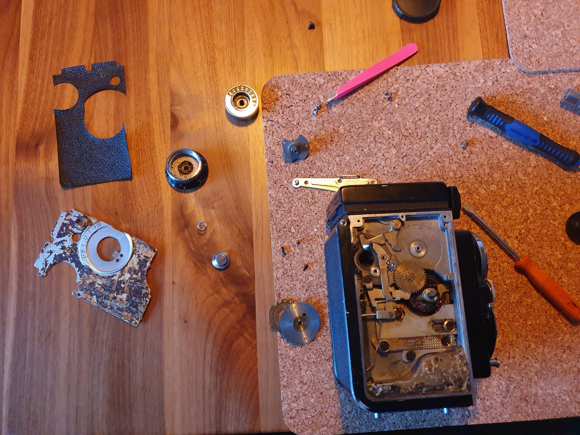

I couldn't wait anymore and opened the Yashica up.

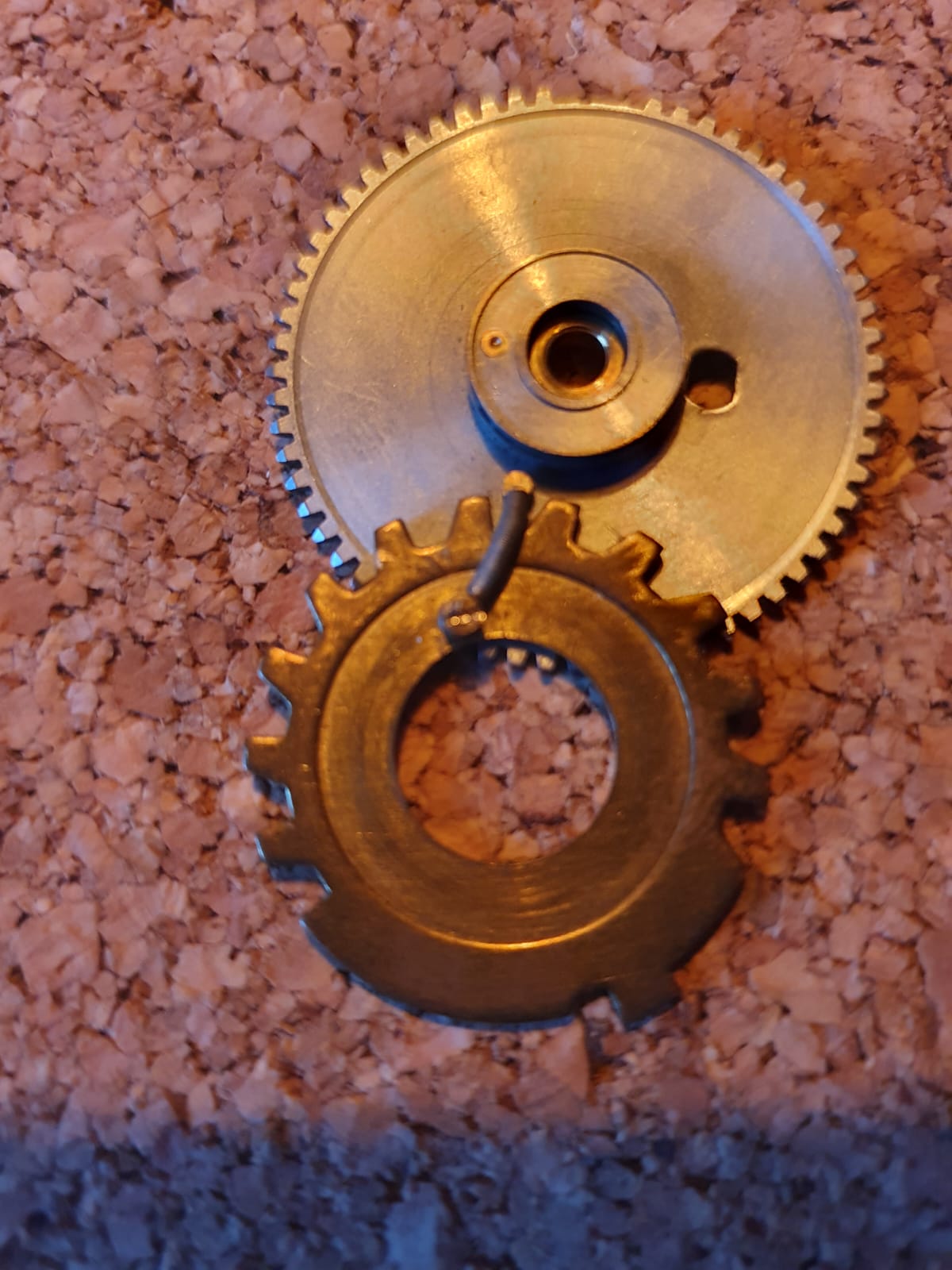

I managed to find the culprit, it was a small spring which was disattached from the clicking cog all the way on the bottom. Took me few hours but I put it together again and the number window is good enough. The S letter is nicely in the middle but later numbers are only halfway in but it's good enough. The clicking in was very important so I don't miss some frames.
Thank for the tips. Mechanically it looks goof for now l. Hope it stays like that.
