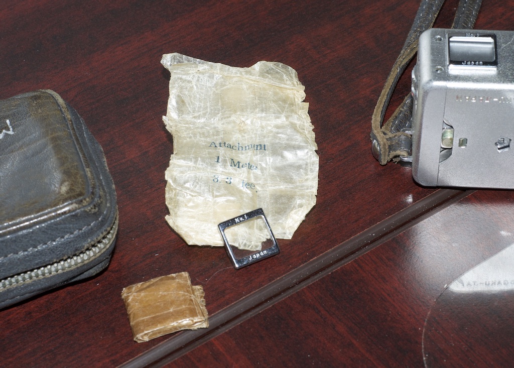

I think I have some small Wratten ND filters around somewhere that came with some Bolex stuff, but the 8mm Bolex cameras I use don't take the Wratten filters. I don't think it would be hard to make a little slip on Wratten filter holder. Maybe in conjuction with a tiny lens hood.
I also have a set of the Minolta 16 first series close up and infinity lenses I never use (because I like using the later cameras with the larger lens opening).
Interesting to try those to get the Sharan to focus.
