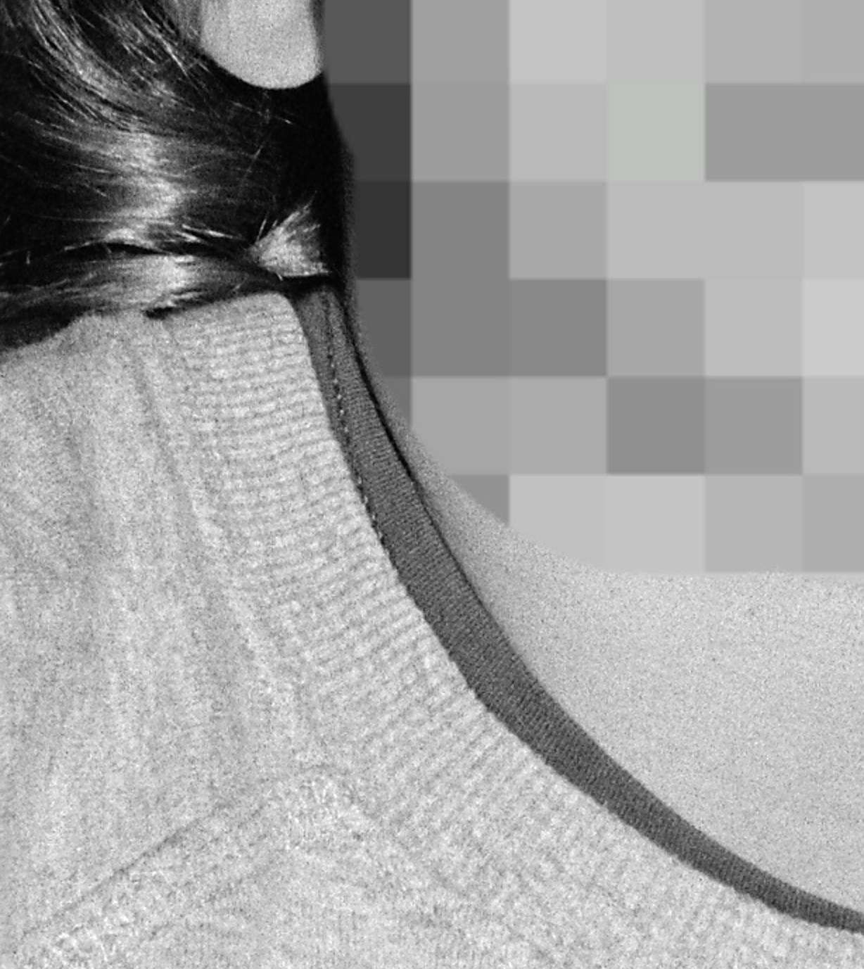

This was shot at f8 with the Yashica A, Yashikor 80mm Lens, its razor sharp also projected under Enlarger, its a triplet Design, the problem i have sometime the focus is behind the subject, i have checked the ground glas on film plane and it looks ok, what could the problem be, do i move between focusing and taking the shot? could it be the film gate lock moving slightli and removing pressure from the pressure plate?
thx,
Dragan

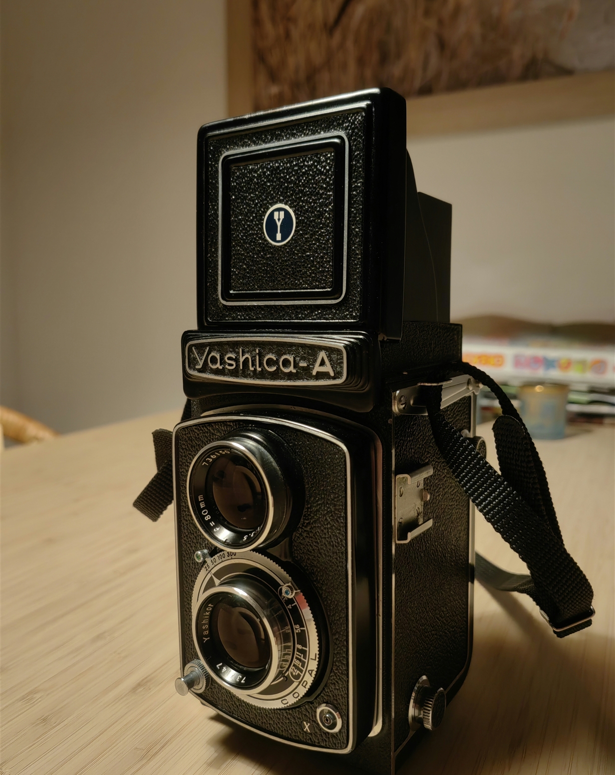

What you see is from upper lens and what you take is from the lower lens

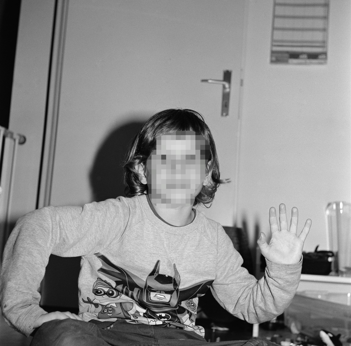

thx,
Dragan
View attachment 381348 View attachment 381347 View attachment 381345
If you are having focus issues as noted, please consider that when you check focus at the film plane with a ground glass, you are focusing the image taking lower lens directly. However, when you focus the camera normally, you are focusing the upper lens by reflex on the internal ground glass. The correct focus of the image depends on the focus plane of the upper lens being identical to that of the lower taking lens. This synchronization between the two lenses can be knocked out of alignment over time by accident or sloppy repair work. (I had this happen with a Rolleiflex 2.8F I looked at buying. A weekend trial of ocean landscapes down the tube. The buyer's asking price plus cost of repair exceeded my value for the camera, so I passed. The seller was pissed when I explained why.) If that is your problem, the repair involves removing the leatherette and cover plate surrounding the lenses to expose the threaded mount for the focussing lens. Using a film plane ground glass to determine correct on-film focus, turn the focus lens in its mount to manually focus the upper lens so the focus points of the two lenses match. Carefully reassemble and enjoy. HOWEVER, before doing all this, carefully disassemble the top-hood and focus screen to examine the reflex mirror. Apart from needing a cleaning after 70 years, it might have been knocked loose and be out of physical alignment. Repair first if needed. Yashica TLRs were the cheapest of their time, and built quality, or lack thereof, reflects that sorry fact. A failed mirror attachment (glue) may be the only problem.
