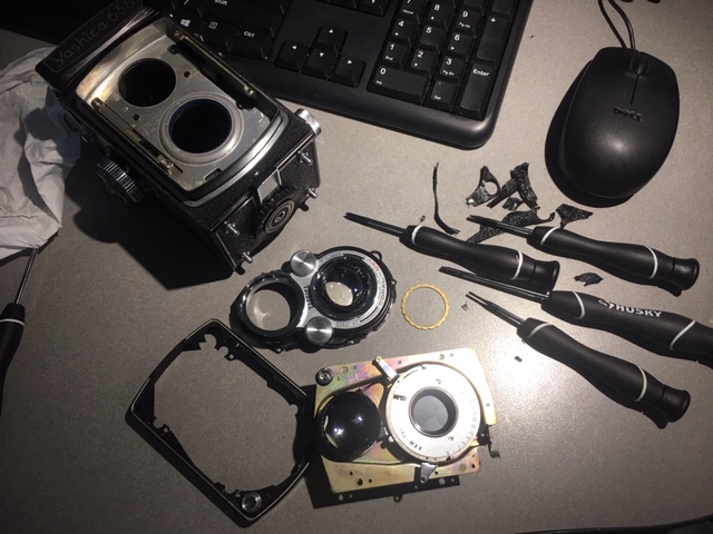

Back in March, I found this 635 on eBay. From what the seller posted, and the photos, it looked extremely clean and well taken care of. I figured I'd give it a go. She was overpriced, and I low-balled her, and we ended up meeting in the middle - which was still more than I wanted to pay, but I did it. It has the 4 element Yashinon Lens instead of the original 3 element Yashikor, which is why I wanted it. When I received it the shutter was completely inoperable. I requested a refund, she said I agreed to an "as is" sale, I disagreed, but she finally agreed to grant the refund if I mailed the camera back to her. I sent it back the day after it was received.
Two days later, after some long thought, reflection, and review of our complete transaction, I realized that I had misunderstood one of her messages. At that point I sent her a message, explained my misunderstanding, profusely apologized, and told her to keep the money and the camera, and have it repaired. The camera was a gift from her late grandfather, and she was selling it for extra money to live on since she had lost her job. She lived in Brooklyn as well, so I figured being in in the epicenter of the pandemic, she probably needed things more than I did. She kept up communication, and decided to send it back to me, which was very gracious of her. I received it today, a second time.

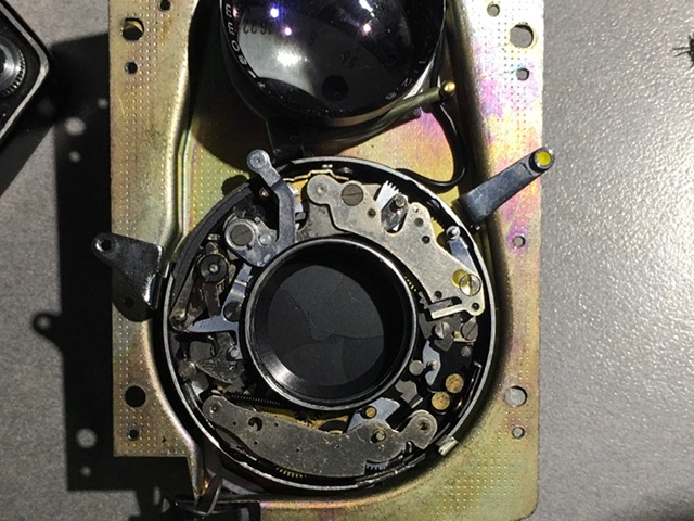

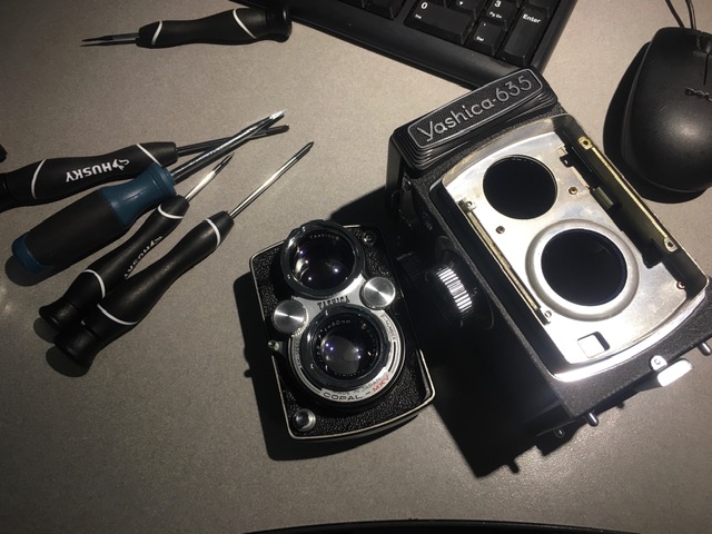

The shutter was still inoperable, and I decided "well, what's the worse I can do?" So I looked up some youtube videos, found a couple manuals online, and got out my screwdrivers. As it turns out, someone completely sheared off the self timer lever and the self timer mechanism was keeping the shutter from opening and closing properly.
I opened up the shutter and was eventually able to release the self timer mechanism, and was able to get the shutter to operate at all speeds. The article I found showed me how to remove the self timer mechanism all together, but I wasn't able to completely get it out... yet. My problem is that I can't get the flat side of the mechanism towards the lens, to lift it straight up.
Additionally, the weirdest thing occurs. I can get the shutter to cock, fire at all speeds, and operate functionally while the shutter is completely taken apart. But when I put the cam, cover, and retaining ring back on, it goes back to not opening/closing.

Something you had loose inside the shutter is not seated properly, the cam is not properly engaged or the retaining ring is being tightened too much.
I have seen pins or levers that are flush to the cam/speed ring top when the ring is installed correctly but will sit under the ring if overlooked.
Another possibility is the case is bent from a drop.

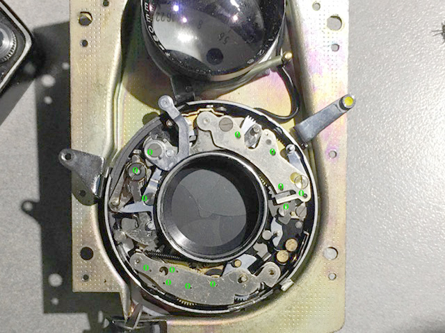

I took it apart again today and tried the CRC electronic cleaner. While it did seem to dislodge some of the debris, it did a better job just mudding things up. The rear lens element now looks like I dragged it behind a truck on a muddy road.
I oiled the points with some Hopps #9 oil, and things got better, but then they got worse. They unstuck and I was getting full functionality, and then they'd get slow and sluggish again. I doused them with electronic cleaner again and they'd get better for a while, and then something would get stuck again.

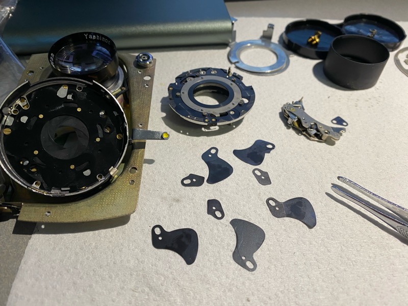

Ha!! Progress! Got the speed regulator out!! Only thing left is figure out how to get the shutter blades off for a cleaning.
