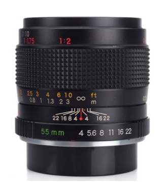

I got a cosmetically nice 55 f4 macro through the mail, but, as usual, there are issues.
1) Foggy lens elements
2) Aperture blades covered with oil
3) Aperture won't close down all the way
Since it is in very nice cosmetic condition I thought it was worthwhile to salvage it.

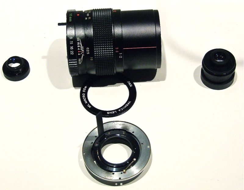

This well corrected lens has only 4 elements, so cleaning should be easy. The front two unscrew easily and the rear two unscrew easily.
Though, the rear two elements look like they are permanently sealed together with a rim of metal squeezed over on of the elements. I did not see a way to get them apart. Thats OK because the inner element surfaces were pretty clean. In terms of the front elements, the front surface was the worst. It had the awful oily residue on it and it was a little trouble to get it all off. In the end the glass cleaned up pretty well and underneath the haze there were no scratches or imperfections in the coating.
ic-racer
ic-racer
Feb 25, 2007
16,546
USA
Oil on the aperture blades.
With all the glass elements removed from the barrel, I was able to flush the aperture mechanism. In this case acetone was used. but be careful. If you get acetone on the outside of the barrel it can take off the numbers. Also, acetone can remove black paint that may be used internally to prevent flare.
Without taking the entire mechanism out and soaking it, it can be difficult to get the blades clean. New oil keeps seeping out from the perimeter onto the blades. With some persistence I got the blades all clean without having to take the lens helicoid apart to get the aperture mechanism out.

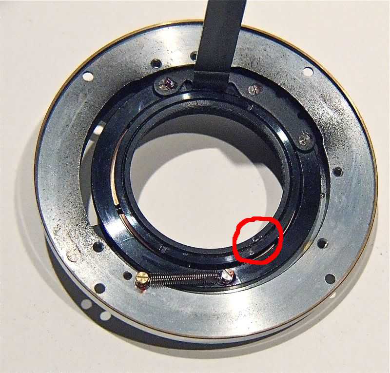

Closer inspection of the rear of the lens mount revealed a ball-bearing mechanism for the aperture actuation lever. There was a locking ring over the ball bearings and the ring was too tight, causing the ball-bearings to bind.
Even closer inspection showed that there had originally been a drop of glue or paint to keep the ring from tightening.
I loosened the ring to the original position and applied a new drop of paint to hold it in place. The aperture then worked perfectly.

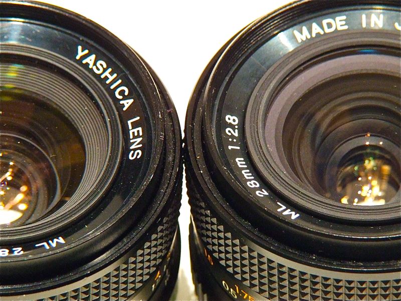

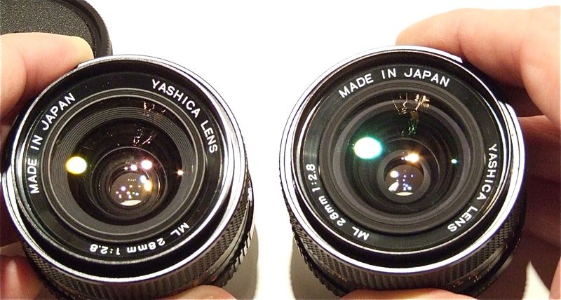

That 28mm lens, by the way, is a desirable third generation 28mm f2.8 7 element lens. This is a re-design of the earlier ML 28mm lens with a lens formula the more closely matches that of the Zeiss 28mm f2.8.
Early Model Yashica 28 f2.8 ML Lens:
Late Model Yashica 28 f2.8 ML Lens:
Zeiss Lens:

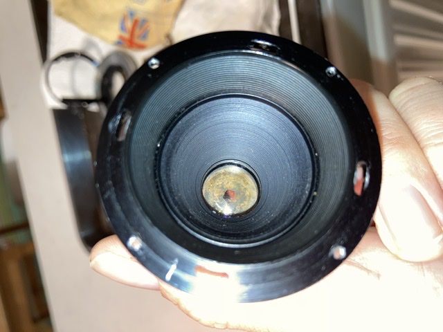

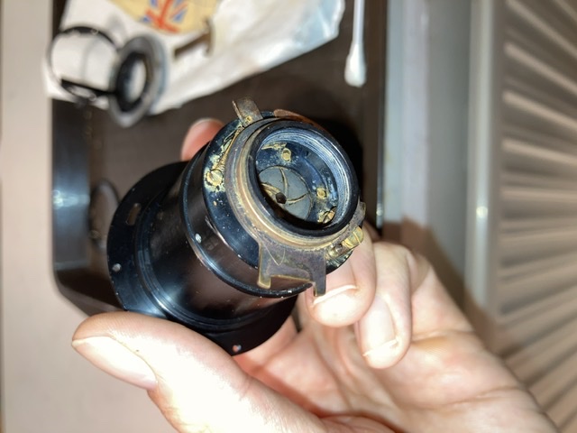

Guys, do you still remember how can the front element and its barrel be separated from the apperture mechanism? There are 3 small screws that I removed but the front part with the apperture wont get apart. Do you know by any chance what is the trick? I need to get out the blades to clean them as they are oily.
Many thanks!

I don’t understand your photos of the 55/4. How could you get out the front elemets without disassembling the whole lens? My version is now disassembled and the part that holds the front element and the aperture looks like this. I just cannot get to the blades…. Do you remember how was it in your case?
Ps please ignore the rust, I soaked it in alcohol that was not a good idea for the metal parts….
View attachment 289463 View attachment 289464
I believe I unscrewed the inner cone seen in your lower picture.

Now that you have rust on the aperture blades, you will have to totally disassemble the aperture and clean each blade with brasso or a similar metal cleaner.
You can get tips on the cleaning part from Chris Sherlock's Kodak Retina Repair channel on Youtube.

Many thanks guys. The inner holder was glued thats why I got confused. Now I succeeded it. Cheers!
