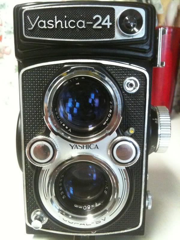

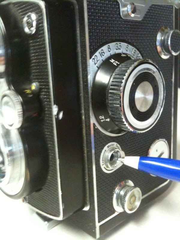

I have a yashica 24 that has a few issues thus the reason for the cheap price. The timer lever will not budge, the film advance cranks and stops as it should but sounds like a coffee grinder, the trigger works but the shutter does not activate and there is something missing on the left side (camera facing away from you) that is labeled "exposure meter switch". It almost looks like a stero jack with the chrome bezel and an empty hole and the label has a finger pointing at it hmmm. I would pimento get it working if I can without sending it off for repair, but if I have to then I will. Any ideas? I originally bought it as a parts Camera but it is in to good of shape to relegate it to the parts bin.
On the left side there is a momentary type switch to turn on the meter, is that what you are refering to? The other items on the left are (IIRC)focus, spool release knobs, and battery compartment. You can find an owners manual at butkus.com for it. There may be other sites on-line with more info.

Right now there is no switch there just a hole with a pretty chrome bezel. The synch switch is on M now and has been the timer is jammed somehow and it doesn't matter what position the synch is in.

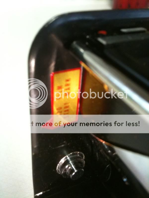

I have proof and I am going to spread it to the world, be it may, the forces of darkness prevail. The 24 WILL take 120 film. If I can just figure out how to get a pic up on the forum, Damn this intolerable techno deficiency disorder. Inside the back on the underside of the camera is a tag that indicates where to start the film for 120.

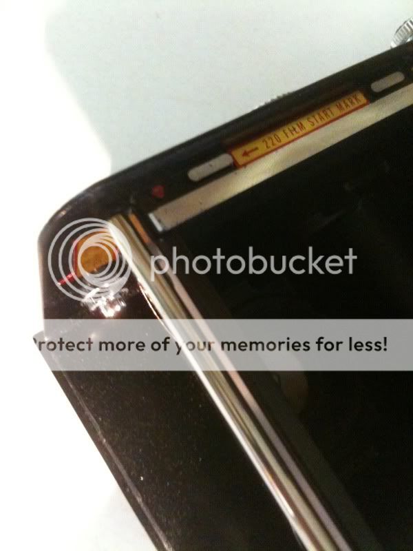

John, the pressure plate is fixed and the tag under it says "use 220 film only", but, and here is the caveat, there is a gold sticker with red trim that states "start 120 film here" and it is the same type of sticker that is used on the back inner edge that indicates the start point for 220 film.
Thats odd, all the literature I've read (including the Yashica owners manual) all agree that this model Yashica TLR will only accept 220 film, and that the model 12 (brought out one year after the 24)is for 120 only film. Makes me wonder if someone hasn't "modified" this camera to accept 120, or possibly just put a sticker in and it serves no purpose. Every dual film Yashica (and Mamiya TLR) must change the position of the pressure plate to allow for the difference in film/backing thickness.
Rick, it looks factory to me, as I stated, both of the stickers agree in appearance as to be from the factory.

It says 220 only but...
Here is where the mystery begins... sorry it's fuzzy
Both the 120 and 220 factory load tags...Yes it is still the 24
Those "start mark" tags look to me to have been added by a 3rd party - not the manufacturer. I wonder if the camera has been 3rd party adjusted/modified.
My Mat and 124G have the same tags. The Mat only has the 120 tag tho. It's a mote point until I can get it taking pic's.

This is the hole that I was talking about. It is for the light meter and I'm just wondering if it will affect the operation. I don't think it will but who knows?

It may be that they start with a generic body, then trim out for the particular model. They may have had three variants of the same model that took that body, hence stickers for functions that dont exist.
