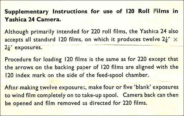

From the manual:
Donald Qualls
Donald Qualls
Jan 19, 2005
12,544
North Carolina
Well, that just about covers that, then. Looks like a 24 is a viable alternative to the more expensive Yashica TLRs, especially if I can spot one with a Yashinon.

Hi Donald, I'm pretty sure that all the 24s came with the Yashinon. It also has the ƒ2.8 viewing lens, which does make it a little bit easier to focus.

It's funny how this thread went from "well informed" inner knowledge of Yashica's mechanical design to Yashica's own manual shuttering that with few simple words.
Deleted member 88956
Pressure plate holds film against film gate runners. Using 120 film in 220 set up may show scratch marks along film's length (frame's side edges, not across) as the pressure applied is somewhat higher due to additional backing paper in the path. This however will directly depend on how film gate runners were finished off in production (or later in "repair"). Well machined cameras are unlikely to cause this problem. Pressure pate function is easier to see in some 35 mm cameras (Altix n comes to mind) where pressure plate is actually loosely hinged on film gate section, then spring pressed into position upon back closing.
All the 120 in 220 talk and worries is about motorized backs and fear of burning the motor due to somewhat higher friction, most of which is unsubstantiated and mostly only theoretically true. I don't know of one film insert that does not allow a simple part flip to fool it as being one or the other counter wise (at least in Mamiya 645 or Pentax 645 are so). Never looked at interchangeable film holders so am not sure if same is true.
