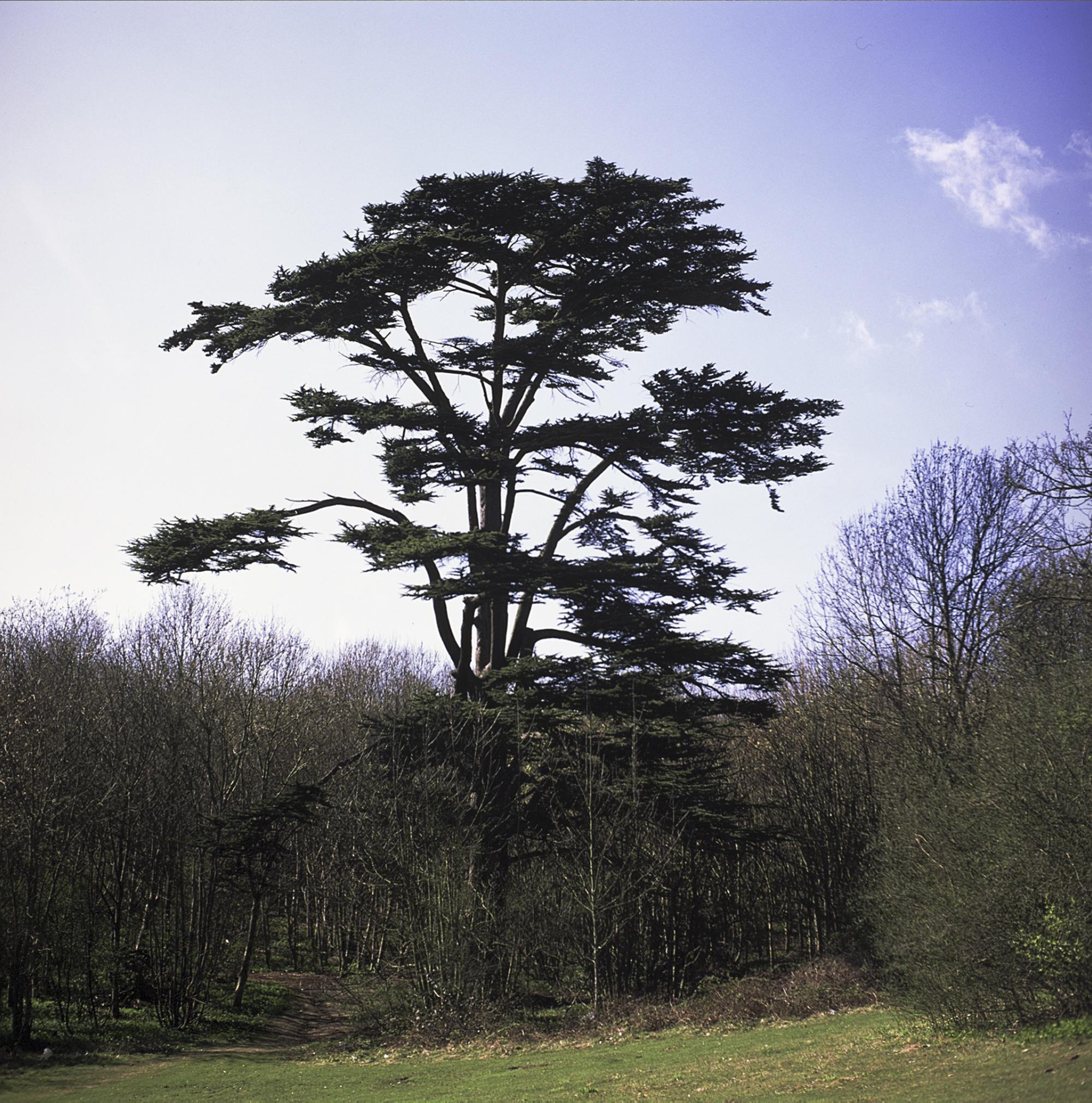

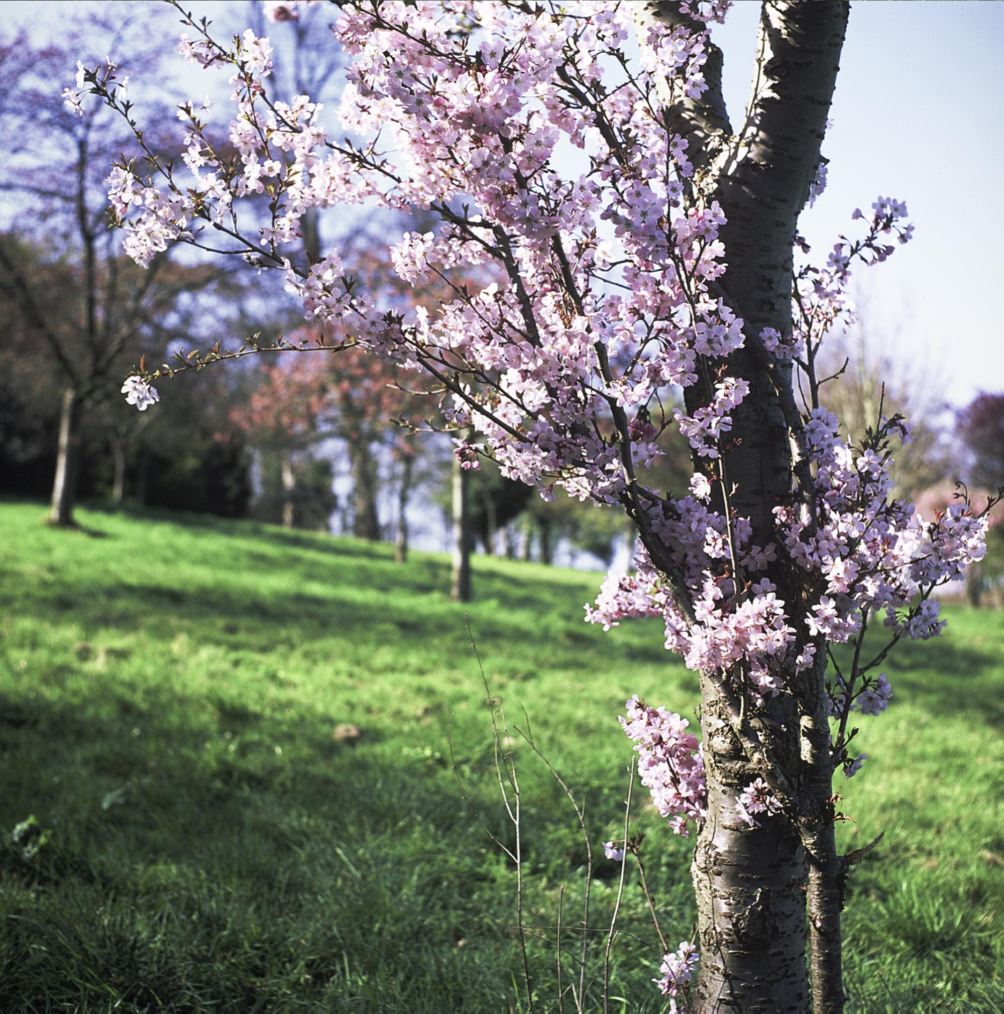

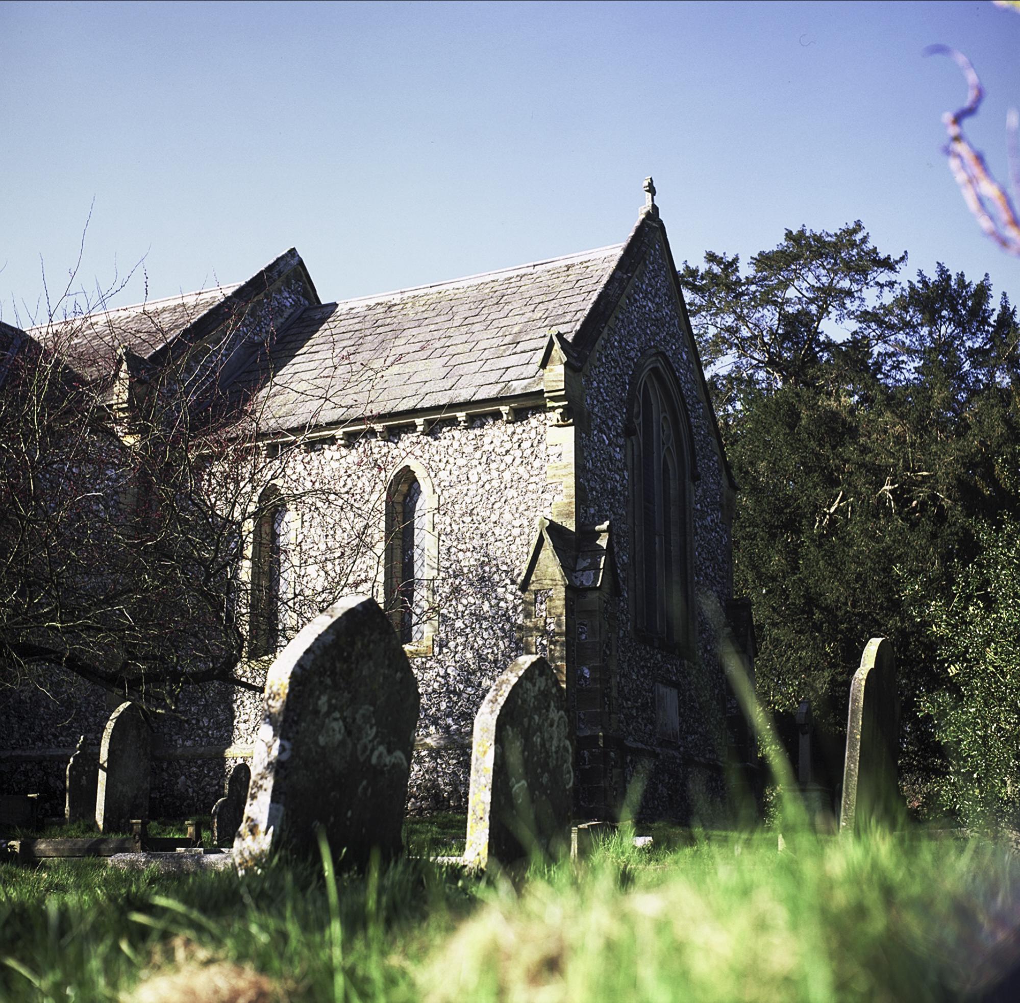

Anyway, I thought I'd have a go with a second roll of film and that's when I tried with the Velvia 50 (shot at 50 ISO) on a sunny afternoon. This time I used a tripod and cable release for some of the shots to eliminate the possibility of camera shake. The results came back just as disappointing as previously but being a novice with colour film and with slide film in particular I'm not sure if it's the camera that is to blame or my exposures. All of the metering was done through the camera's built-in light meter which is powered by the original 1.5 volt mercury battery. To my eye, there's a general lack of sharpness, the colours look unnatural and there's a purplish tint on some of the darker images. The slide stips do look better when held up to the light and viewed with a reversed 58mm lens but the scanned images look awful. Here are some samples:
Probably the brighest and sharpest shot in the roll:
All in all I'm rather disappointed and not sure what to do. :pouty:Any tips would be greatly appreciated.

I haven't done a whole lot with my 124G, and I have not disassembled the viewfinder area, so I'm not sure what's under there. At screen resolution here, your first three shots look a tad "front focused." So that might suggest the ground glass path is a bit out. The meter on mine is intermittent, as though the switch activated by lifting the lid may be dirty, but optically the results are excellent (I use a separate meter).

I don't know about you, but those look fine to me...

I actually looked at the samples and the sharpness looks about right for scans. About color, well I'd say don't use the on camera meter for slides. That will be why the colors are like that, or its the lab, but I'd say its the exposure first. But also hold the slides up to the light, if the colors on the slides itself are much better, than it's the scan.

I suppose some of the problem could be in the scanning, but I'm doubting it. To me, in the one of the church (#3), the center gravestone, and particularly the one on the right, look quite sharp. In the 1st picture, the grass in the foreground about -- oh -- 6 or 7 meters out from the camera looks sharper than most of the rest of the shot. In both cases it would seem the focus was closer than infinity, even closer than hyperfocal setting for whatever lens opening was used. At ISO 50 the OP was probably not stopping down much, and depth of field would be limited too. Anyway, that's why I think the ground glass/viewing lens path is off a bit. (Of course, I admit we don't know what the OP actually tried to focus on either!)

So, in retrospect I doubt there was anything wrong with the exposures except for shot #1 (f 5.6, 1/250, BTW) where it's true that the focus is on the grass and not on the trees. DaveT, you're right! I can't remember whether that was the effect I'd aimed for or not...
In shot #3 (the one with the church and the graveyard), I focused on the sunlit wall of the church, near the corner. I shot at f8, 1/30 sec and used a cable release to fire the shutter so that there was no discernible camera movement. When examining the slides, the church wall looks to be in focus and so do the branches right in front of the wall but the gravestones begin to be out of focus which is what I'd intended.
Beginner's error: I think one thing I overlooked when trying to judge DOF is the difference between viewing and taking lens. I realise now that you can't accurately preview DOF on the Yashica Mat's focusing screen, presumably because the focusing lens is F2.8 whereas the taking lens is F3.5?
