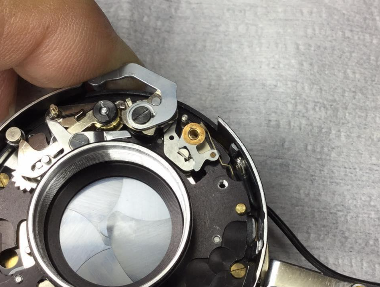

ic-racer
Feb 25, 2007
16,658
USA
This photo may be of some help. Reference below.
Yashica Mat-124 CLA Tutorial
Eugene Pate learncamerarepair.com
