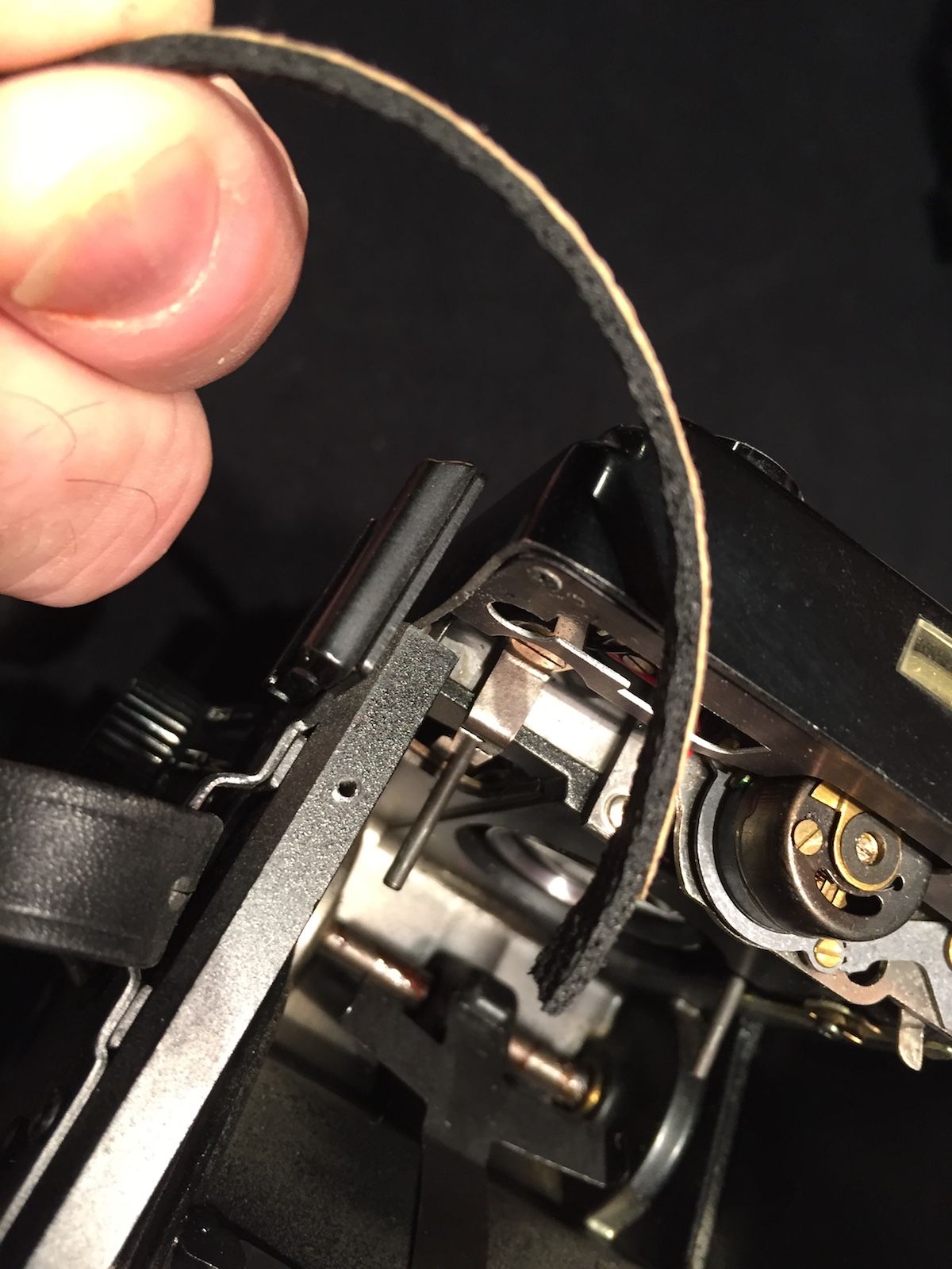

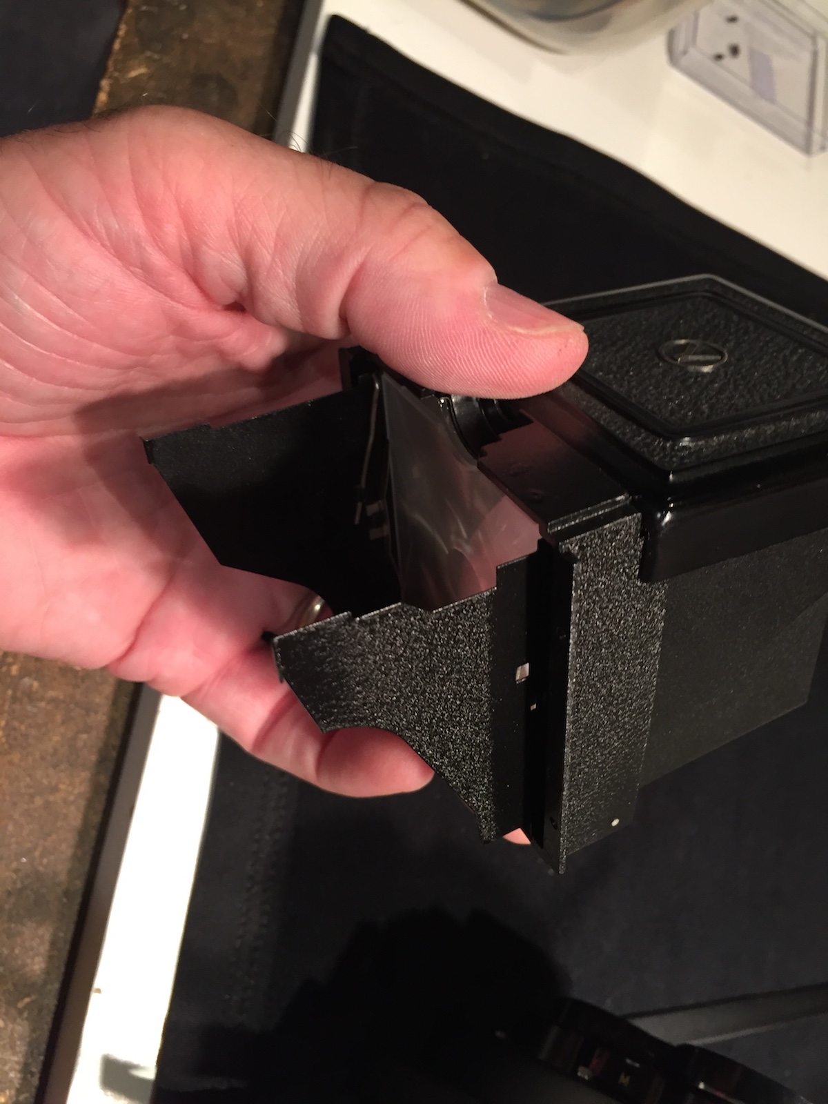

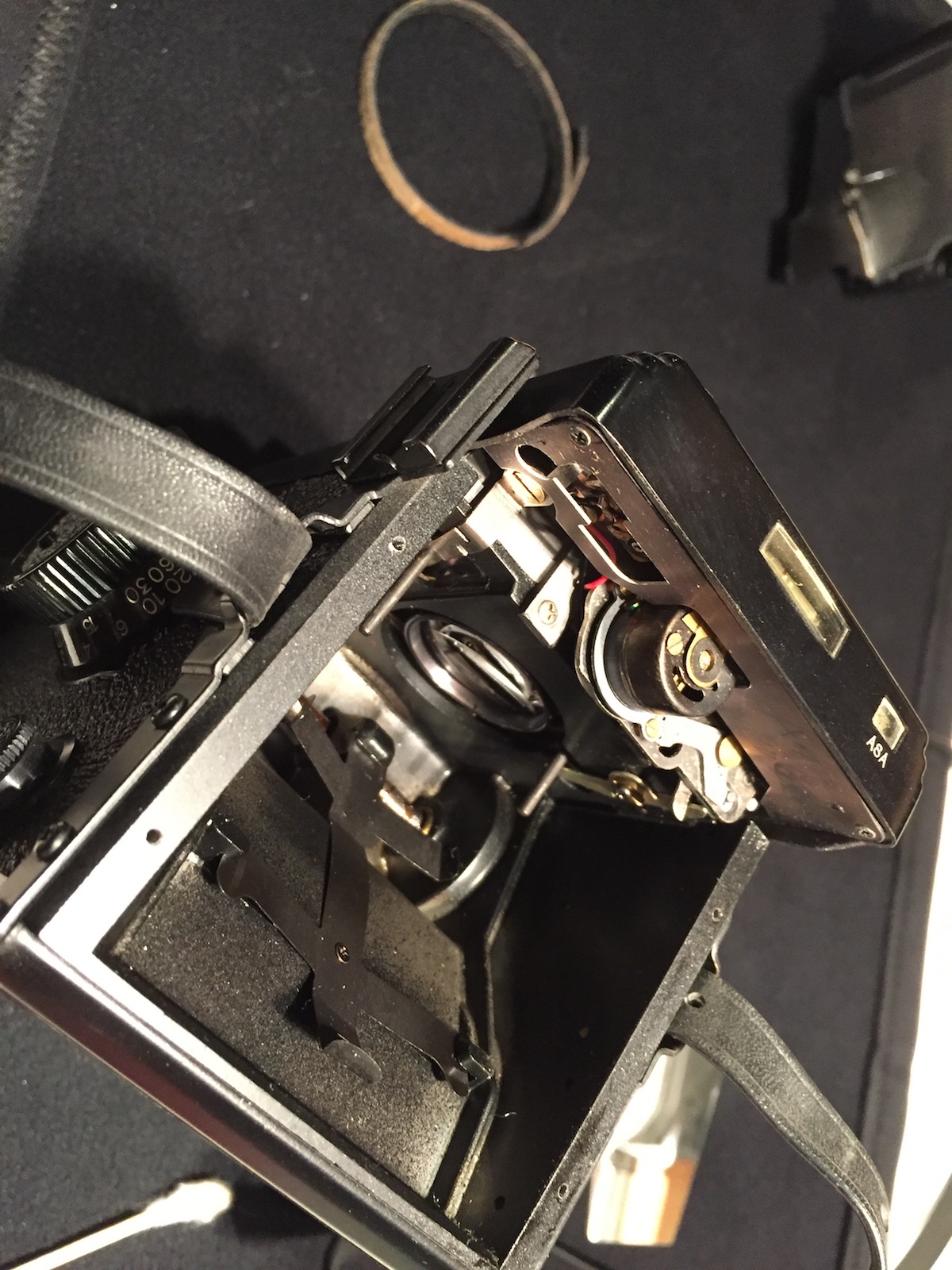

A few minor repairs of my 124-G. I got this one new in 1975. Last time I traveled Europe, this was the camera that I used.
For many years during the 1980s I was a 'medium format' snob and did not shoot 35mm and I used this camera exclusively.
The fold out hood is removed.

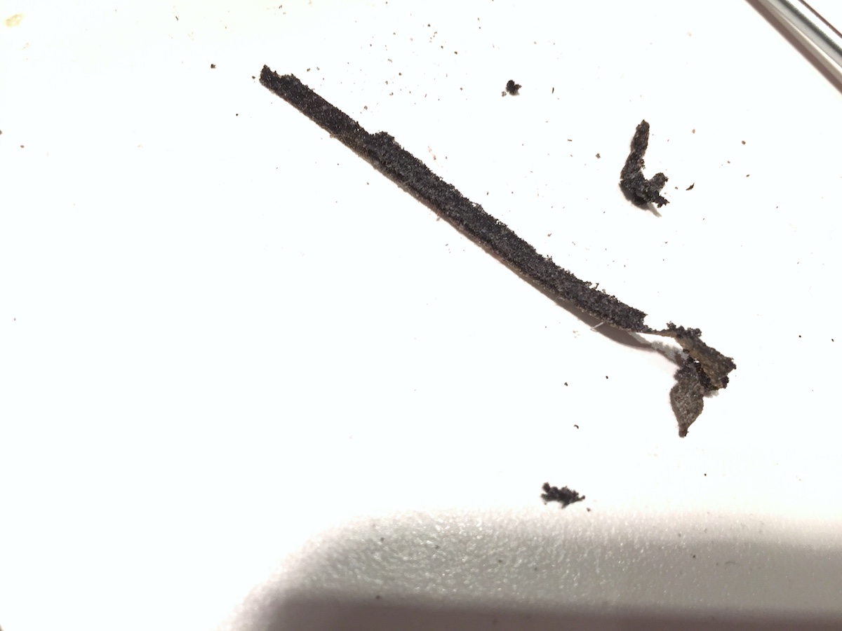

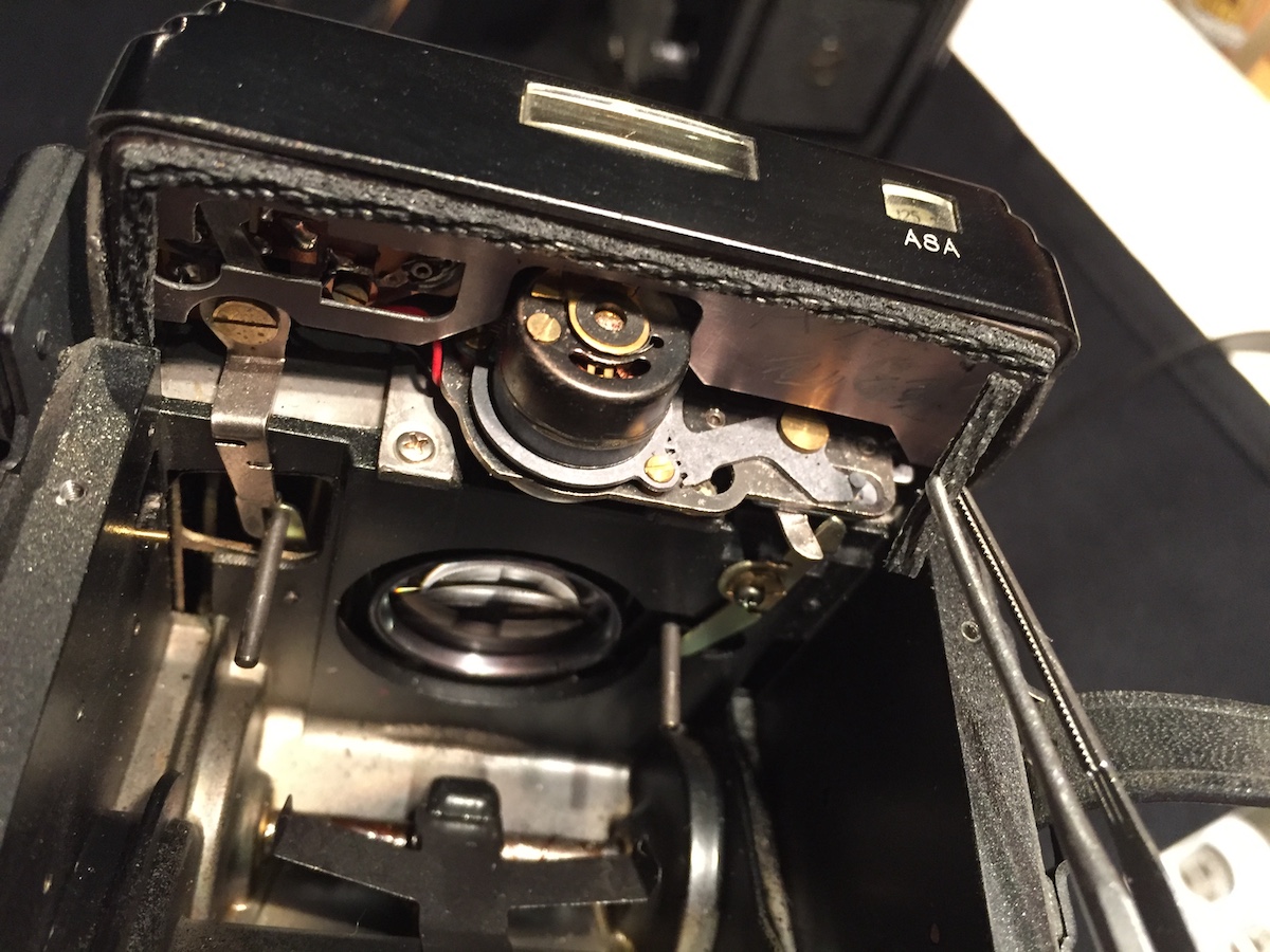

Deteriorated foam rubber removed from between the meter module and the flip up hood.

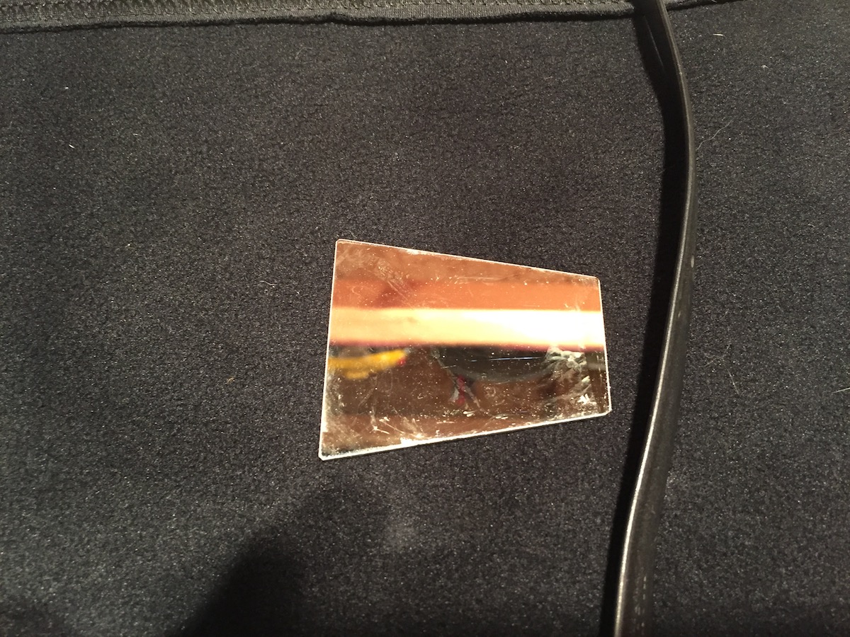

Viewfinder glass cleaned and mirror cleaned.

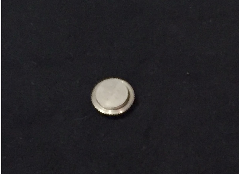

I use Zinc cells for the meter in this camera. Meter works, the shutter speeds are all good. Glass is clean. Camera is ready to go.
I have placed a serrated washer around the battery. The washer is re-usable.

I use these cells because they are good for ANALOG as indicated on the package....

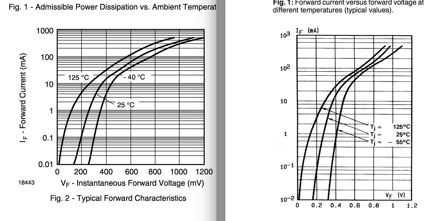

A Schottky diode can be useful here because Schottkys often have a lower voltage drop than a conventional silicon diode. A regular silicon diode, when conducting a moderate amount of current, typically has a voltage drop of about 0.7 V, while Schottkys can drop around 0.2-0.5 V depending on type. Because most light meter circuits draw a very small amount of current, the actual voltage drop may be less. For example, look at figure 2 in the datasheet for a Schottky BAT43: https://www.vishay.com/docs/85660/bat42.pdf The "knee" of the curve of forward voltage drop vs current is at around 0.4 V at room temperature. But if the circuit draws only 0.5 milliamps, then the forward voltage is closer to 0.2 V, which is about what we want to make a silver oxide battery look like a mercury battery.
Since this does depend on current draw, it may be that the ideal diode for one camera is different from another, but probably close enough.
Actually wiring the circuit would be simple, just put the diode in series with the battery with the correct polarity. The hard part will be getting the assembly into the small space of the battery compartment and making good contact.
Schottky types with low voltage drops to look at include BAT41-BAT46 and 1N5817, 1N5818. The BAT diodes tend to come in very small casings which is helpful, while the 1N5817 are larger. They're all common, inexpensive parts. I have some but haven't experimented with this much.

Yes that datasheet is similar to one I consult. For those not familiar with the graphs, the more straight up and down, the better for our purposes (of lowering silver-cell voltage in spite of unpredictable current).
reddesert, any success stories to share on using diodes?
