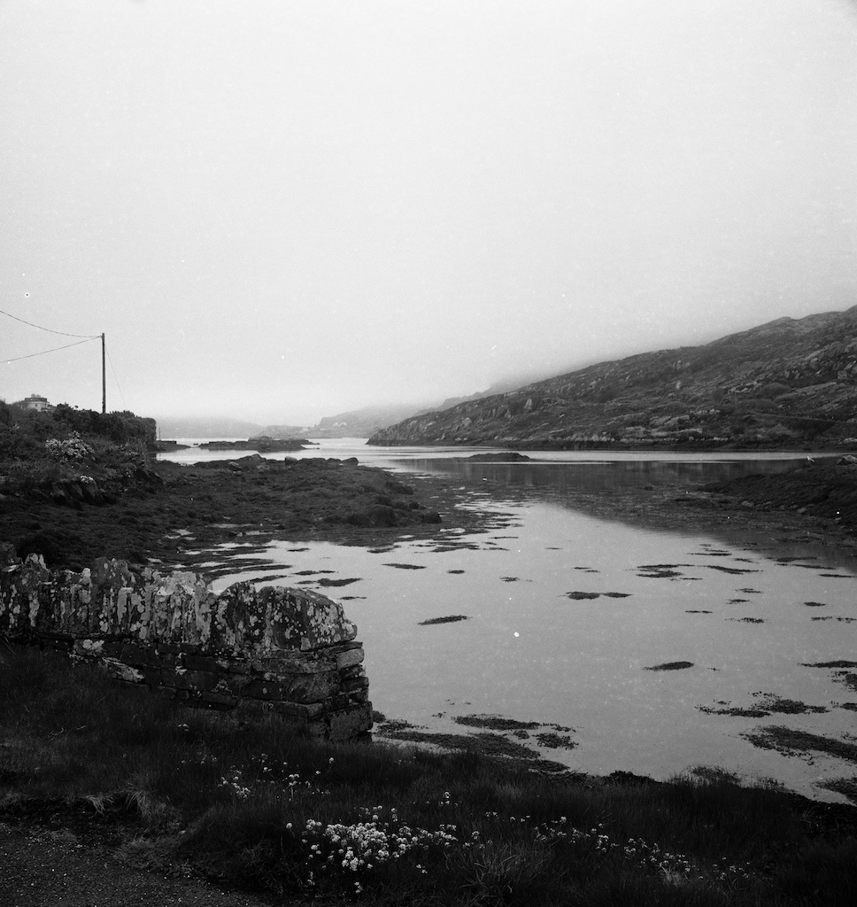

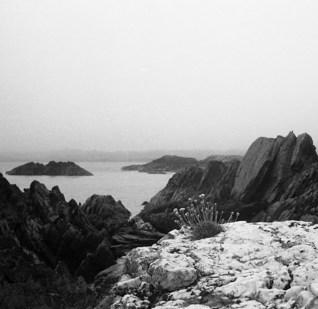

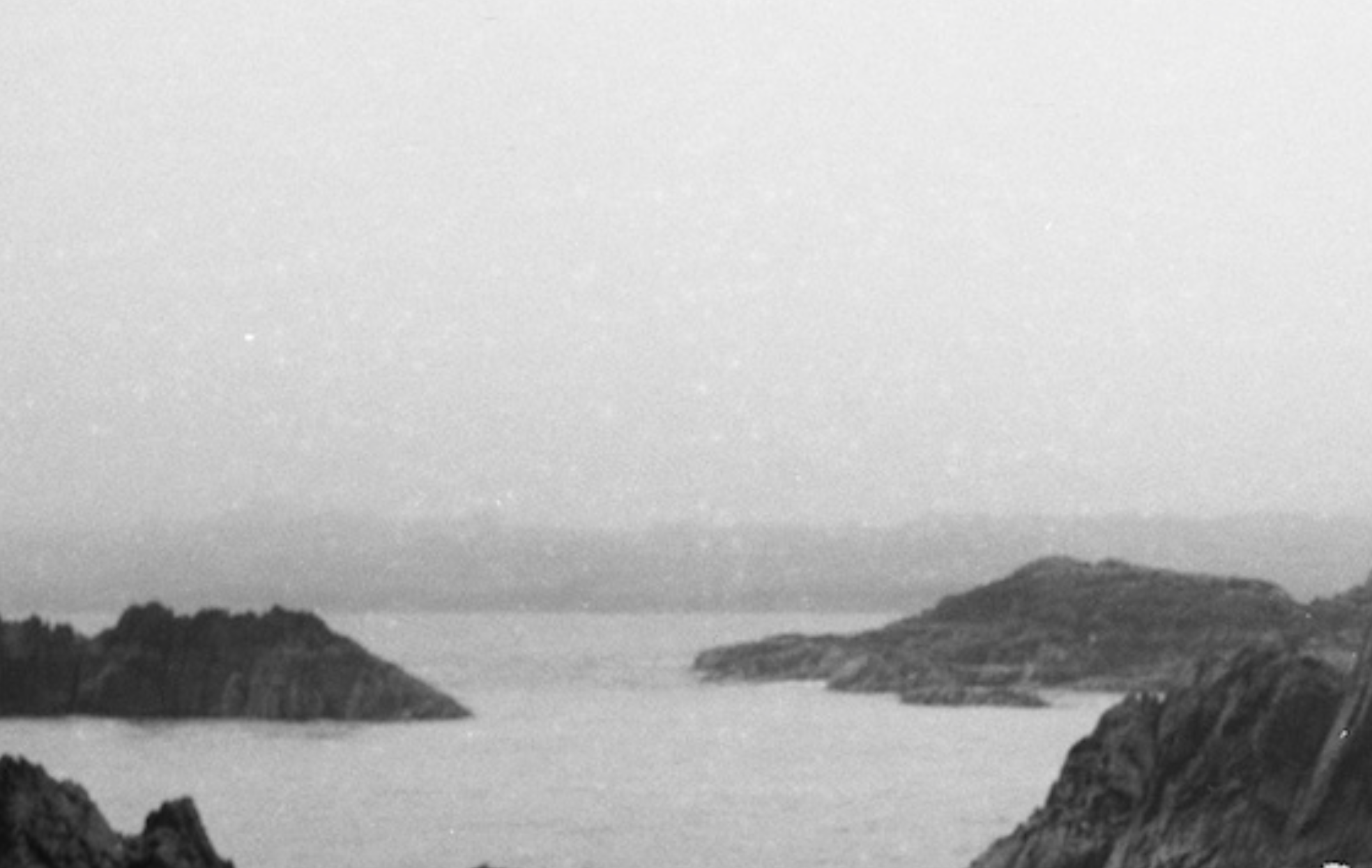

Hi, Can someone advise what they think this is.
NOTES: to try and give as much information as possible:
As you can see some areas of water where more light was have a beautiful sheen but then this mottled grey appears closer to camera. second shot mottled grey effect on horizon. There are a few obvious dust spots that are scanner legacy these are not what I mean.
Weather:
Cloudy overhead, grey solid duvet sky with low mist = Irish summer
Camera & Film:
Minolta Autocord TLR on a Tripod. long exposures half a second at f/16
Ilford FP4+ 120 rollfilm. EXP 2015 but kept in a fridge since purchase.
Development:
All Chemicals were brand new, freshly bought that week, mixed two days before using distilled water as I am in a hard water zone. XTOL was filtered after mixing using coffee filters. Stored in brown glass chemistry bottles.
Patterson Tanks and reels all cleaned well in advance.
3 rolls of 120 at once in the highest type of Paterson Tank: Other two rolls in same tank came out fine without this issue ( light was better when these were shot)
Dev Sequence:
Prewashed,
Then left in water to reach dev temp, 3 minutes.
XTOL Stock 20C: 8 minutes, 5'' Agitation every minute = 3 turns, two sharp bangs at end then tapping with coin further 20" to ensure air bubbles driven off.
Stop bath
5 minutes in Fresh Ilford Rapid Fixer
15 minutes wash under runnning tap water 20 C
Final rinse with distilled water and wetting agent.
brand new squeegee one light run and hung to dry.

looks like backing paper issue. put it in room temperature for a few hours before you open the packaging. otherwise condensation can make it stick to the emulsion slightly, and then you get stuff like this.

I agree this is a strong possibility but the film was out of the fridge 7C for 2 days at room temperature before opening.

Here's just what you do not want to hear but I cannot see what is wrong in either shot

Can you see this effect on the negatives themselves?
I'm not sure I can see it in the small scans you have uploaded - try re-scanning them rotated to upside down and upload larger versions - closer to 800 pixels on each. If the effect moves when the scan is done on the rotated negative, you will know that the scanning process is at least part of the process.

  1. Please post negative.
  2. I prewash black & white and color negative film, except for Kodak Tri-X developed in XTOL in a Jobo processor. and I have had no problems.
  3. Your film had plenty of time to come to room temperature. There should be not problem as long as the foil or 35mm plastic can has not been opened.

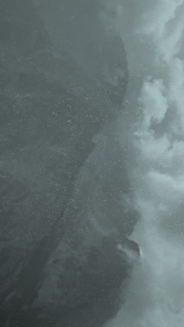

Thanks for the information so far, I will reverse scan as suggested, but it will have to be tomorrow. here is a screen grab of one of the above shot showing the misty horizon with lots of whiter dots giving a mottled effect. the bright white dots, ignore this is simply dust, I am referring to the general grey areas where a lighter white mottling appears.

So the white dots which I can now see in this magnified scan are in the negative and can be seen with a high magnification loupe?

That negative starts telling the story, especially since the photograph does not seem to be snowing.

Hi all , Thanks for the advice from everyone. I finally got to the cause. After reverse scanning, it appeared the issue was on the negative. On a light table with a loupe, the marking is apparent as a strip across nearly all the negs from that roll. but the ones highlighted are the worst. I checked the two other rolls I developed the same day and the issue is not present. This morning I just checked a further 3 rolls from the same batch of FP4 I bought, this I developed 24 hours ago and no issues present.
I can only surmise that it is poor housekeeping on my part, that I came across a stray and lots older roll of FP4 somewhere and tossed it into the same bag in the fridge.

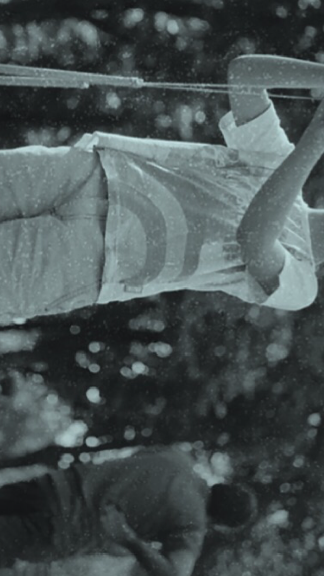

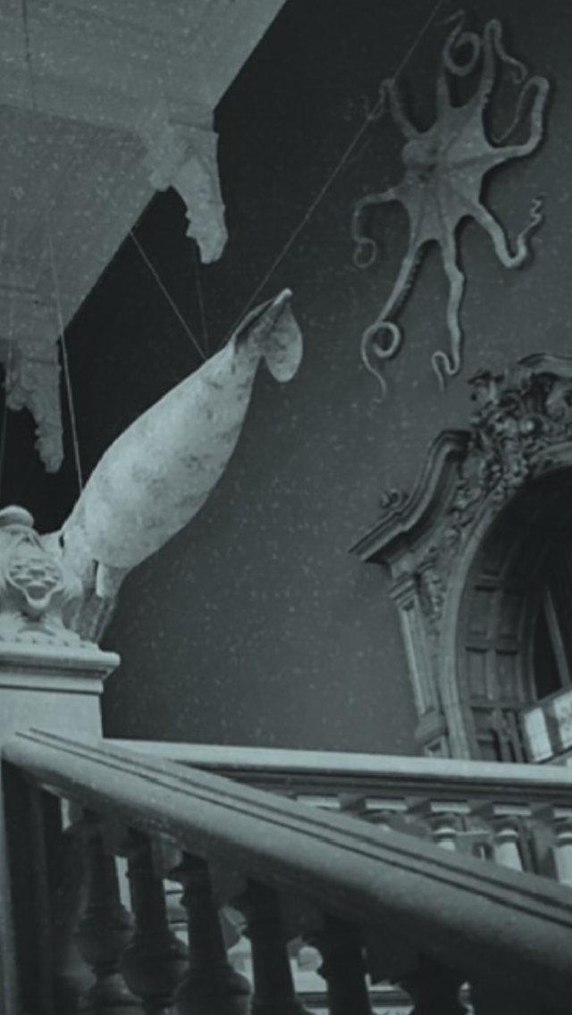

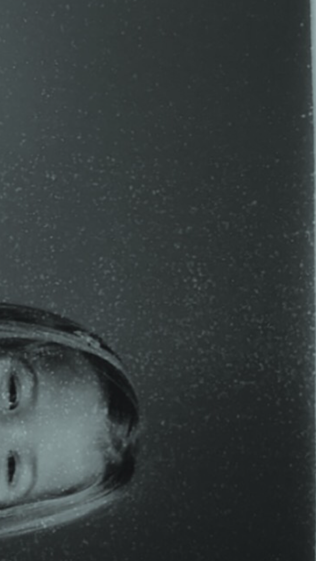

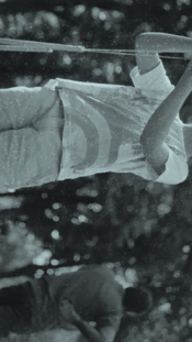

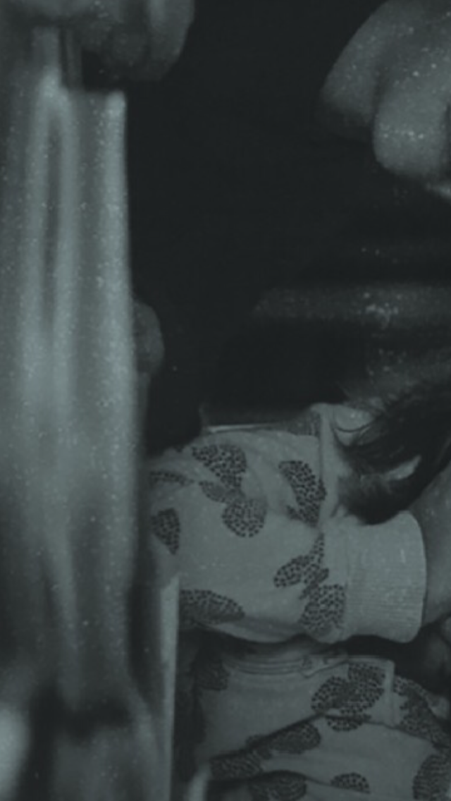

I had this some problem yesterday when developed 3 hp5 120 rolls in a jobo tank and 3+3+3 fp4 120 rolls in other three jobo tanks. the hp5 were ok, all fp4 was ruined the same way. all film purchased fresh last year from photoimpex and stored at +5 Celsius degees for some months, then removed for holidays and shot weeks or months after being removed from fridge. X-tol replenished.

Her some examples, cropped from 120 negatives
