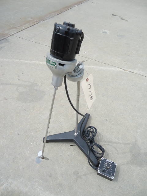

I've been using XTOL since it came out. I do it just like you. I use a variable speed propeller mixer, as you I am sure, know you got to keep it moving,, but you don't want to mix in air. I always have a little bit of something in the bottom of the mixing beaker, not more than a little bit.

I have always used something like this or a magnetic stirrer. Trying to dissolve XTOL by hand is a Pain. I think I get it hotter than 80 F but not by much. Watch Ebay. First one I used was a lot less fancy. I have one that's a little smaller than this . I got off ebay. I refuse to buy liquid developers, I like mixing stuff.
