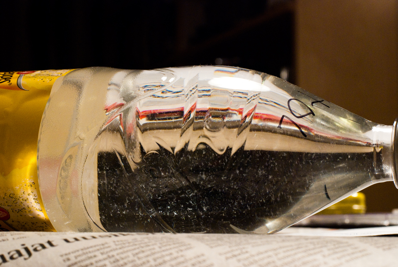

I store my xtol in plastic soda bottles. Once I developed a roll of Neopan 1600 with about 5 month old xtol. It came out severely underdeveloped, and when looking at the bottle I saw some kind of white, fungus-like particles floating on bottom of the bottle. I dumped rest of it and nearly thought of stopping using xtol completely.
I still had a extra 5l set of xtol though to get rid of, so one day I mixed it. Now it's maybe 2-3 months old, and I have two unopened, full 1,5 liter soda bottles of xtol left.
I thought of developing a few rolls today, and when examining the bottle I saw these same kind of particles floating on bottom. I'm very hesitant to try to develop anything with that kind of looking stuff again, so....
What I am doing wrong? Kodak promises at least six months of storage life, but I've never gotten it myself. Do the soda bottles suck? How much storage temperature affects it? It has been around 20-26C depending on time of year. I must be doing something wrong since other people have so good experiences with xtol.
When turning the bottle around now it's naturally full of that stuff... took a photo:

I had the same trouble with Xtol until I mixed with distilled water (my water is about 40 gr. of hardness!) and stored in glass containers. Plastic containers do 'breathe,' as it were, and eventually air oxidizes the developer.

This is very surprising and XTOL mixed in same tap water (in the same city as Ihmemies) and stored in the same kind of PET bottles has always been fine for 6 months for me. 2-3 months sounds unbelievable. There shouldn't be so much iron here, either.

Xtol mixed with my tap water expired in 2-3 months, regularly. I did go to glass but the problem wasn't truly solved until I bought the distilled H2O. Now it meets Kodak spec.

somehow looks like my xtol... (maybe I have slighlty less particles). I do use demineralized water and glass bottles. recently bought them new, produced in cleanroom, (-> medicine bottles). Have had the same probs with D-76 and Calbe A49. (Maybe the problem is me...) This time I noticed this fallout only some days after mixing it... So I proceeded as I did with Calbe A49 and D76: Simply ignoring the particles- And in my case it still works well (6 weeks after mixing it). As a precaution I make a check with a small piece of film every time I develop af film
In my case the reason could be, that I do not mix it according Kodaks recommondations, I mix it slightly "stronger", (625/530), and in winter it is not really warm in our flat, but never below 17°, so actually this should be no problem.
I am going to watch if it will have any discernable effect on the results, today's negatives look good.

I just checked it out... it looks uglier than several weeks ago... D76 from last year still looks fine...
I suppose anything that falls out actually is supposed to be solved... I will see, how the negatives print... and try to mix it with warmer destilled water the next time. Or change my developer...

When I used Xtol and D76 in Alaska, I always mixed with tap water - and got the same white particles (the crud / floaters) that you get! :D I never thought back then to mix with any kind of "special" water. Hehe...guess I was too young to think about things like that at the time.
But - it always worked. So, I don't think the particles are really your problem. It's probably the soda bottles. At the time I used dark brown plastic jugs from B&H, and they worked pretty well - kept for at least 4 months, but I always wanted glass.
I'd say try some glass bottles and "special water" if you want maximum longevity! I know you want Xtol specifically, and I don't blame you because it's fabulous stuff, but you could try some HC-110 syrup if you shoot very little and just need a developer around all the time. That stuff's supposed to last forever! :D

My 1 litre bottle of Xtol is still working consistently after 7 years and hundreds of films. All it gets is a replenishment of 90ml of fresh Xtol for each film and an occasional trip through a coffee filter to take out the white particles and other debris.
I believe the white particles are calcium ascorbate but whatever they are I have never noticed any effect on developer performance.

I think this is fungus. I had it in my stock XTOL solution, even when mixed with demineralized water. When I changed the stirring stick from wood to plastic they were gone.
Currently I'm using XTOL I mixed last April. Latest after a year I dump it.
Really.. could that be the cause? I used a wooden stick too to mix the xtol in open bucket. Well, I think weirder things can happen :D

I also mixed the developer with local (Espoo) tap water, so it's more than likely that the flakes are some kind of organic products. Mold, fungus, or something. It is quite clear to me that oxidation, or storage in soda bottles, have nothing to do with this stuff.
I actually doubt that the flakey stuff hasn't got that much to do with your storage life problem, but it just happens to occur the same time. (Though, it also could be that the flake-causing-organic-creatures are consuming some vital developer component.) I will get back with my results when I have developed something in the refrigerated XTOL.

I've mixed Xtol with deionised water and got a very fine precipitate at the bottles. It doesn't cause me much concern though, I can always filter it. My batch wasn't exposed to light either, so that doesn't seem to be a cause. BTW, real distilled water requires a great amount of energy and 2-3$ for 2 US gals is a bit suspicious.
