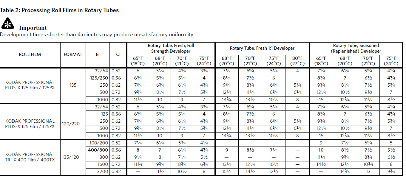

I'm not sure Kodak ever really looked at replenishment using rotary processing.
Well, the Kodak datasheet for XTol actually quotes developing times for seasoned XTol with rotary tubes.
From the XTol datasheet J-109:
Ah, today I ventured out with my old but still great Fujica G617, TMY-2 . I decided to soup the film, I don't like to wait. I double checked times.
There's nothing listed for XTOL, replenished, in rotary tube for T Max 400 films, just blank spaces on the chart.
That works for the films that Kodak tested XTOL for, using no presoak in rotary processing. For those not tested by Kodak, we XTOL users in JOBO rotary processing are at the mercy of JOBO: 5 minute water pre soak followed by the processing times prescribed by the film's manufacturer. I don't process that much film, so I have no issue using it one shot. I've had success using this method for a few years (nothing compared to your time, but it works for me!)
