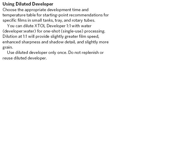

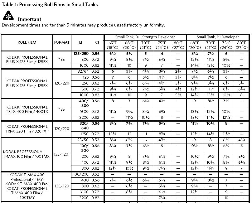

By about 30% or so. I'm still relatively new to developing and haven't performed any film, development tests. I've gone off recommendations from the kodak chart and the massive dev. chart. I developed a roll of 120 tmax yesterday at 66º for 16:30. Xtol 1:3. The negs are really dense. Suggested development is 16:45 at 68º, so I'm shorter on time and two degrees colder.
Any ideas? Thanks.

Kodak initially did recommend XTOL at dilutions up to 1+3 and gave the times in their original documentation. They later changed that and dropped the 1+2 and 1+3 timings from their updated references.
I used the 1+3 dilution for many years with great success (and never had the dreaded XTOL failure even in the early days when they packaged in small quantities). Were I still using XTOL I would still be using the 1+3 dilution.
The Kodak documents J-108 (Nov. 1997 XTOL and rotary processing) and J-109 (April 1998, "normal" and rotary processing) show the extra dilutions, later editions of J-109 do not.
