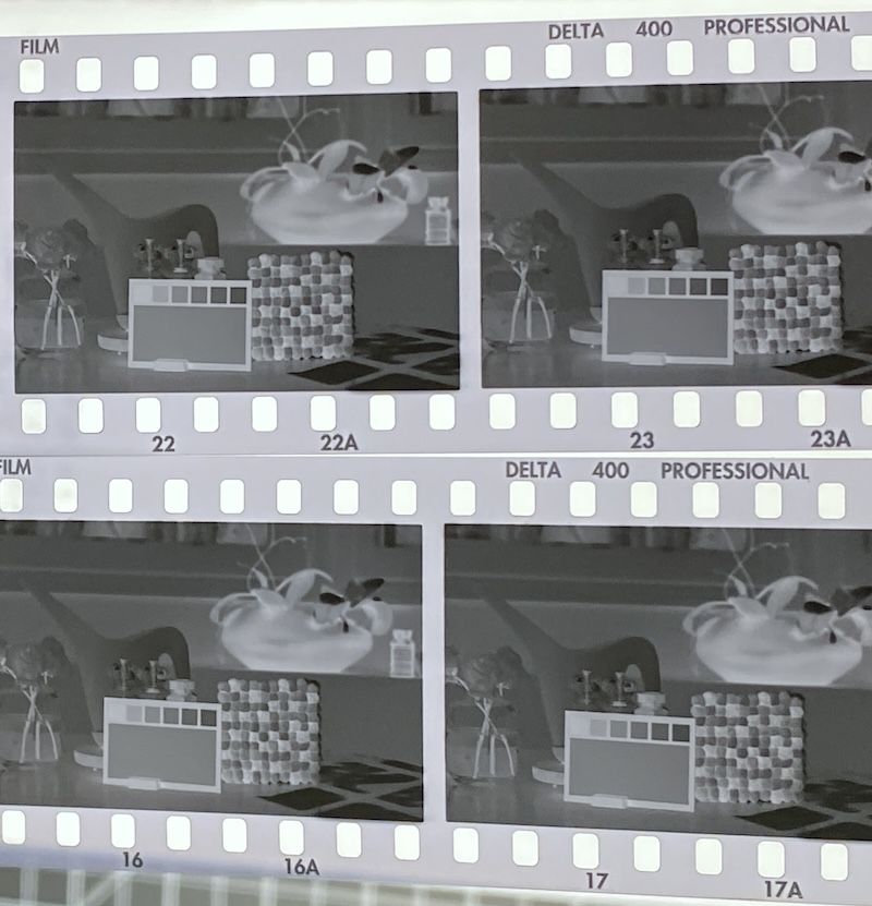

Much has been said about Xtol and its replenishing here, plenty of good threads are easily searchable. I want to offer a bit more data regarding Xtol keeping properties. I run a fairly well controlled replenished process, with regular control strip checks and adjustments. What I have found was that my replenishment volume (per roll) has been slowly going up as my replenisher was aging.
I still have the 1L of Xtol mixed almost exactly 10 months ago, on March 24, 2023 (today is Jan 27, 2024). It was stored in a tightly capped amber glass bottle within 55-70F. For comparison, I mixed a fresh 5L bag of Xtol from the same manufacturing batch as my 10 month old bottle.
Next, I developed two Ilford control strips using the stock solutions from both bottles: the freshly mixed vs 10 month old, using the Ilford's recommended times of 8:30 at 20C with intermittent agitation using the Heiland inversion processor.
Here are the readings:
Developer
DMax
HD
LD
DMin
HD-LD
10 month old 1.32 0.93 0.37 0.29 0.56
Fresh 1.37 0.97 0.37 0.29 0.60
As you can see, my suspicion was proven correct: while Xtol keeps extremely well, its activity goes down over time. I hope this post will be useful for someone in the future.

Steven Lee
Steven Lee
Jul 10, 2022
1,441
USA
So, mixed with distilled water and stored in glass bottle always full to the brim?
Yes, distilled water 100% to the brim, as verified by turning the bottle upside down and seeing zero bubbles. Here is the bottle I use. By the way, the density difference of 0.04 is hardly detectable by a naked eye.
Here's me holding two strips of Delta 400 from the same roll, with the same scene, light, exposure, dev temperature and time. The only difference is the age of the developer:
