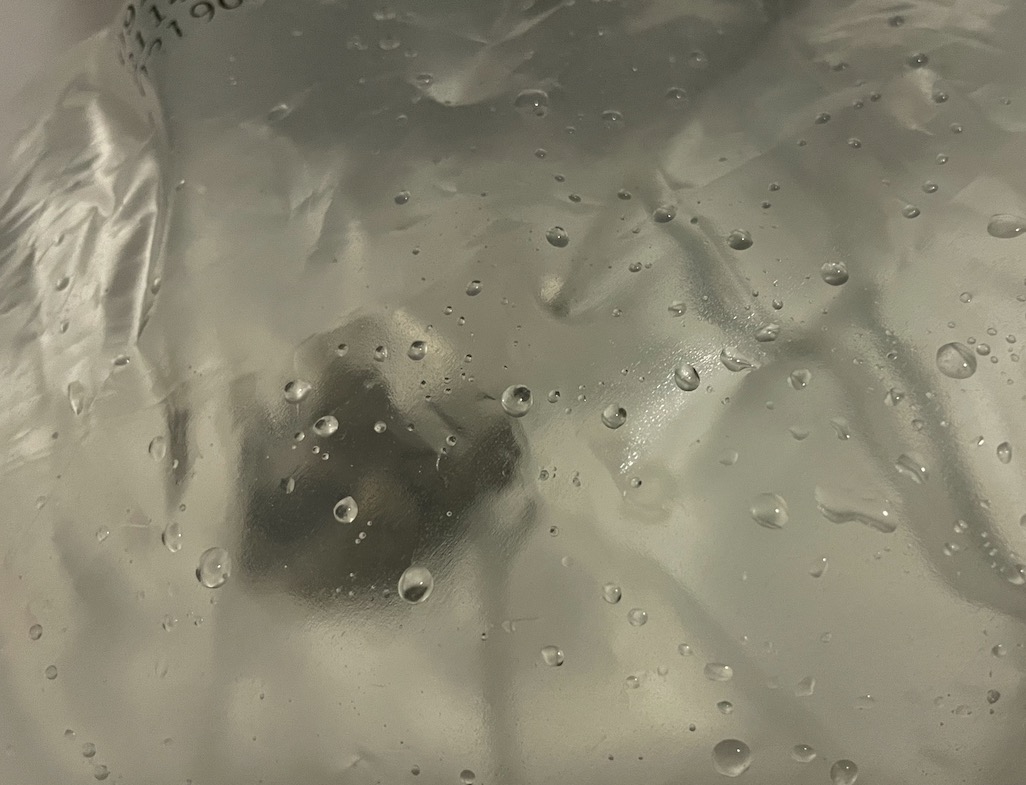

Okay folks I washed my bag first with tap, then with distilled.
I refilled it with freshly mixed xtol but this time, oddly, I got these tiny air bubbles that are kinda stuck to the plastic walls.
Really hard to get them to move up to the exit.
Any advice? 😅

RoboRepublic, the few winebags that can still be refilled in the U.K. tend to be those that are silvered on the outside rather than transparent so you can't see if there are any bubbles on the inside. I had always assumed that if there were bubbles then as you filled the bag and then pressed it to bring the liquid to the neck any bubbles wouldn't stick to the sides but be moved towards the neck and simply burst but your experience with a transparent bag has made me wonder if I had bubbles as well but just couldn't see them
However if there were such bubbles, all I can say is that they didn't seem to affect the life of the Xtol in the bag
The amount of air trapped in a wine bag after getting out what you can (including those small, "stuck to the plastic walls" in the photo previous to the post I'm replying to) will contain too little oxygen to have a noticeable effect on 5L of Xtol (or EcoPro or XT-3). What causes issues with bottle stored developers (and not just the ascorbate based ones) is opening the bottle, pouring out developer, possibly pouring in replenisher or pouring back used developer, and closing the bottle again. This refreshes the air trapped above the liquid in the bottle.
You're still better off with a 2L beverage bottle or wired stopper repurposed beer bottle etc. than with an accordion bottle, because the materials are less permeable than the plastic used for accordion bottles, but best is a container you don't have to reopen to pour off stock solution (or replenisher).
I'm doing mine in what I believe is the best manner for a home darkroom: working solution in PET beverage bottles, filled near the top, and stock/replenisher in wine bags. The stock solution will quickly remove the oxygen from the relatively tiny bubble I couldn't get out, and no more oxygen will get in. The tank solution is used repeatedly (and gets oxygen exposure both due to bottle opening and refilling, and while in the tank actaull y working), but is replenished at a rate that offsets both the aerial oxidation and that due to developing silver in the film. And if it's not used for a period of weeks (as sometimes happens; working full time and commuting near an hour daily, plus honey-do activities, eat into my free time pretty badly), there's no additional oxygen entering that PET bottle.
