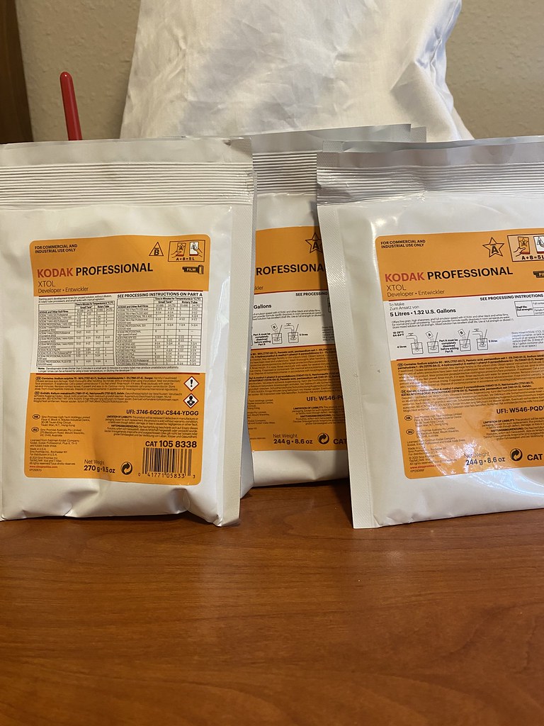

Ok. The HC-110 is gone. The Rodinal is gone. I have three one liter bags of the Film Photography Project FPP-76 left and when they're gone, I'll make the change. If it disappears in the next year, at least I'll have had a chance to try it. My only question is, will Xtol allow me to develop two rolls in a single tank at a 1+1 dilution?

Philippe-Georges
Apr 11, 2005
2,680
Flanders Fields
I have a SS 800ml tank in which fits two 120 reels. As I always use XTOL at 1+1 this means 200ml XTOL per roll.
To my personal experience, Hp5+/120 needs 14 min. at 20°C in this dilution.
If Kodak's XTOL disappears there is always ADOX's XT-3...
PS: the packaging of the XTOL you shows is rather strange to me, the XTOL I have is packed very differently, but mine is made in Germany...

I would like to try XT-3 but Adox products are often unavailable in the U.S. Initial reports had availability of many items in stock by the end of November but sites like Freestyle Photo in California no longer show an expected date.
I’m not surprised the U.S. and the EU packing are different. With Kodak darkroom chemicals being made by a number of different companies and an unknown future with Sino Promise in bankruptcy.
If all else fails, I have the makings for Cafenol.
madNbad
Sep 25, 2020
1,402
Portland, Oregon
I noticed in your photo of the XTol packages that they are marked with different weights (270g and 244g).
The “A” package is 270g and the “B” package is 244g. The “B” package must have flipped to the front when I propped them up.
