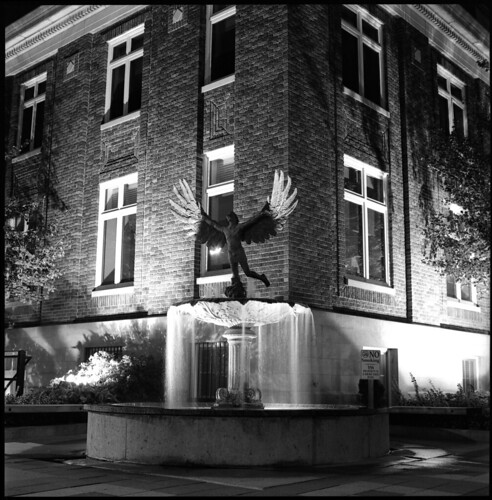

This is a 3200iso TX photo I pushed with Xtol:
You can see it full sized here:
http://farm3.static.flickr.com/2165/1549145509_fe559d58a3_o.jpg
I thought it handled the shadows pretty well for being night time.

Luke: Re "This is a 3200 ISO TX photo I pushed with Xtol", what were the dilution, temperature, and processing time length?
Terry
This was developed in Xtol 1:1 @68F for 15.5 minutes.
