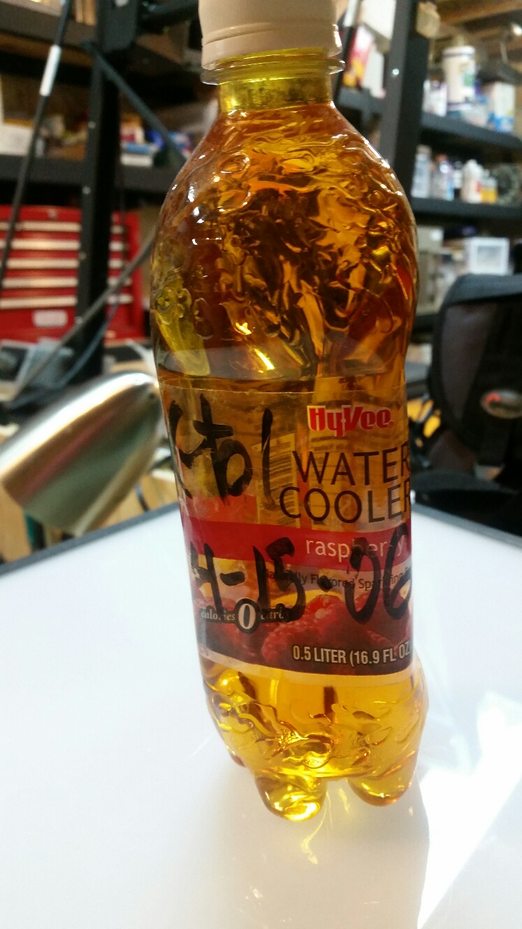

OK, so I have a bottle of XTOL stock solution. I mixed this with RO water on April 15, 2006. It got mixed into some other stuff when we moved. I found it a couple years ago. I thought boy that stuff is brown. So then I think I should wait until it's 10 years old and try it. Well it made it to 11 years and 2 days.

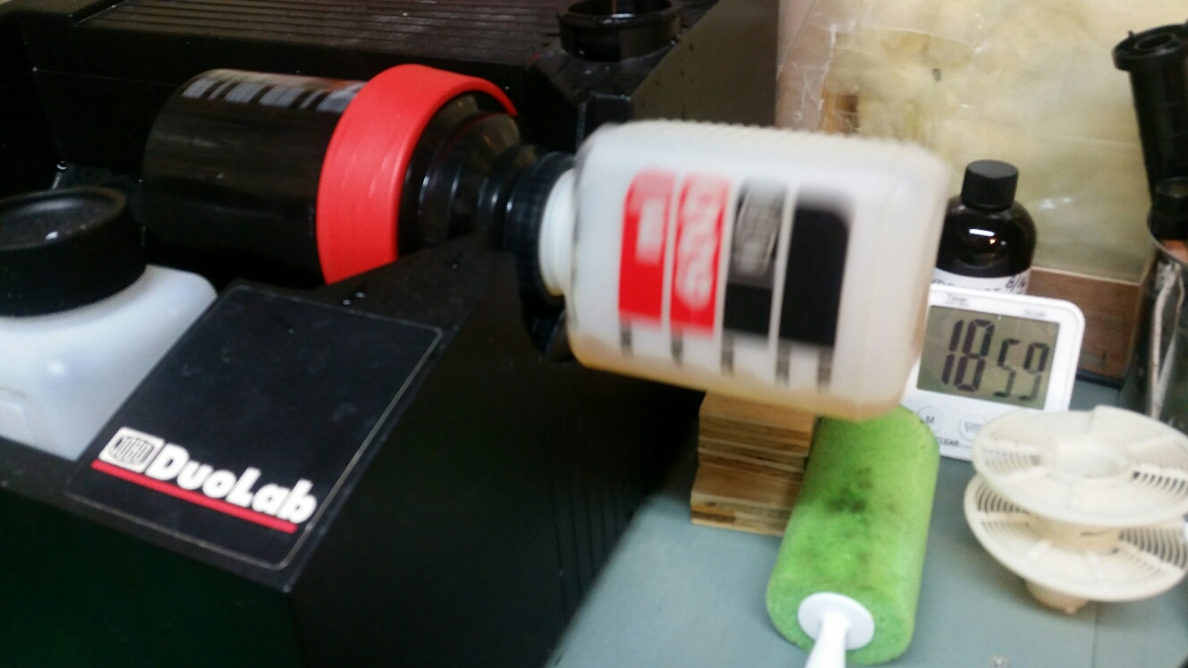

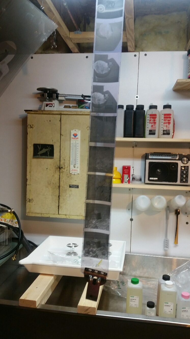

I had a crappy day at work. So I had to prove the impossible . Note brown XTOL, with date. 2nd photo, miraculous Jobo Duolab processor at work processing film. Final photo test snaps on TMY2, hanging to dry. So the moral of the story, even in PET soda bottle, if you squeeze all the air out of the bottle XTOL lasts, well like 11 years. Your Mileage May Vary. I'm SO HAPPY:D:laugh::smile::tongue: Mike from Iowa City

Why your XTOL was not "brown", just a bright yellow. I have seen "fresh mixed" developers that yellow. Congratulations on having the, should I say "guts" to develop a roll of film in eleven year old developer and thank you for letting us see the results. What is RO water? When I mix mine, it will be in distilled water then poured into a bottle, plastic. with no room for air and at that time I will know that I or someone will have usable developer for maybe eleven years thanks to you........Regards!

I was shocked, the negatives look normal. I thought it would be a clear piece of acetate. I've used XTOL that was well over a year old. But this was fascinating, I am a fanatic about topping off bottles. I guess it works

That's what mine looked like I added about 50% to the development time but the negatives look normal. I will try to get a print later this week. I would like to see someone make a print with an 11 year old ink jet cartridge.

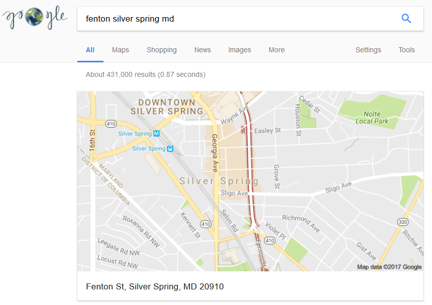

Fenton is a street in Silver Spring, Maryland.
