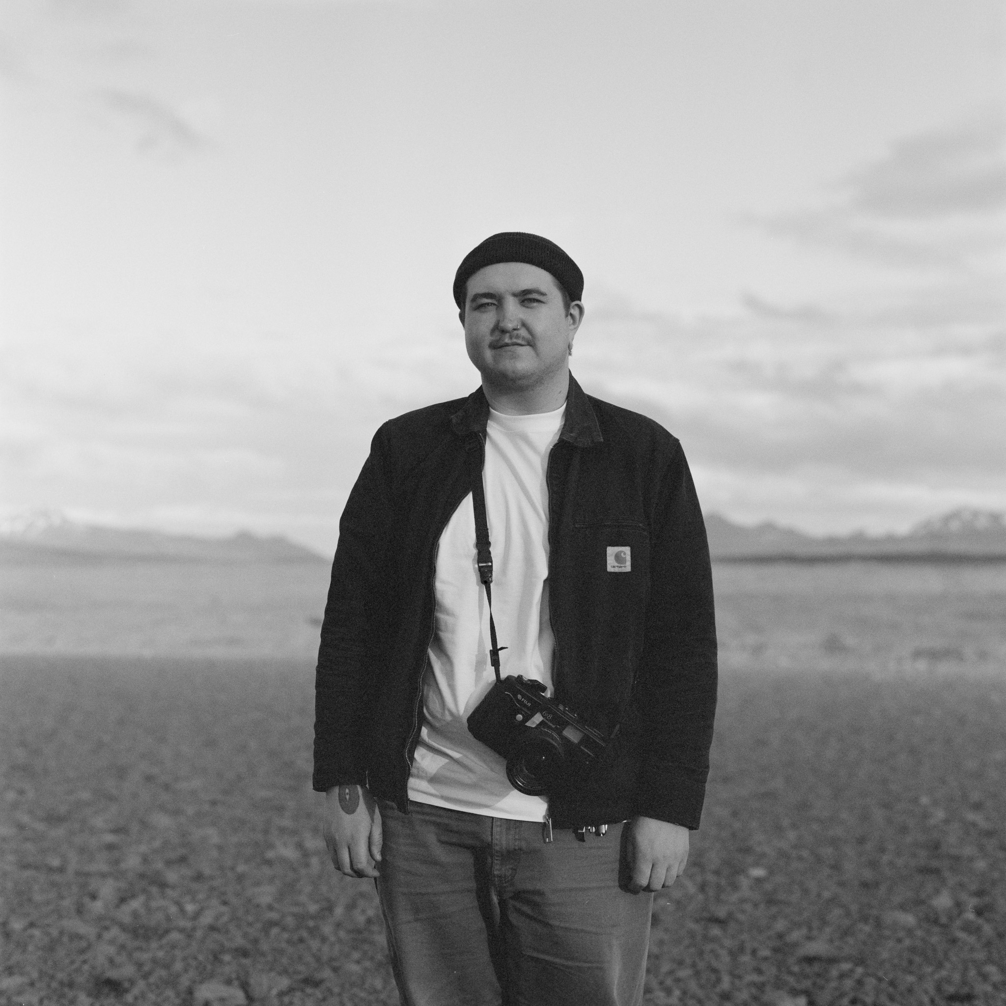

Hi everyone. I am just kind of curious. I have been running Xtol 1 to 1 in my darkroom for years and years, but during the time of troubles for xtol, I decided to give XT3 a try as it sounded like a great drop in replacement. Indeed, the mixing was much better. I will say, however, that my first impression is that it is grainier than I remember from Xtol. Does this conform to other's expectations? Right now I don't want to make any solid conclusions because it could have been a roll that was heated or otherwise damaged at some point, but I felt like a recent 6x6 roll I shot was quite grainy for the film (TMY2). I have mostly been using 8x10 and 4x5 recently, so perhaps it is the shock of going back to a small format, but it does seem grainier than most of the 6x7 I shoot (which I do more regularly). Has this been the impression of anyone else? I am basically using the same processing as I did for Xtol -- 1 to 1 at 20C in a Jobo ATL for 9 minutes 15 seconds (for TMY2). I am attaching a portrait where the grain is quite visible. Just curious to hear others' impressions, or if they have any advice. Particularly if they had to adjust their times or other variables to achieve what they were getting with Xtol.

I haven't made any controlled comparison test (yet : ) but I used XTOL for many years and switched to XT-3, and didn't notice any change in grain.
something definitely seems off in your example of 6x6 TMY-2 in XT-3.
I usually get less grain using Tri-X in XT-3.
could indeed be outdated film, and also looks somewhat under-exposed.
how does the negative look like and how was it scanned?

I see, it sounds you have a lot of experience to track down issues then.
for me the image looks like it could be a bit underexposed, like the camera body doesn't really separate from the jacket for example.

Those were my thoughts as well. The grain in the bright areas of the image doesn't look bad.

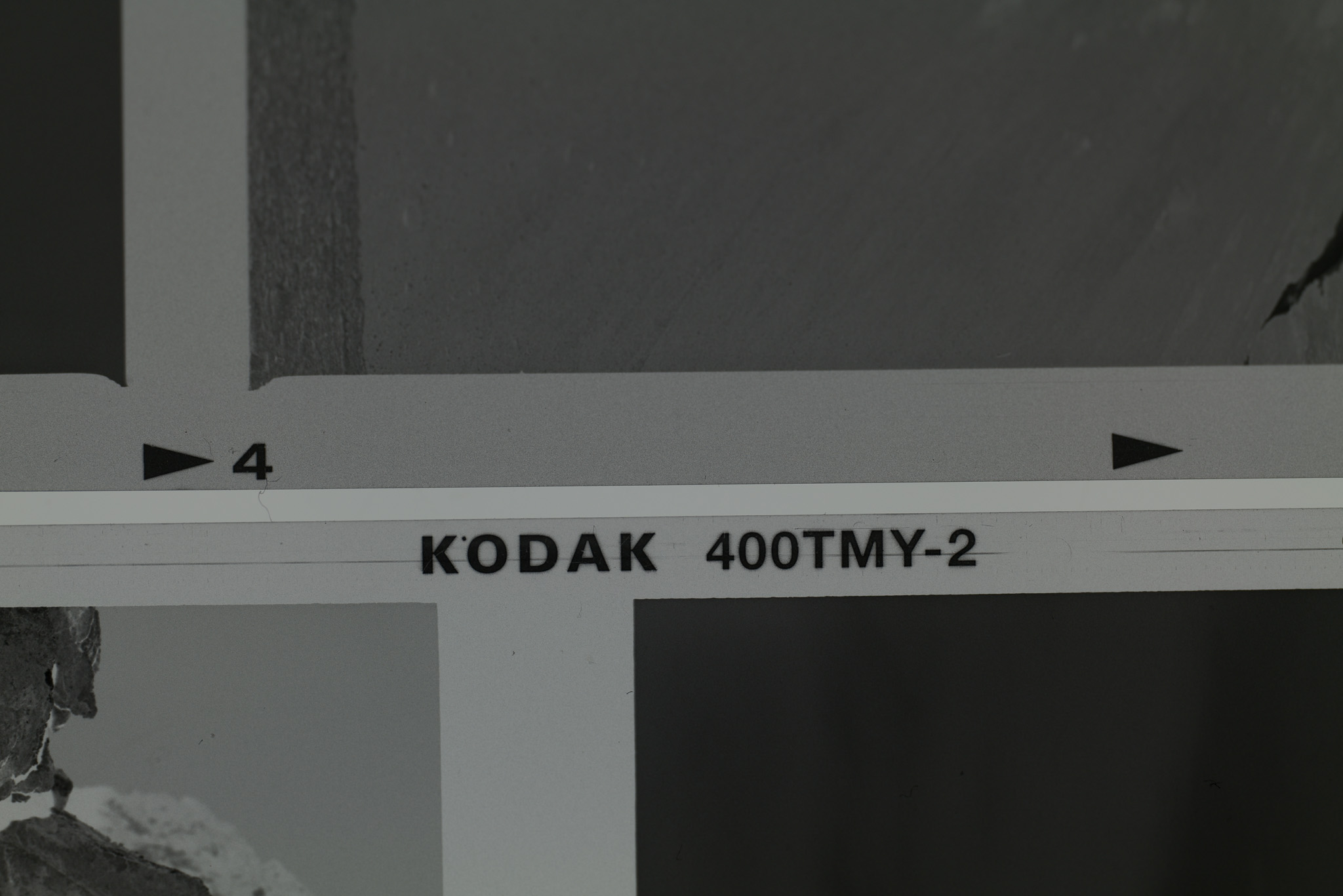

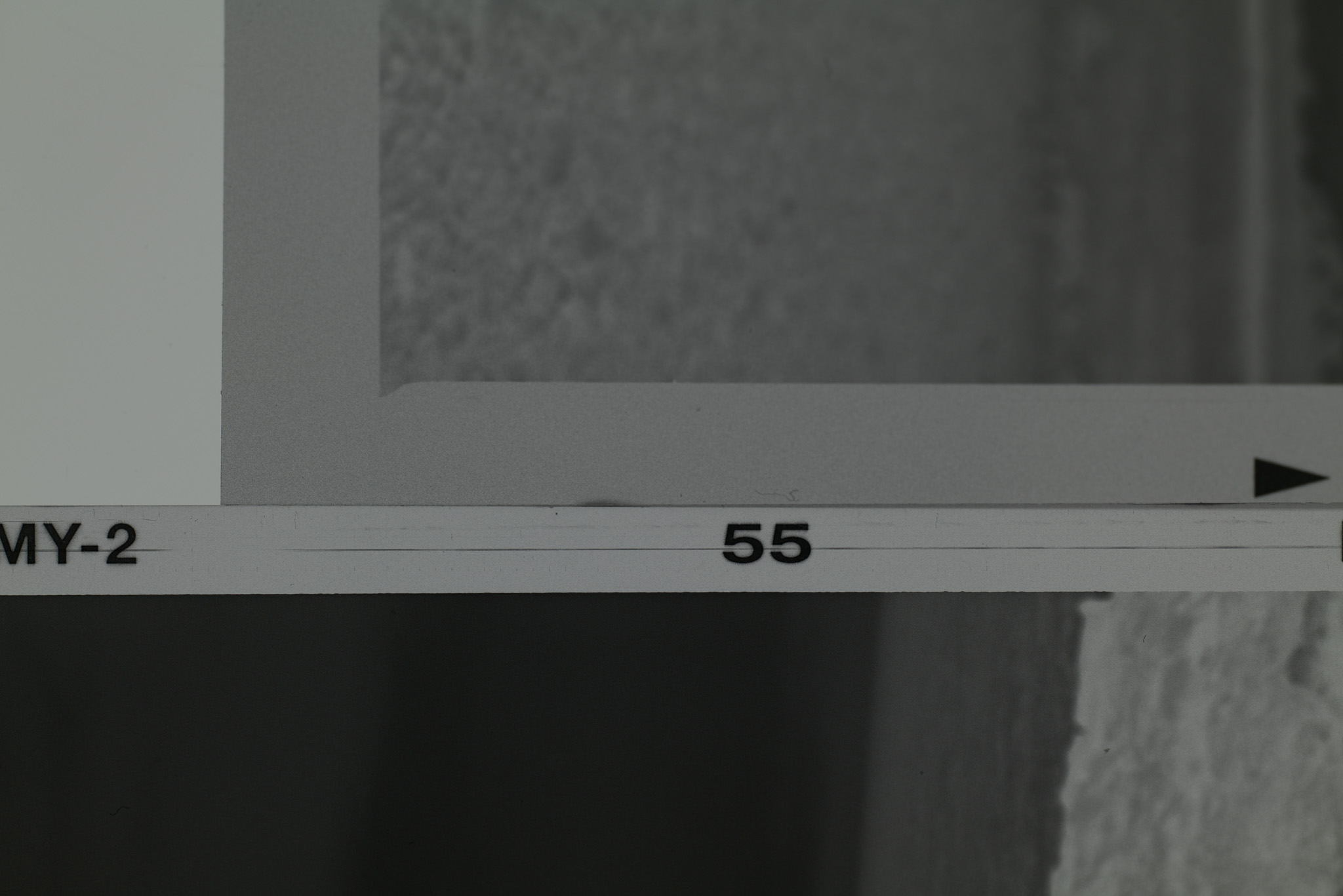

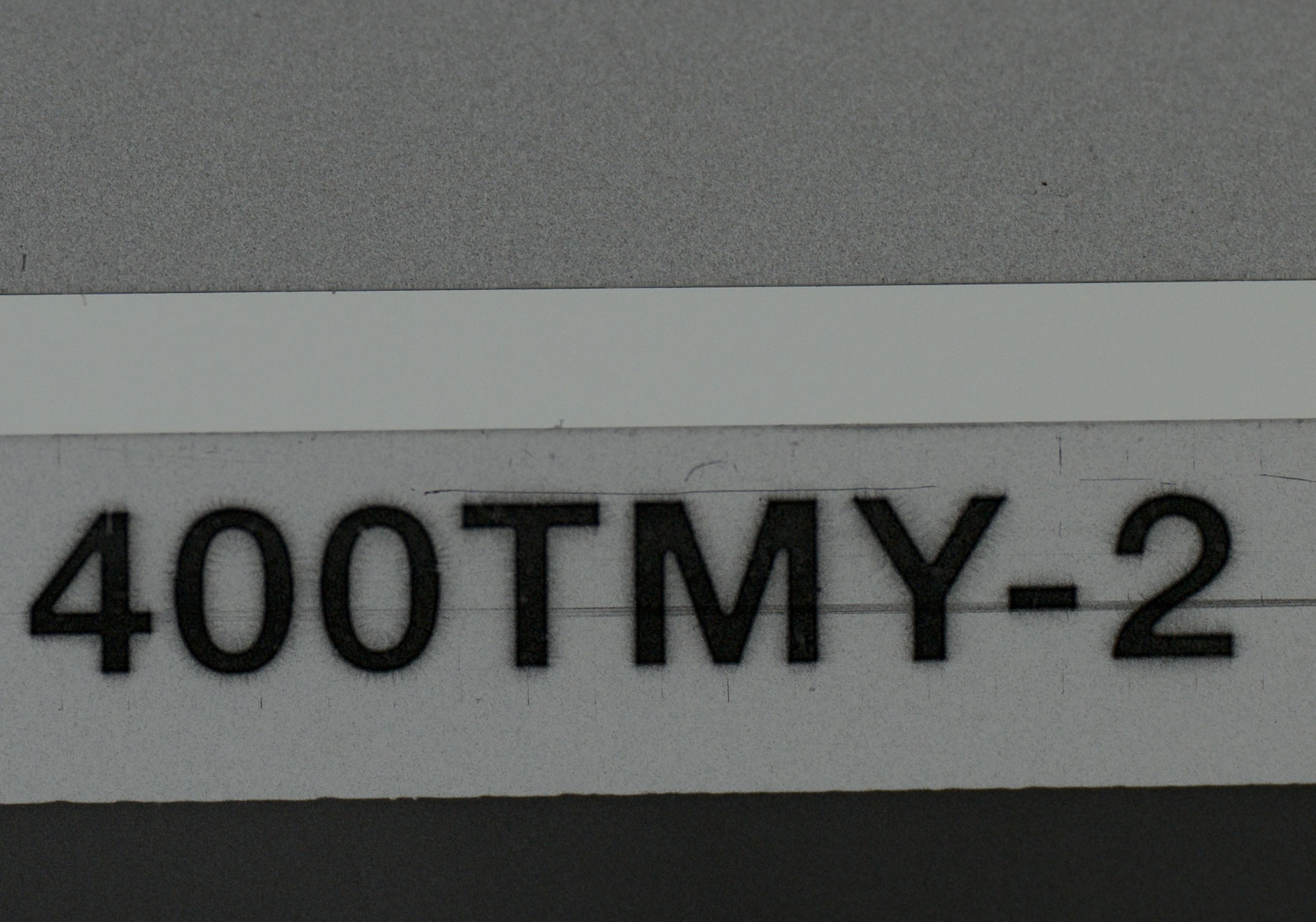

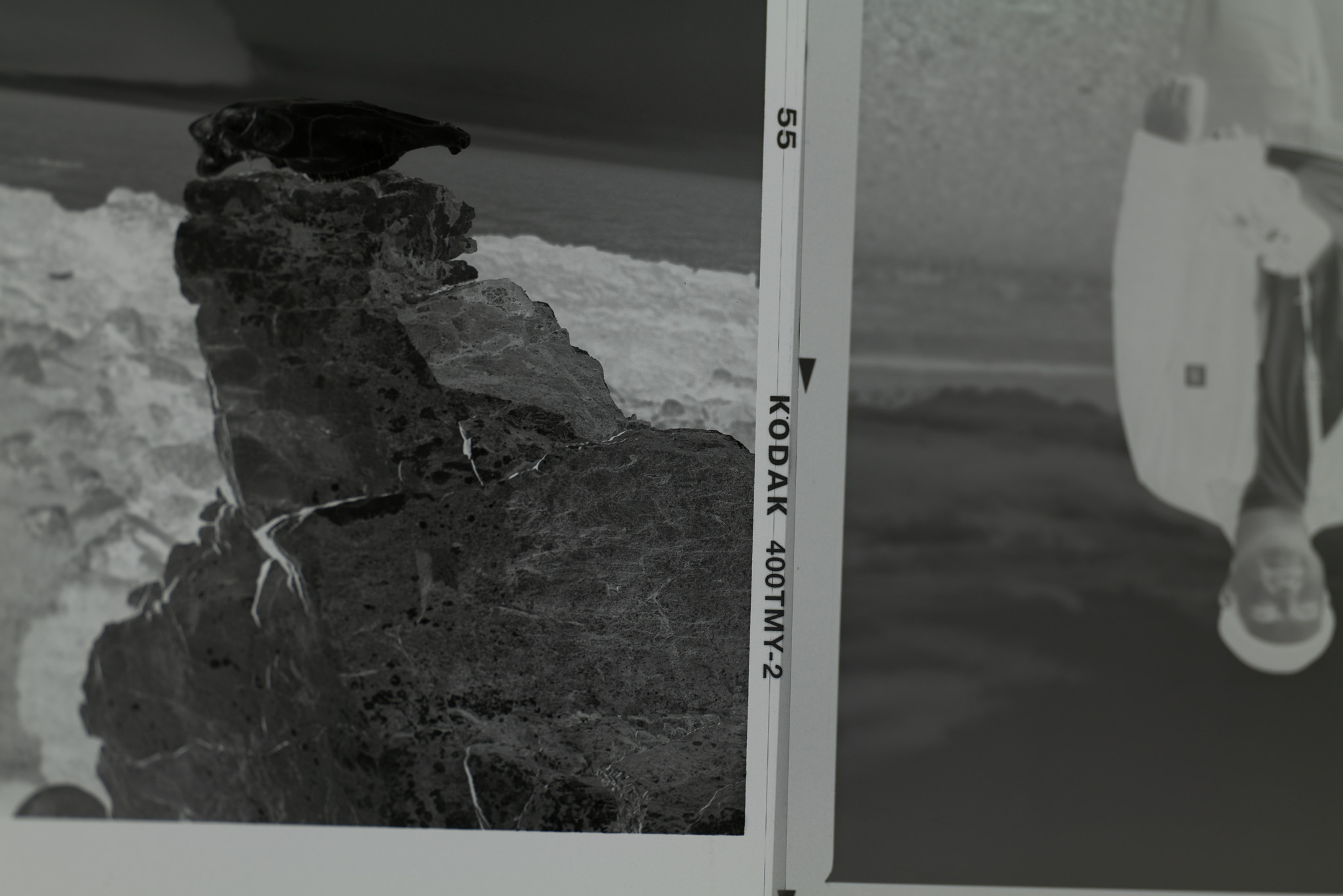

Hello all. I am sorry I did not come back to you all earlier. I just was on a month long residency and have been busy. I was able to take a picture of the grain and compare it to an older roll of TMY2 in Kodak Xtol from 2017 when I was burning through a ton of film and developer, and when Kodak chemicals were still reliable. The difference is stark, but the emulsion of the film is much darker, so it strikes me that this film was exposed to heat. I am not sure if that would increase the grain too, however? Any thoughts. The jacket is dark, but in my experience Tmax is not nearly that grainy even when underexposed. I looked at an 8x10 sheet that I developed with the same batch of developer and it was also comparatively grainy and a bit dark, but that might also have been mistreated. For me to rule out the film I will need to buy a fresh batch and see how it comes out.
For the pictures, the more recent roll processed with XT3 is on top. Apologies if they are not perfect. I did not have time to scan them or even set up a tripod. But they are 47mp with a 105mm Sigma Art macro, so they should be sharp enough to judge, at least to some degree.

koraks
Nov 29, 2018
26,145
Europe
No, that can't be it.
Looking at the high level of fog, this really looks radiation-related. So either very old film, or exposed to CT at some point in the supply chain.
There has been a similar problem with parallel import Portra in China recently.
Fog level is absolutely also developer related in general and in this case too imho. Bigger grain is also a consequence.
All in all I'd stick with original Kodak Xtol.
