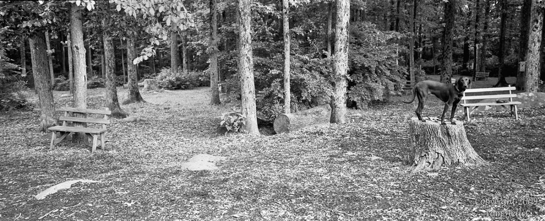

Super interesting question. Here I am just working with my old xpan, and I get a pretty neat result. Take a look at this picture, not mods', and it looks as if it was shot via a T/S lens....
