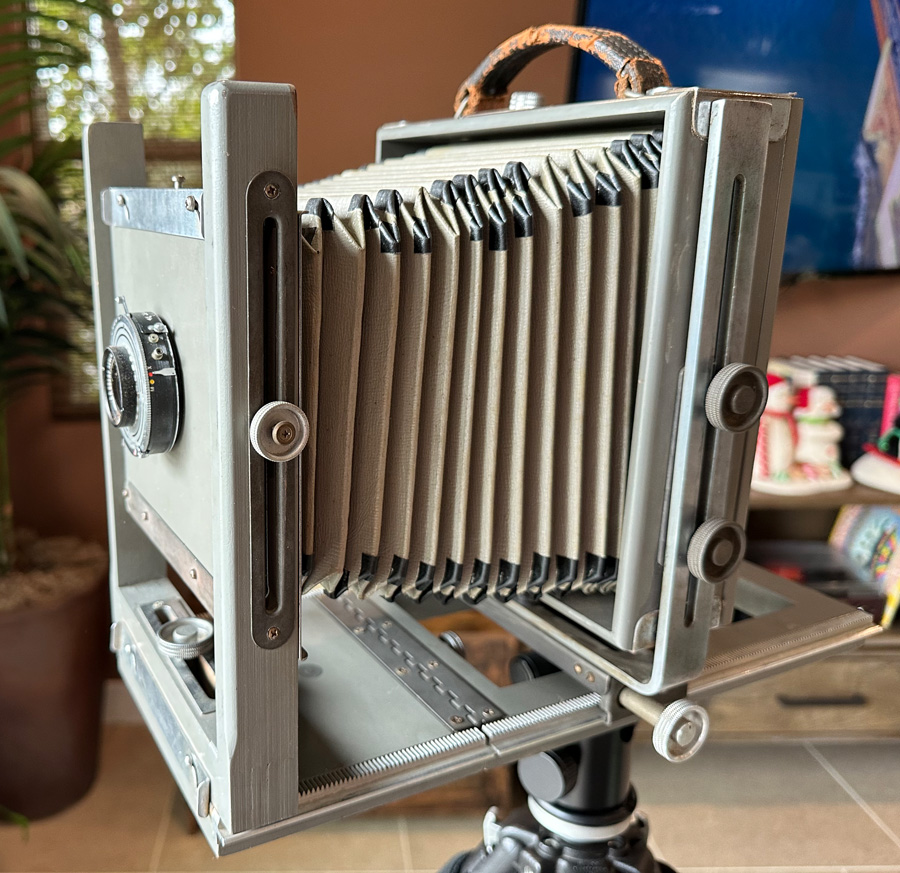

For Xmas my wife gifted me a Burke and James View Camera from a curio shop. Came with a 4x5 and a 5x7 film back and a Dagor lens. Everything seems to be in pretty good condition except for the bellows which has been heavily taped and still has maybe 15 leaks. I found a replacement bellows for $150 that looks like it will work, but I will have to figure out how to replace it. It looks like that will be a messy job. I have a number of questions. If anyone would like to field any of these questions that would be much appreciated. I'm including a number of pictures.

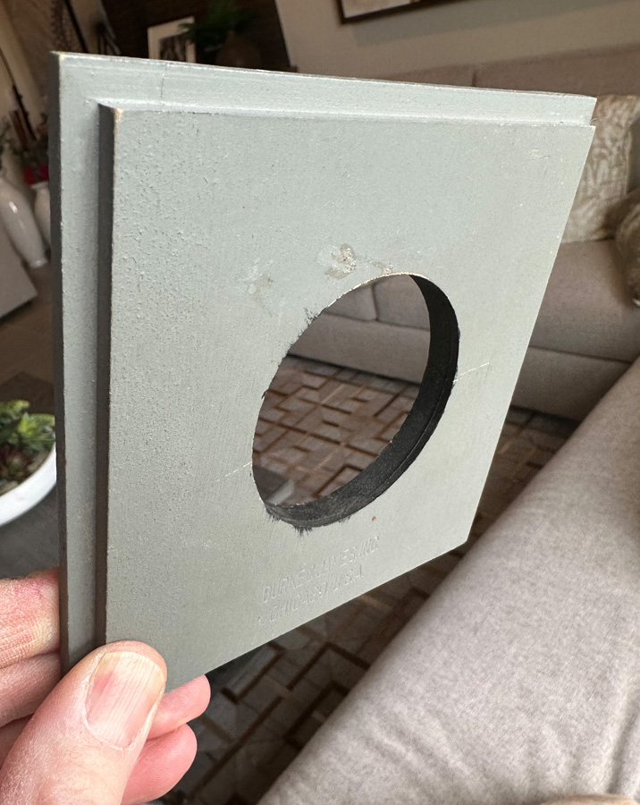

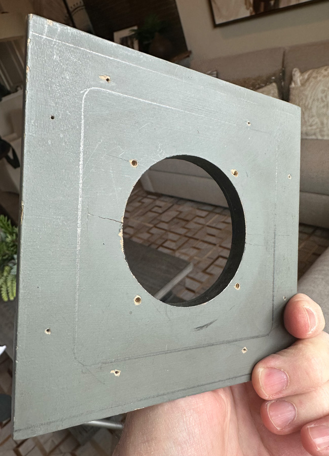

A) I am showing the lensboard that came with. The opening is 2 3/8" across and the thickness is 3/8". The lens I show is about the 35mm equivalent of a 45mm lens, so I would like something wider as I principally do landscape work (or play). What can I get that will work with this lens board or do I need to go with another lens board? I can see that a different type lens board was mounted on with the inner skrew holes, but I can't see the purpose of the outer skrew holes.
B) The bellows should probably be replaced. Any pointers or tips on how to proceed?

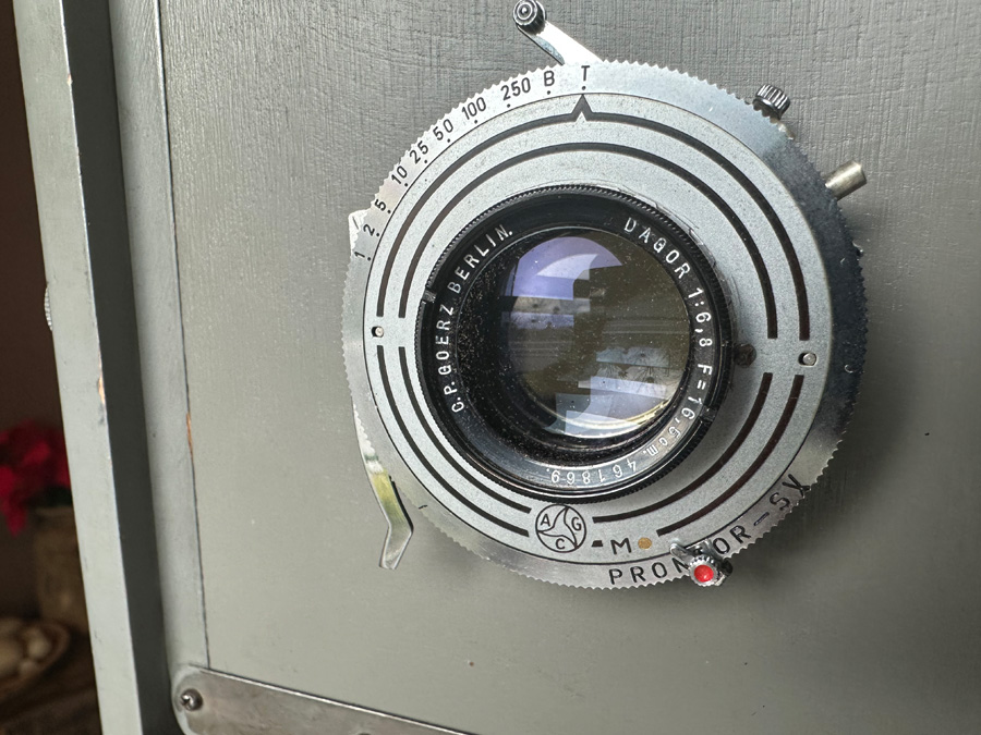

D) The lens appears to be in good shape. Very interesting. It is a F6.8 Coated, Color Corrected C. P. Goerz Dagor made in Berlin. The focal length is 6.5" or 165mm which seems to be about the 35mm equivalent of a 45mm lens. Printed on the lens is "Dagor 1:6,8 F=16,5cm" ( I guess they use , instead of . ) and then the serial number. I've never seen a lens like this, because I only do a bit of LF work. I thought it was broken till I figured things out. On the bottom is a lever for delayed shutter release - very cool. There are two apertures: One that is adjustable and the other that opens and closes with the exposure. To keep it open for composing and focusing you have to set the lever to T setting then cock the shutter and release exposure. Then you compose and focus and adjust the adjustable aperture to your choice and then move the shutter lever from T to B and then to the desired speed setting and then cock the shutter and release. Took me a bit of figuring because I've never seen a lens like that. Any guestimate on the quality of this lens ( I haven't shot anything yet ) and the dollar figure for this item? Wife picked the whole thing up for $150. Came with a rather worn leather satchel.

F) Also the lens has a PC sync and a lever to go between X (red) or M (yellow). I won't be doing much flash work. I noticed a red dot on the shutter speed dial at about the 1/25 second setting. Is that the sync speed for X sync strobe work? I thought these sort of lenses synced at all speeds. Should I be concerned about setting that to X or M? Will it matter for landscape? I'm guessing that the M and the yellow dot by the delayed shutter release indicates that it should be set to M only for delayed shutter use.
G) Also, just wondering about the icon on the lens that says A G C in a spinning wheel. Ever seen that? Know what it means?

First of all, congratulations on a fine acquisition. Easiest question first: AGC stands for the Alfred Gauthier company of Calmbach, Germany. They made many shutters under several different brand names. And the Dagor is a very good lens. Wooden lensboards are easy to adapt just because it's woodworking rather than metal working. Yours looks like there has been an adapter plate mounted on it at some point, hence the screw holes in the face. I use birch plywood from Blick or Tower Hobbies when I make up a lens board. A nice set of hole saws will come in handy.
The bellows should be fairly easy to replace too. Study the mounting system on the existing bellows and you'll get a good ides of how to mount new bellows. Many field cameras used frames to which you'd mount the bellows (usually some extra fabric on the ends of the bellows that wraps around the frames) and then screw into the front and rear standards. Where are you getting your new bellows?

Lens boards are easily made, just need a miter saw, some hole saws, some thin board (MDF is fine) and some thin adhesive black foam. If you cant do it not hard to find someone who can.
Lens is nothing special, but will do the job.
Check the bellows in the dark with a torch, small holes can be patched if it needs replacing there are places that will make custom sized bellows. I have gotten 2 made by a Chinese ebay seller.

I've bought bellows from Rudy (AKA "Etone") in Hong Kong. Sandeha Lynch, in Wales, used to make very fine custom bellows (though I dimly recall that he was cutting back...) and I'm pretty sure there are others in the US and UK doing that work too. Other people here will have suggestions, I'm sure.

Time for my yearly-or-so plug for 3M 850 Polyester Tape (Black). It comes in many widths, but for bellows that are holey but aren't falling to bits, 3/4" is good. It's expensive (~40.00usd per roll on evilBay) but a roll lasts a looong time. The stuff is light tight, sticks to anything, is so thin it doesn't affect bellows folding at all, and lasts for years. I've used it for quick repairs on every folding camera from 127 roll film up to 11" x 14". Even if you get a new bellows, this'll keep you shooting while you wait for it to arrive-- I've learned the hard way that bellows are camera rather than format specific.

I'll suggest painting your lensboards inside ( the side facing the film) flat black to cut down on stray light bouncing around in there.

Black book binders tape is much cheaper and better suited to bellows repair, two inch width handles many jobs.. I've repaired several old LF camera bellows and re taped film holder hinges with it.

Should you ever decide you want more than the industrial gray look many of these have absolutely beautiful wood under the paint. A project to strip them but once done you have a unique beauty that is functional.
