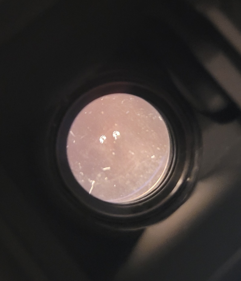

I had a Rolleiflex w/ a Xenotar w/ pretty bad coating issues. This is something to look for on these lenses. However, even w/ the coating issues, that Xenotar was the sharpest lens I had. The Planar is great for sharpness corner to corner even wide open, but the Xenotar lenses are probably sharper.
Here's what that looks like. It can often be confused w/ separation if it gets too far gone.

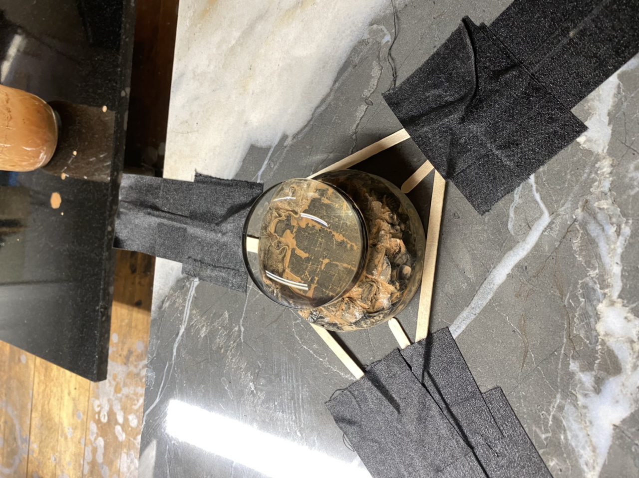

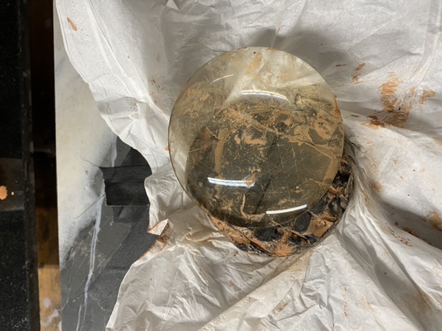

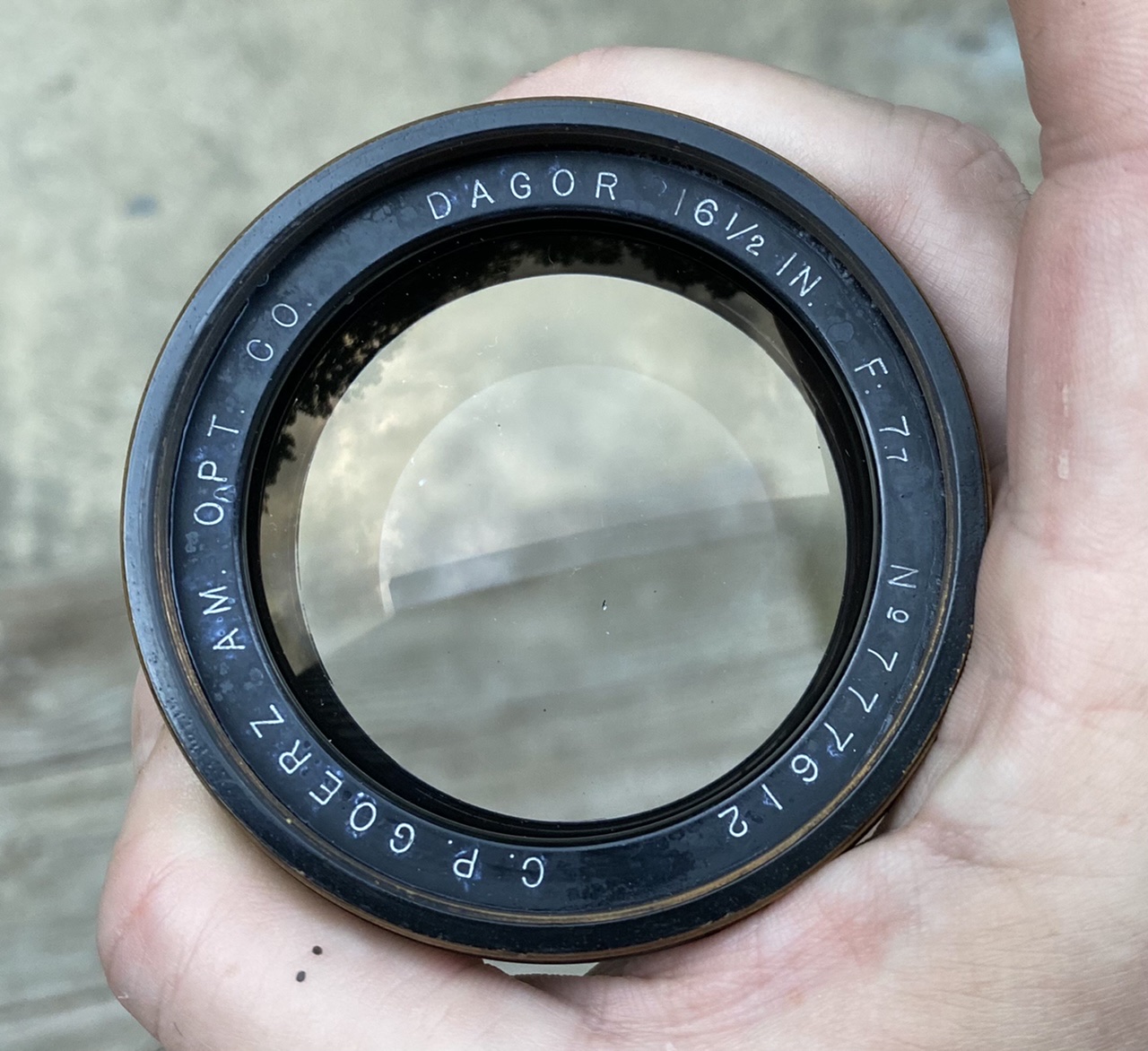

Yes I’ve been repairing balsam separation and coatings on the side of my side business, but have not advertised it widely or I would get swamped. Last job was a 16 1/2” focal length Dagor (both sides) and a Planar taking lens before that. That Planar had a flat bond surface too btw. Right now I’m working on a couple of lenses with bad coatings that I will strip off and send to one of the optical shops I do business with to have recoated.
Here are some pics I grabbed off my phone on recent jobs that I share with the owners, since it takes a few weeks to separate the elements not to mention working it into my schedule. Many of the owners are here on photrio or the large format photog group.

Here’s the lens I’m currently working on. Rear doublet of a Zeiss 165 f/2.8 Zeiss Tessar. It need the AR coating stripped, some surface haze polished out, and recoated. I repolished the surface this evening and will send out to the shop I use to put a modern single-layer coating on. Same coating performance as original, but more durable.

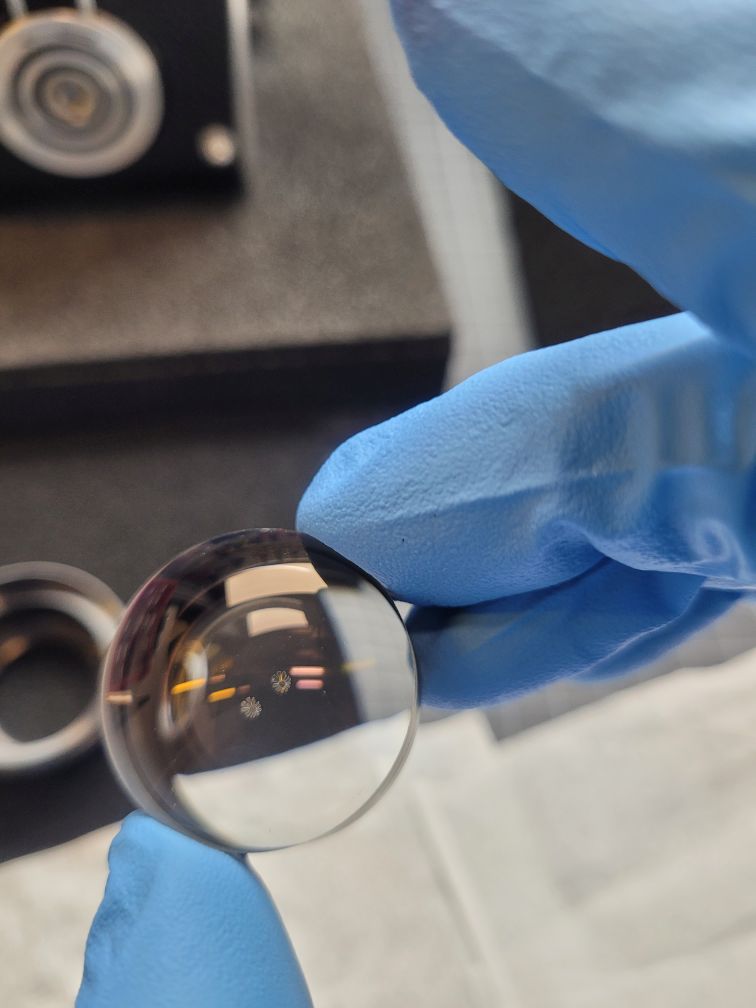

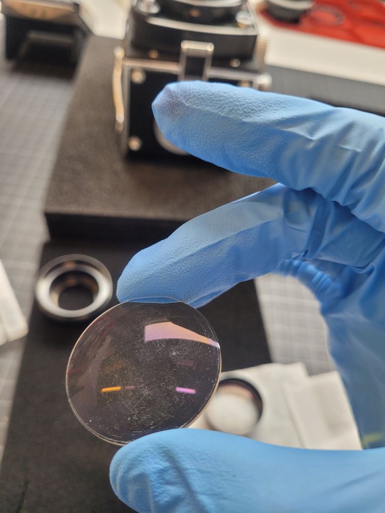

Hi, Just acquired a Rolleiflex 2.8C with the Xenotar lens. The viewing lens is perfect, but the taking lens has a lot of wear on the front coating and there are two weird "flower" shape defects right in the middle of the lens (see attached photos). I hope that these were just fugus which I could clean up after I disassemble the front lens group. However, I fear that they may be point seperation of the cemented second lens group. If that is the case, could someone re-cement and recoat the lens for me? The 2.8C was too good to bin so would like to put it back to use. Cheers! WK
That looks like separation to me, and I agree that the lens looks to be a good candidate for recementing and recoating.

I have taken the front group apart last weekend and confirm the defects (1st lens coating wear and two point balsam separation in the 2nd/3rd doublet).
I have emailed Foto Olbrich in Germany based on the recommendation of other Photrio members and they referred me to Dr. Prenzel in Optik Labor instead but with some stark warning regarding the risk of lens cracking during re-cementing and recoating.
Personally, I think the lens cracking warning is a bit overstated. The most dangerous part is probably heating up the doublet to separate the glasses. However, I believe that due to the flat gluing surface of the Xenotar lens the differential expansion stress should be minimal. There is of course risk of stress cracking during polishing, but I would assume any optical technician with reasonable skill would know to avoid that. However, it would be good to hear from someone who actually have it done before to see whether my assumptions are reasonable.
The other forum member has suggested someone from the Arsenal factory in Kiev as a possible place where I could have the lens re-cement and recoated. It is of course riskier to send the lens to Ukraine now there is a war going on, but I will try to contact them this week to see what thy say...
