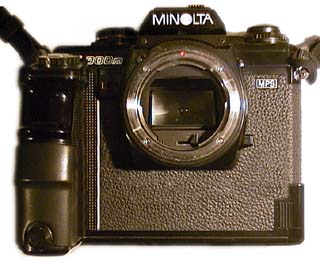

Found this pic of what appears to be an "X-900m"
Perhaps a prototype?

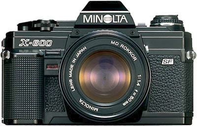

Anyway, are you aware of the Minolta X-600? It's sort of halfway camera between the X-series models
and the Maxxum 7000. It has an MD mount but also an AF sensor with manual focus confirmation. It was
made just before the Maxxum 7000 for the Japan market.

I had not herd of the X600 or X900m but that is interesting. The X900m looks like a X700 with a permanent motor drive 1 attached. I still have 2 X700 and Motor Drive 1 for each. Never had any problems with them but I bought them new and took good care of them. I also wanted a XK but they were too expensive back then. In later years I did get a Maxxum 9000 and still have it. Most of my new cameras are Nikon but still enjoy the old Minoltas. I was working on the Outer Banks today and walked out on the beach and shot a few frames with my X700/Motor Drive 1 and I like that combination.
I may be wrong, but the 'X-900m' looks to me like a what-if photoshop speculation. Certain aspects of the image around where the battery holder fits into the body don't look quite right.
