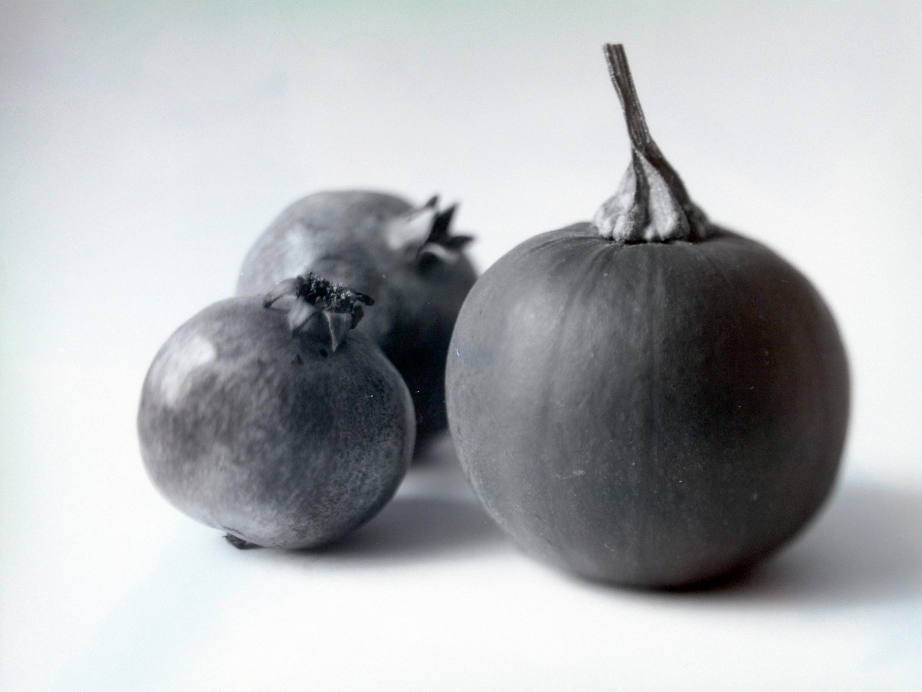

I got a box of 8x10 a couple of months ago and I love the stuff. I've just started experimenting with it as ASA 200 and I process it in Ilford paper developer under a safelight and develop through inspection. Here's what I shot. I wash it with a tray siphon. The emulsion is very soft so handle with care.

so basically, process it like a print? How long do you develop it for in paper developer?

Yes
With paper developer, it works faster than film developer.
