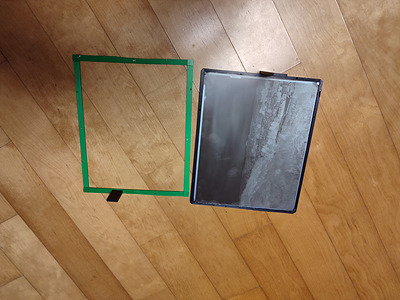

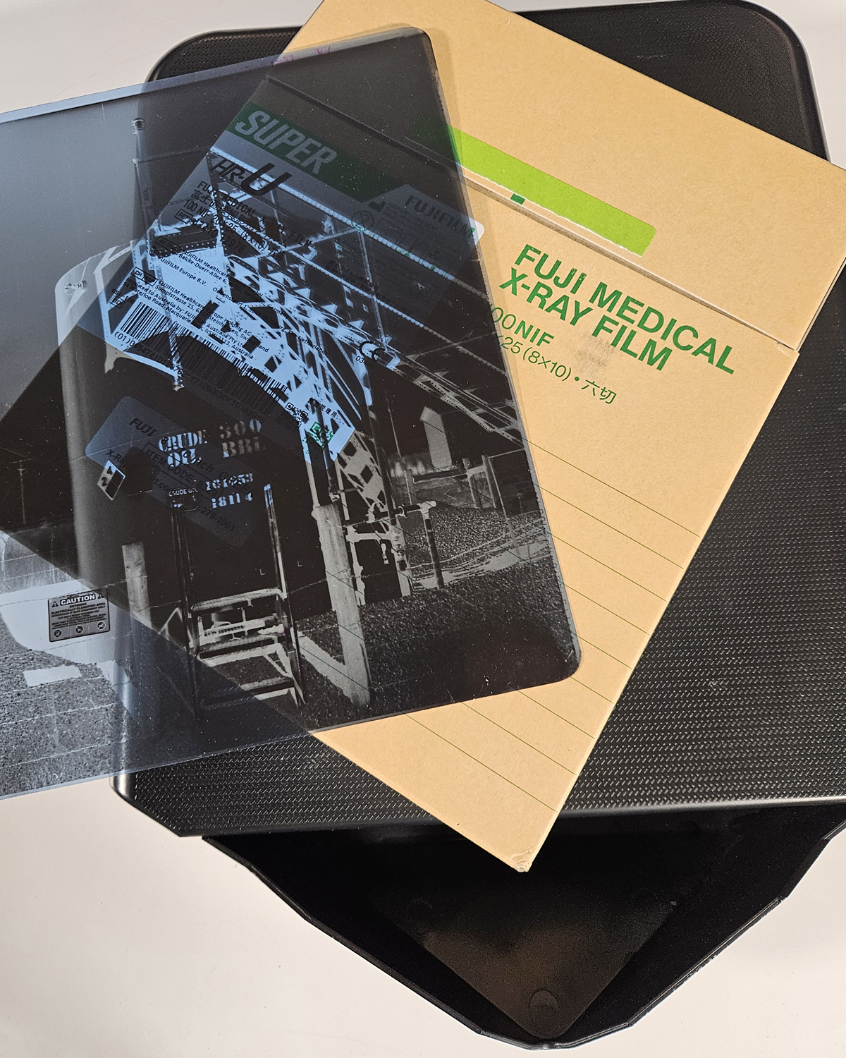

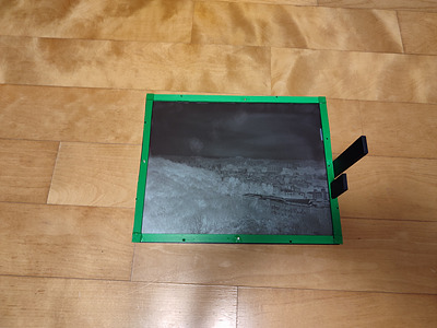

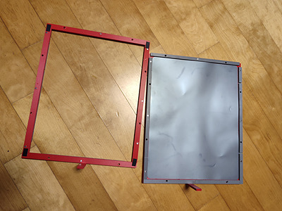

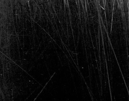

We've had numerous requests lately regarding processing X-ray film in our SP-8x10 Tray system. The appeal is obvious, it's only $0.75/sheet for 8x10. However, it has light sensitive emulsion on both sides and this raises two concerns:
  1. Scratching the emulsion on the bottom side.
  2. Getting enough chemistry under the film for proper development.
