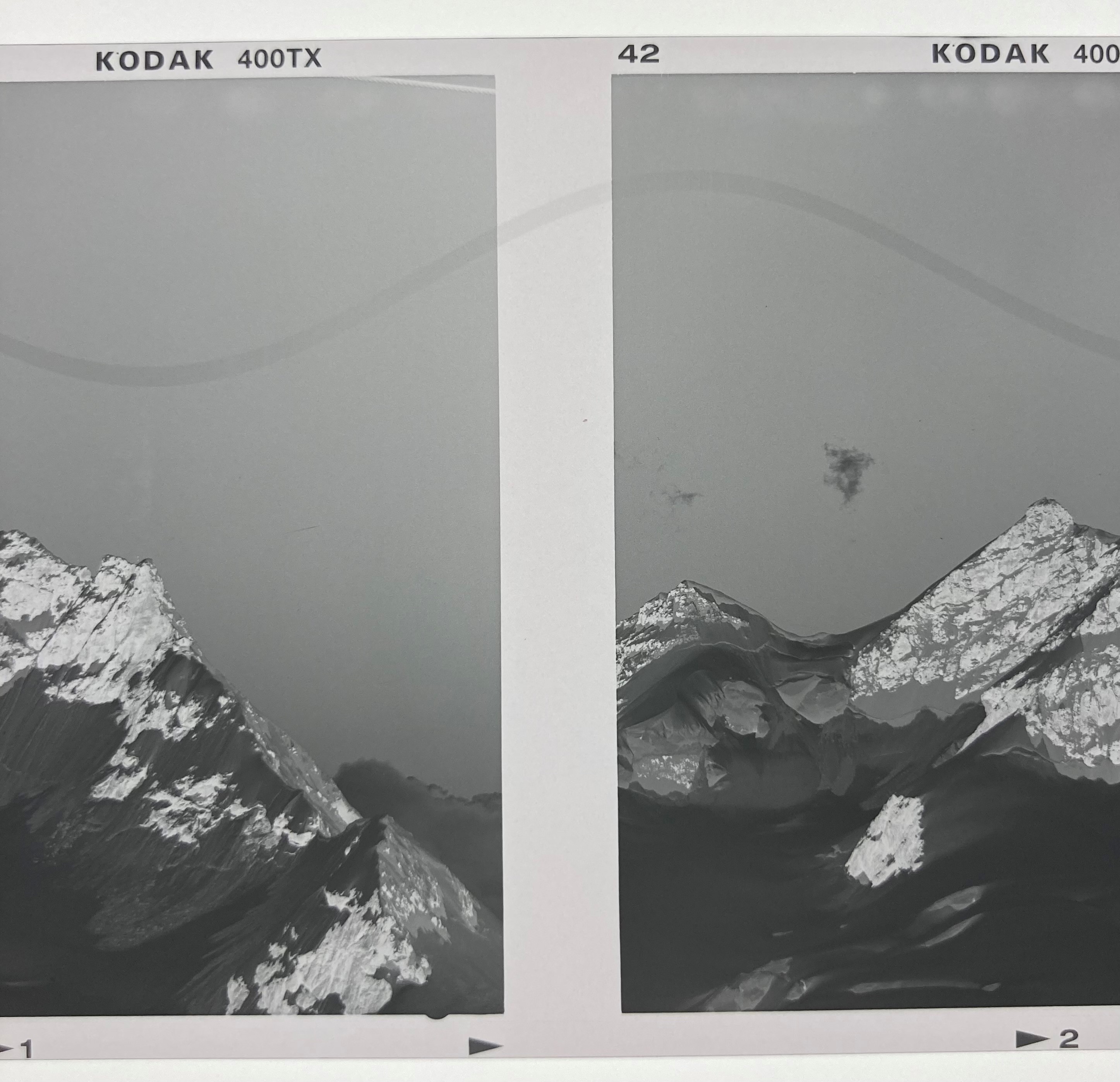

The attached negative scan shows a thin curved line running along the full length of a roll of 120 Tri-X. It was scanned by x-ray on my outward flight and to avoid the possibility of encountering a CT scanner on my return flight, I instead sent it home by DHL, who informed me they only x-ray packages and do not use CT scanners. I travelled with 20 rolls of the same film and only two of them have this line. Any thoughts?
It looks close enough to images you find on the Kodak page - although that line is very very fine. It's rather difficult to see anything else (other than damage from the factory somehow) causing it. And it does have the look that, if it were spooled up, that line would be a "slice" (at and angle) through the film.
One could determine the x-ray wavelength from this probably :D
Looks textbook irradiation to me.
But what they didn't state was with what dose. It may have been more than your film preferred to have seen.
Very true but how would only two rolls out of twenty be affected?
