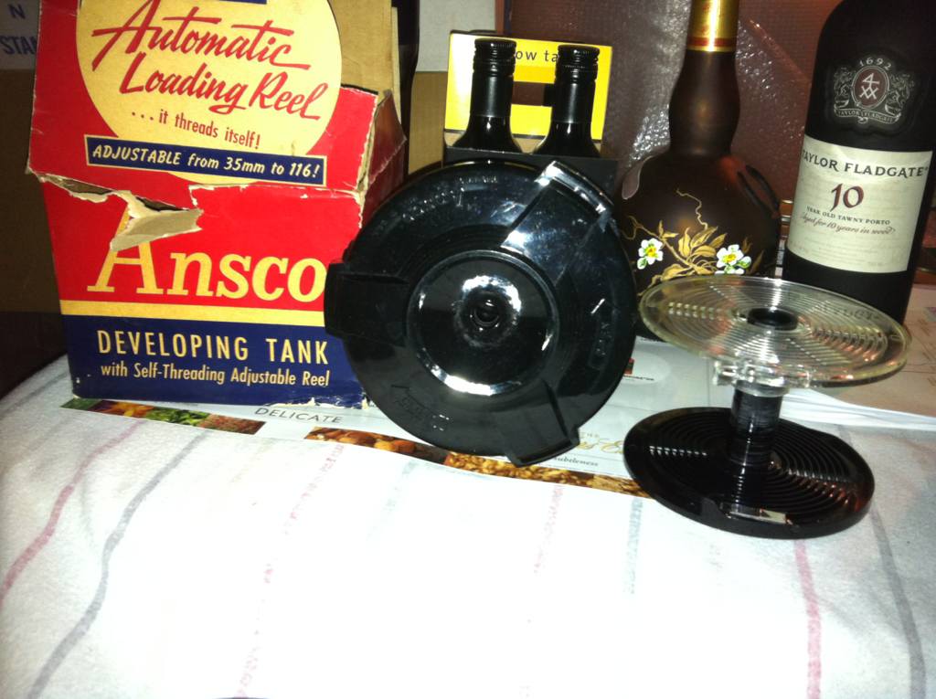

Denverdad, I just noticed on Xbay old plastic tank & reel adjustable to 116 format film. I have 70mm reel with 100" capacity but for 116 format films I was thinking about using this smaller tank or making my own from Paterson reel. What is your problem with "plastic"? I personally prefer Paterson over stainless steel any time.

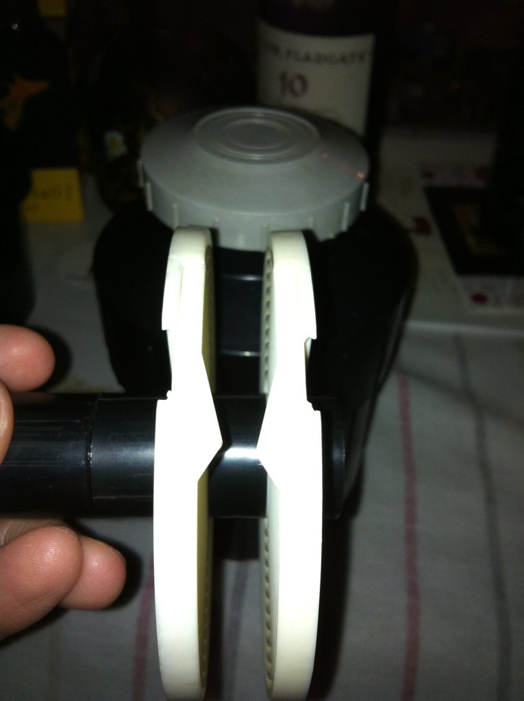

Hi Stone, I figured out the hardest part. Paterson core diameter is 25.5mm, wider centre hole on paterson reel is 32.5mm. Difference is 7mm. In my "project box" I just found 3.5mm thick copper wire. Wound it around centre core and it fits perfectly with wider centre hole of the reel and centre core. Now It looks like I have to glue top part to the centre core with crazy glue with 70mm film in the reel, to keep right distance. And even Paterson "loading" move is still OK. Only drawback is that I will have one Paterson dedicated reel and centre core just for 116 format.
Sounds like a plan, you can also just take 1 reel, then take HALF of the second reel, turn it around and stack them, for some reason the distance this creates is exactly 70mm which is just a coincidence, it works I've tried it, but when I learned this trick I had already owned a 116 tank so I've never used it all the way through so not sure now much agitation it can take. Good luck!

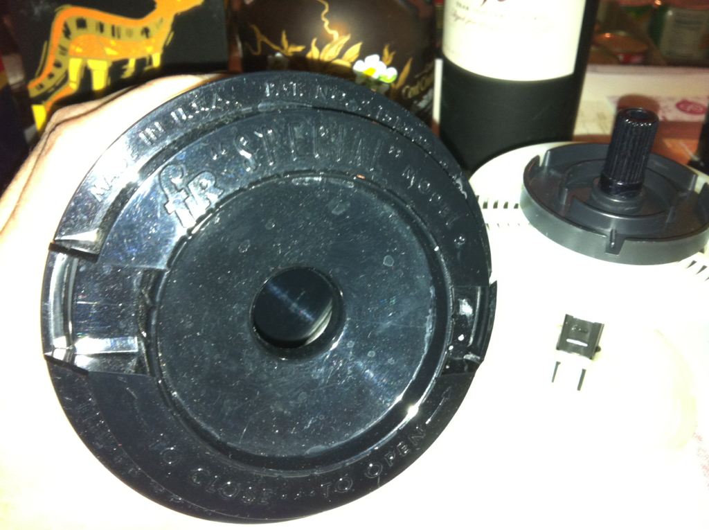

The FR I have isn't very good, it's VERY hard to load and I don't recommend it...

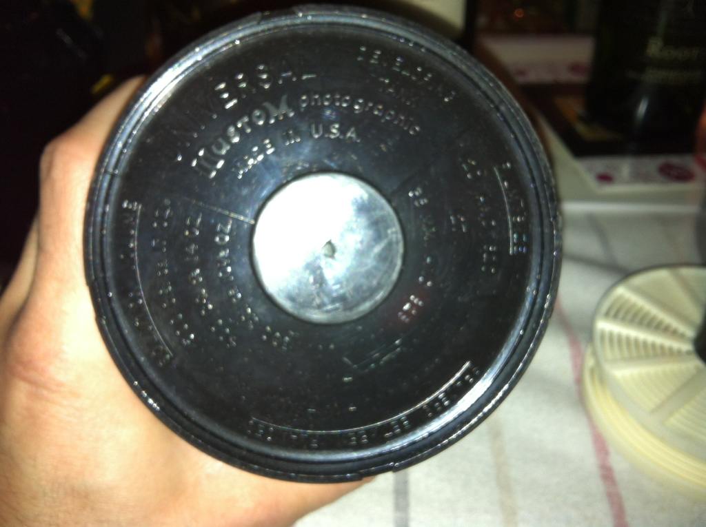

Lastly. I recently picked up an unknown, it was sort of one of those fortuitous situations where the seller had no clue but I suspected it was more adjustable than the listed sizes...
It doesn't do 116, but it does do APX/110 !!!! And IS invertible...
Never heard of the brand... "Universal Kustom Photographic" yes with a K...
I know that last one is OT but maybe they made a 116 version? It's "semi" self loading, basically you use your fingers like a ball bearing, it rotates so you can shimmy the film in... Can't wait to actually use it but I don't own a 110 camera and all APX is C-41... But it was cheap and an opportunity that doesn't come along often. I digress a lot :sad:

Stone, Thank you for details about FR and Ansco tanks. I will not worry too much about lack of modern features on old tanks and lack of liquid tightness. I do not process 70mm every day and I'm fine with ghetto method of processing film on the reel in dark in open deep dish. Hey, It's poor man dip and dunk processor!

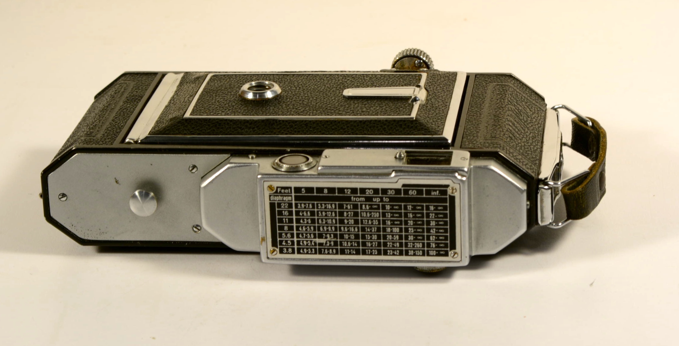

I've never even seen a 118 or 122 film size camera before... Is this one of those formats that became sheet film? I know some larger roll film was converted to sheet film because the convenience of roll film storage was outweighed by film that was too curly but they liked the size and so started making sheets for the same size. Is this the case?
I don't think they had "serious" cameras in the terms you are thinking... A Kodak folder WAS serious back then, some of them. The Autographic Folder I have for 120 and 116 is super fancy with lots of "features" like B and T and I that's 3 options! I think the instant (I) was the fanciest of the features :smile: and an f stop range from f/7.5 to f/45!!! Wow! :smile:
The fancier of the two also has 1/25 and 1/100 as a shutter speed option. This was a later model.
How we view cameras today is different than people would from back then. Owning a Kodak when they first came out was like buying a professional model Canon or Nikon for ($3,000) today's money. A lot to spend I think. It was certainly a luxury item. People weren't so entitled to have EVERYTHING as we are today because it wasn't a consumer economy until the 1950's.

Nice explanation Stone! Thank you!

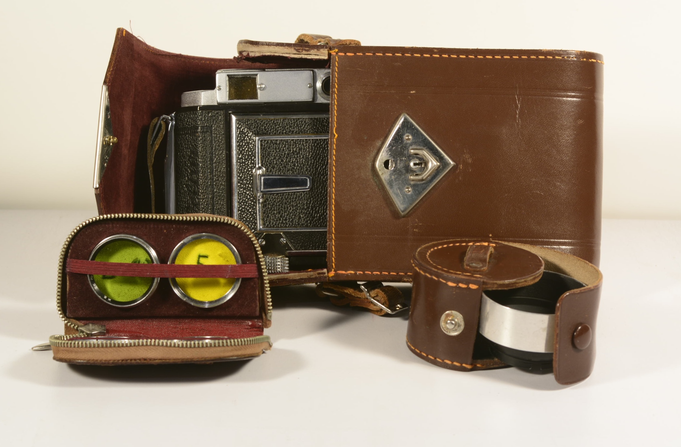

Then I already have top of the line 116 camera! I'm richer than I thought!

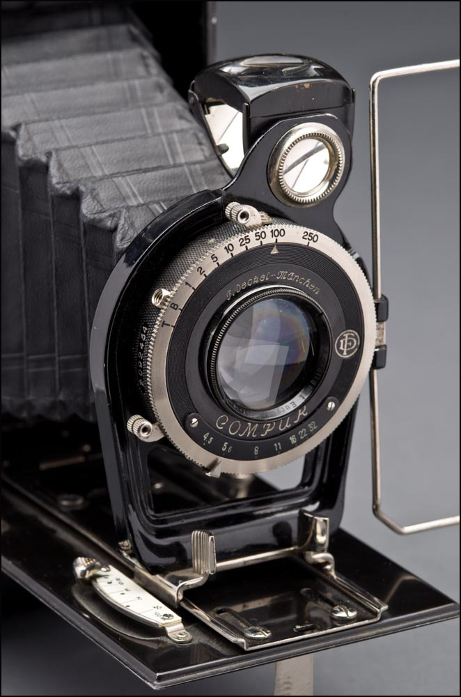

German made FD with Rodenstock lens and fancy Compur shutter.
Wow that's MUCH nicer than mine :smile: many more options and better glass, however I suspect this is from the 1930-1950's? Mine is from 1910's a lot of advancement happened with later lens designs...

Thank you Stone!
This camera must be made before or during IIWW.
We didn't have many amateur West German cameras imported in the Yugoslavia after 1945.
For official use we had lots of Leicas, Rolleiflex's, Linhofs and Arri cameras, most likely received as war reparations from Germany.
You can see some of the pictures taken with this camera on 70mm film on my Flickr.
