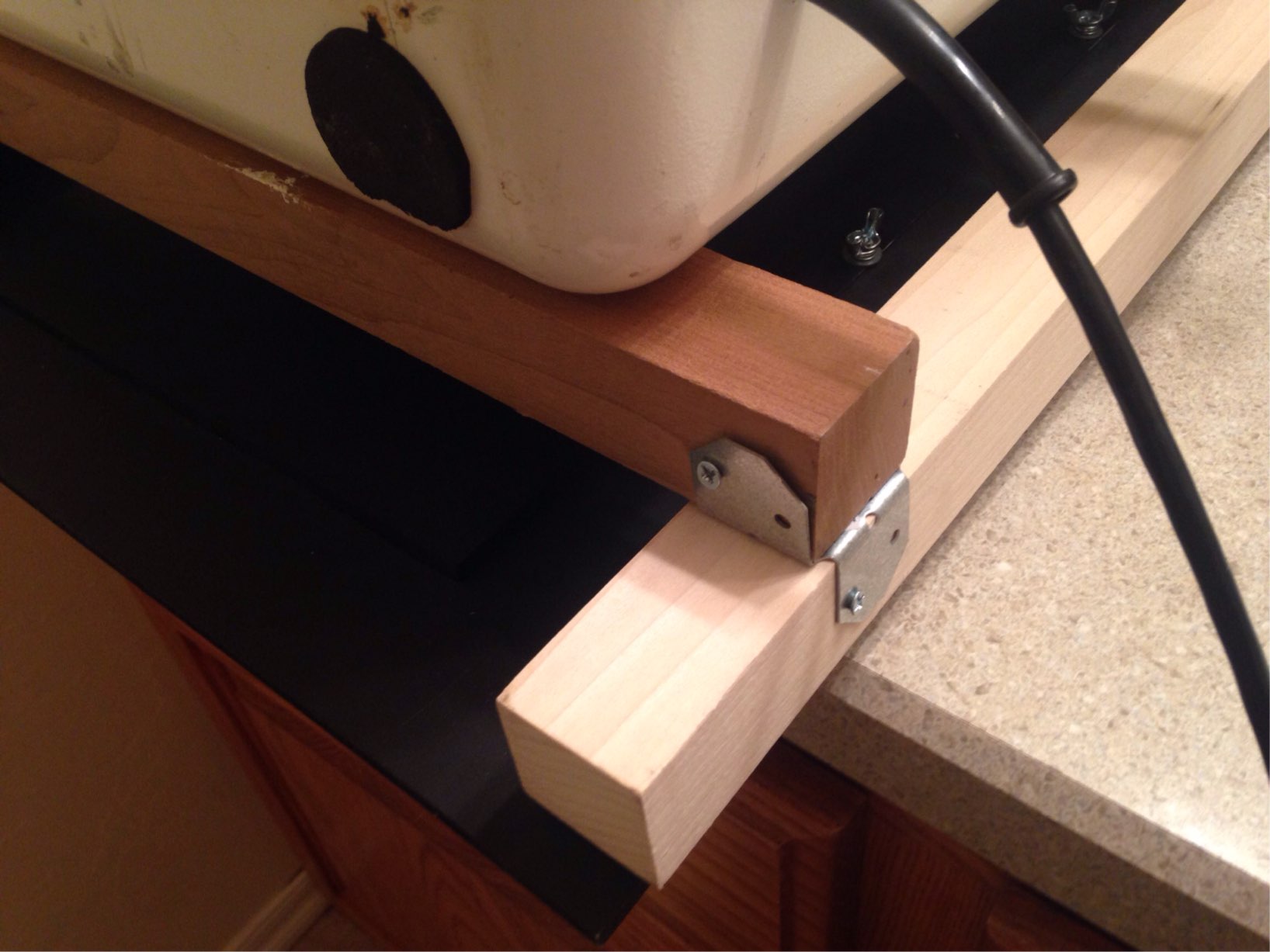

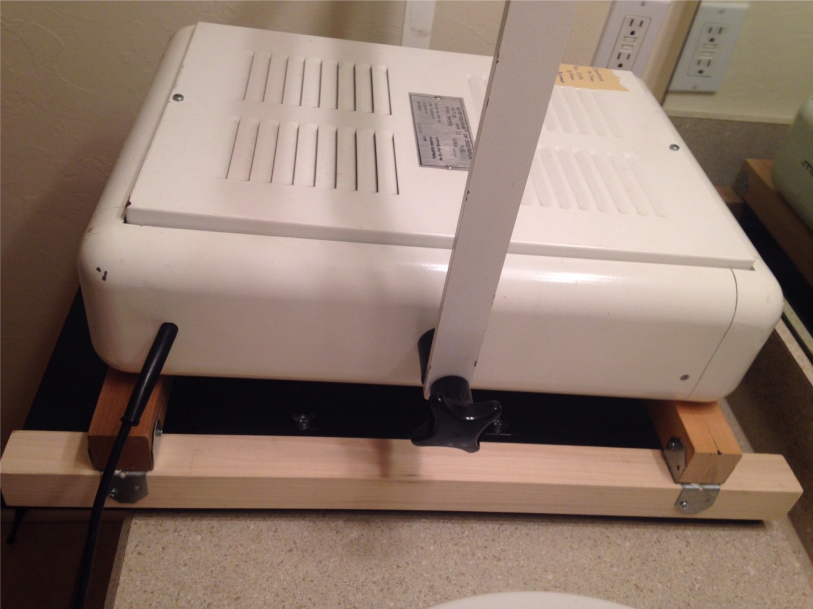

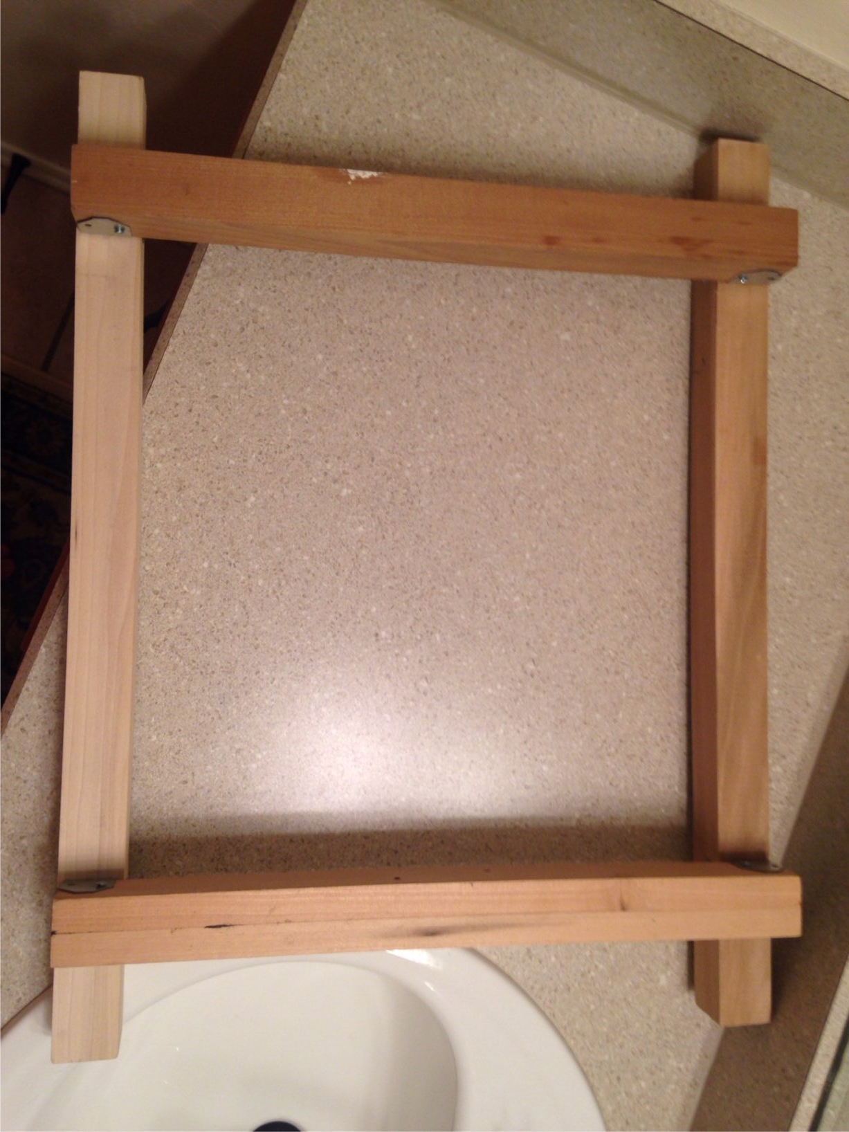

I built a frame out of 2x2 boards. It's basically just two running left to right, and two laying on top of it running up and down. It sits on the edges of my printing frame (an 11x14) and holds the lights about 4" above it. You could just lay them down or glue the boards on top of each other, but I attached them with screws and some metal brackets I found at the hardware store. I don't have a picture of it on hand, but I can take one later for you if it would help. It's all stuff you can buy at any home improvement store for a few buck and have assembled in less than an hour.

Yea a picture would be great!
jim10219
Jun 15, 2017
1,632
Oklahoma
