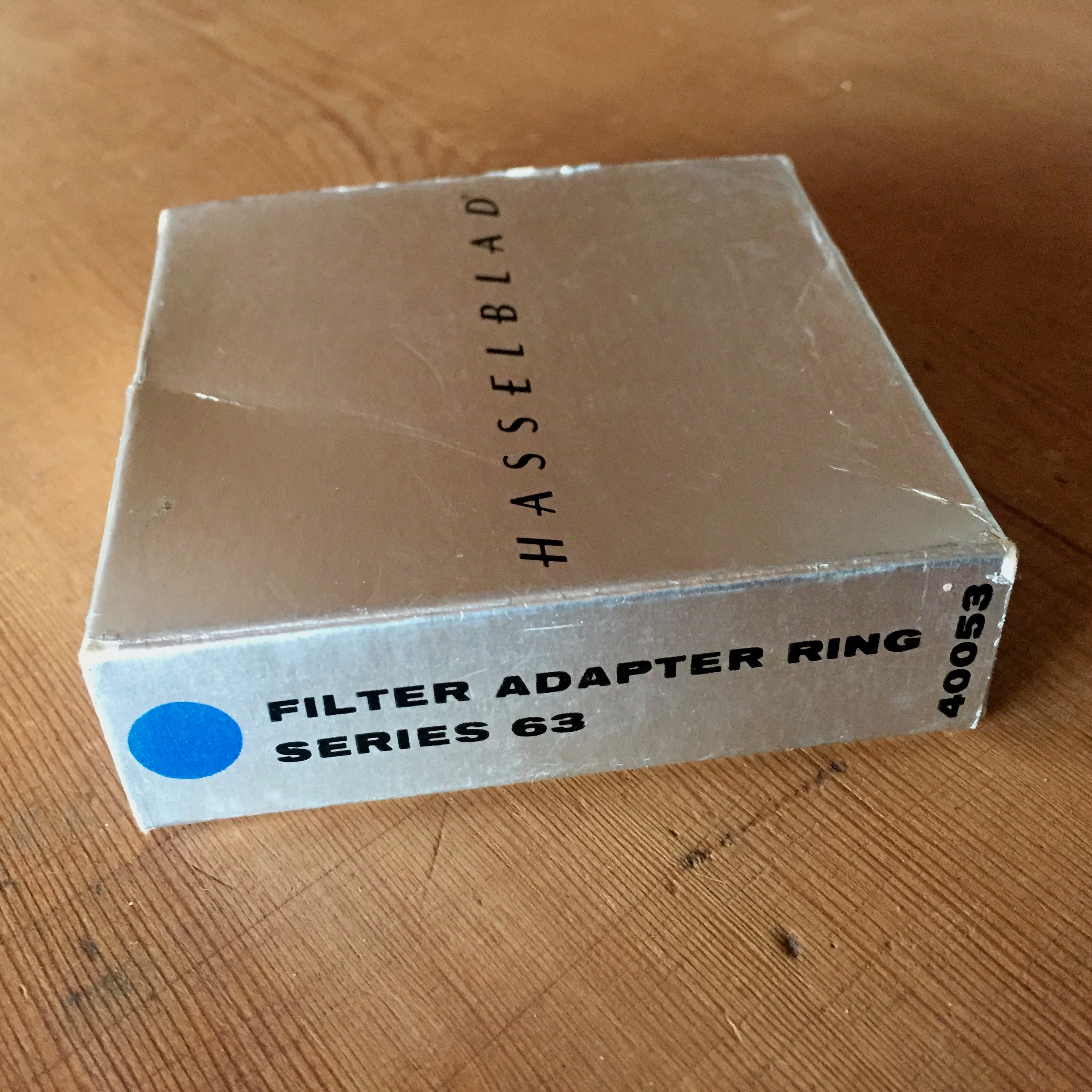

As a matter of fact, I tried that famous adapter (se photo) and it doesn't take 67 mm filters, at least the B+W ones, because the screw pitch is different.
Hasselblad appears to use different measures, so I will have to look for genuine series VIII (= series 63) for my Distagon's and Biogon, and even for the B50 lenses like the Planar and Sonnar for which there is no screw in hood that would fit that Hasselblad # 40053 adapter.

That looks like the adapter for 63mm filters.
The one you're looking for is part number 41530, the B60 to 67mm filter adapter.
Mike
I believe that B50 lenses need 63mm filters, B50 to 63mm adapter. I know that B60 lenses use 67mm filters, B60 to 67mm adapter.

Ah, sorry, got room in the corner for one more Sirius?
40053 is the correct adapter to use 63mm filters on a B50 lens.
For some reason i had latched onto the need for a B60 adapter :whistling:
