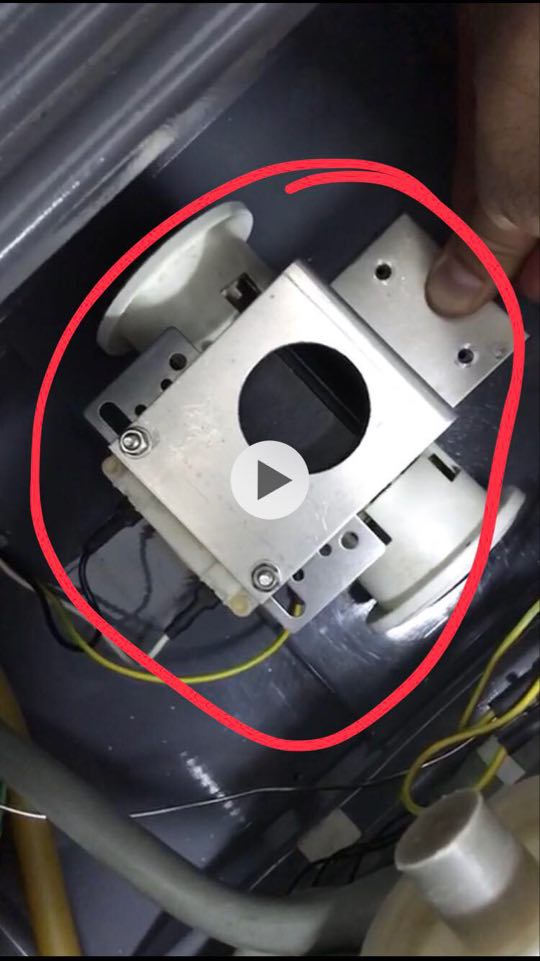

Hello Drew,
I have ACP 505 as well but I don;t have one crucial part to make it work. Could you please measure this rack for me? I need it to place pump in proper position in the machine. Let me know please so I will write you which dimensions I need. Thank you very much
