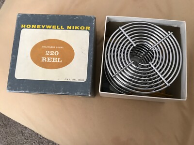

As per the title, I'm looking for at least one, preferably a few QUALITY 220 format reels.
I have a few that basically look like overgrown versions of the cheap/no name 35mm reels that quit loading properly if you look at them crosseyed(and almost none of my 220 reels load well). I'm looking for some good quality reels from one of the big name makers. I have a really strong preference for Hewes(that's all I use in 35mm) but really Nikor, Omega, or some other quality brand I may not have heard of is fine.
I'd also be interested in 120 reels from any of these brands, but am less picky about those as I've found almost all 120 reels load well...still thought I like quality darkroom stuff.
Last thing-I'd love to get one or two 116(70mm) reels. I've recently gotten into shooting 70mm. I have the big Mercury works modified Patterson tank with a 70mm X-ray reel, but sometimes I want to develop short lengths and not use all the chemistry the big tank takes. A 116 reel would be perfect for that, but i don't have one...

I bought the linked above 220 Nikkor reel, and I'll keep my eyes open for other.

As a note, the Nikkor reels will not fit in a standard size steel tank. The might fit in the Mercury Works tank but they will definitely rattle around a bit. I don’t know if that was pointed out or not.
I do have 1 or 2 220 Hewes reels I might be willing to part with, I have 4 and I want to keep at least 2. They fit in the standard size 16 oz tank. I hate loading 220 on Patterson reels, film always stops advancing easily after a bit and forcing it makes it go crunch! The steel reels load like butter, wonderful pieces of kit. Let me know if you’re interested in them!
