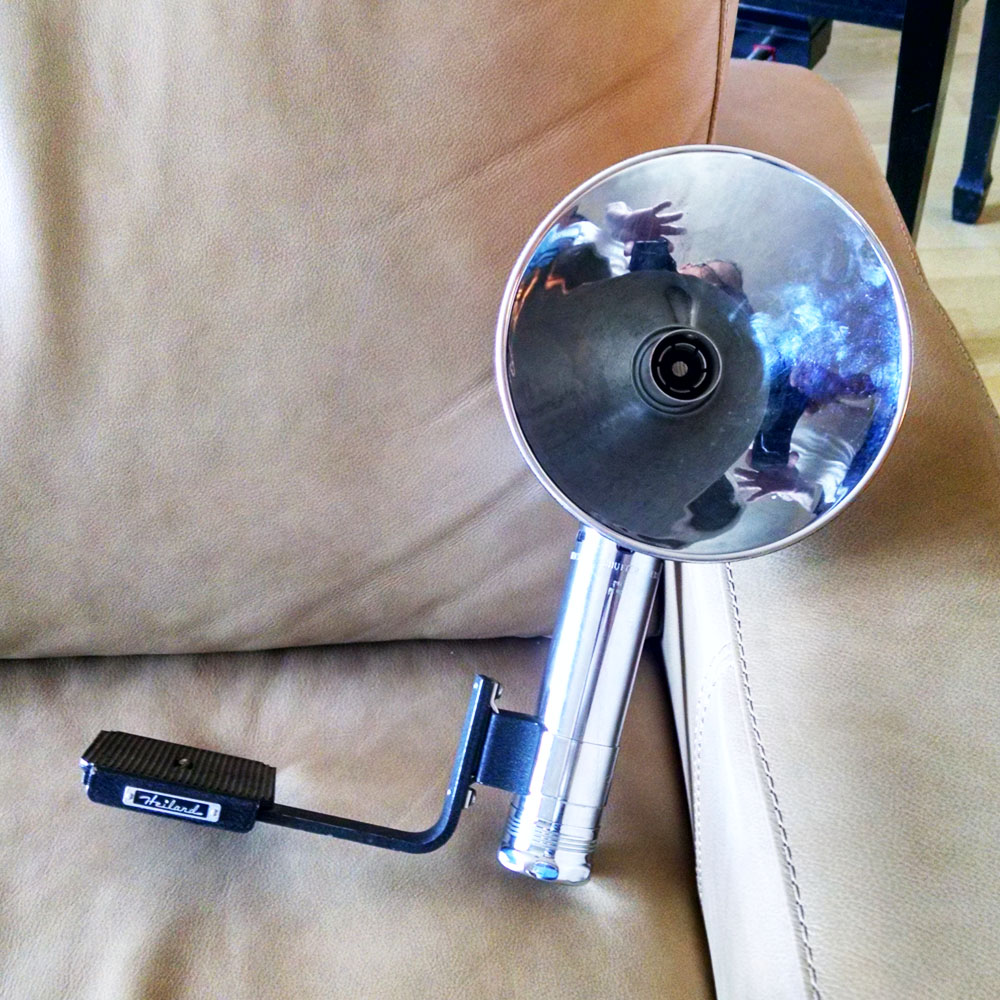

There's this guy. Uses Press 25 bulbs. D cells seem to fit, but haven't tested.
